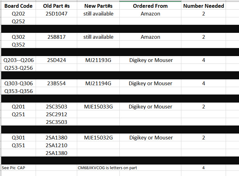

Read some other threads and I have decided to replace the parts in this shopping list. Please check my math on this but I thought others might find useful. Remember I'm a real newbie on electronics.

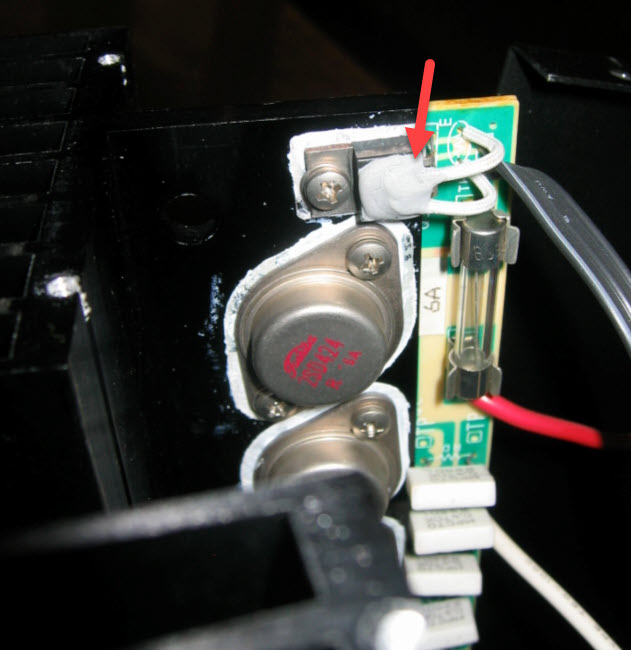

I the other picture there is a gray colored glue (I think) covering the transistor. What is that? What will I find under this glue? Is there some type of a connection the wires attached to?
