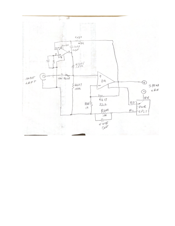

I'm posting a very simplified schematic of the left channel to make discussion a bit easier. I'll touch on a few details and we can proceed from there.
I've depicted the power amp as an opamp; its AC gain from its + input to output is 1+R613/R611, = +23.2 V/V or about 27.3dB. You noted that R609 appears in the path to ground; I believe its purpose is to the control the path of ground currents back to the power supply. I believe an ohmmeter test will show 100 Ohms from negative speaker terminal to the shell of the input jack, and that a check of DCV across R609 will show virtually 0mV. If this is the case, it's behaving correctly.
An experiment, "thought" or actually tried: assume the servo opamp is absent or that R605 is opened. Q601 base bias current will flow through R607 and cause a few hundred negative mV to appear at the PA + input. The amp's gain of 23.2 will amplify the bias voltage and is probably the cause of the -1.79V you observed at the + speaker terminal. Then in a subsequent experiment, you shorted Q601 base to ground (making bias resistance 0 rather than 100K), and saw the output rise to +70.2mV. This all seems reasonable.
Next, we should connect R605 to +12V. The expectation is that the PA + input rises and the amp output should rise to positive several volts. What voltages do appear at + input and at output? This feature has to behave as described for the servo to work when it's connected.
Apologies for image--- I'm inept with image creation.

Typo. That should have been "There should be no drop across those 100 resistors." I'm sorry I missed that. My sketch is also incorrect, as the opamp negative supply comes from E3, not E1. So the 100 ohm resistor carries only bias currents to R605, R607, Q601, and the opamp + input; these should total only a few uA.
So I have no idea why the bias voltage at Q601base is so large. Could R607 be open? Could Beta of Q601 be degraded? And there's similar symptoms in both channels that might be related. Do both channels present the correct AC gain from input to PA out?

I think I advocate lifting one end of R605. Then the only path for Q601 base current should be through R607. That should tell something about actual base current. With power off, resistance of R607 should be apparent.
My discussions of current flow in the 100 ohm have been neglecting current flow through R611, so voltage drops across R611 and R609 deserve scrutiny--- my error/oversight. Presence of R609 does seem odd. C605 (1uF) will carry AC currents, but it might be interesting to short R609 as an experiment.
P.S. I don't believe R609 has any relevance to servo/offset error issues, though.
