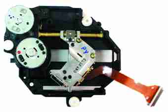

Technics/Panasonic CD mechanism RAE0113Z
From this devices there are a still wide range of suppliers on the web, but when I will order this, I get the message "no longer available"
by this supplier I haven't try this:
Electronic parts market
Therefore I must go another way for replace the laser mechanism by the ACD-11 (ACD11) from Acurus (same laser head model).
I have check out other models with the same mechanism:
1) California Audio Labs Delta transport
2) Adcom GCD-750 (GCD750)
3) TECHNICS SL-PD867 (CD-Changer)
found about
audio-technics lasery w sprzêcie
currently auction:
GittiGidiyor - ?kinci el ve s?f?r elektronikler, bilgisayarlar, koleksiyonlar & fazlas? en ucuz fiyatlarla burada, (Turkey) check item number 22582539
Only the last model is cheap enough for changing the optical pickup. Because this isn't a laser from the SONY KSS-series, the probability of getting defective laser tube is very low. Perhaps the differences to other "RAE" mechanism are not by the optical pick up itself (must been checking). In this case more Technics modells are to use for laser head spender.
If your disc motor not faulty, change only the optical pickup and not the complete mechanism.
