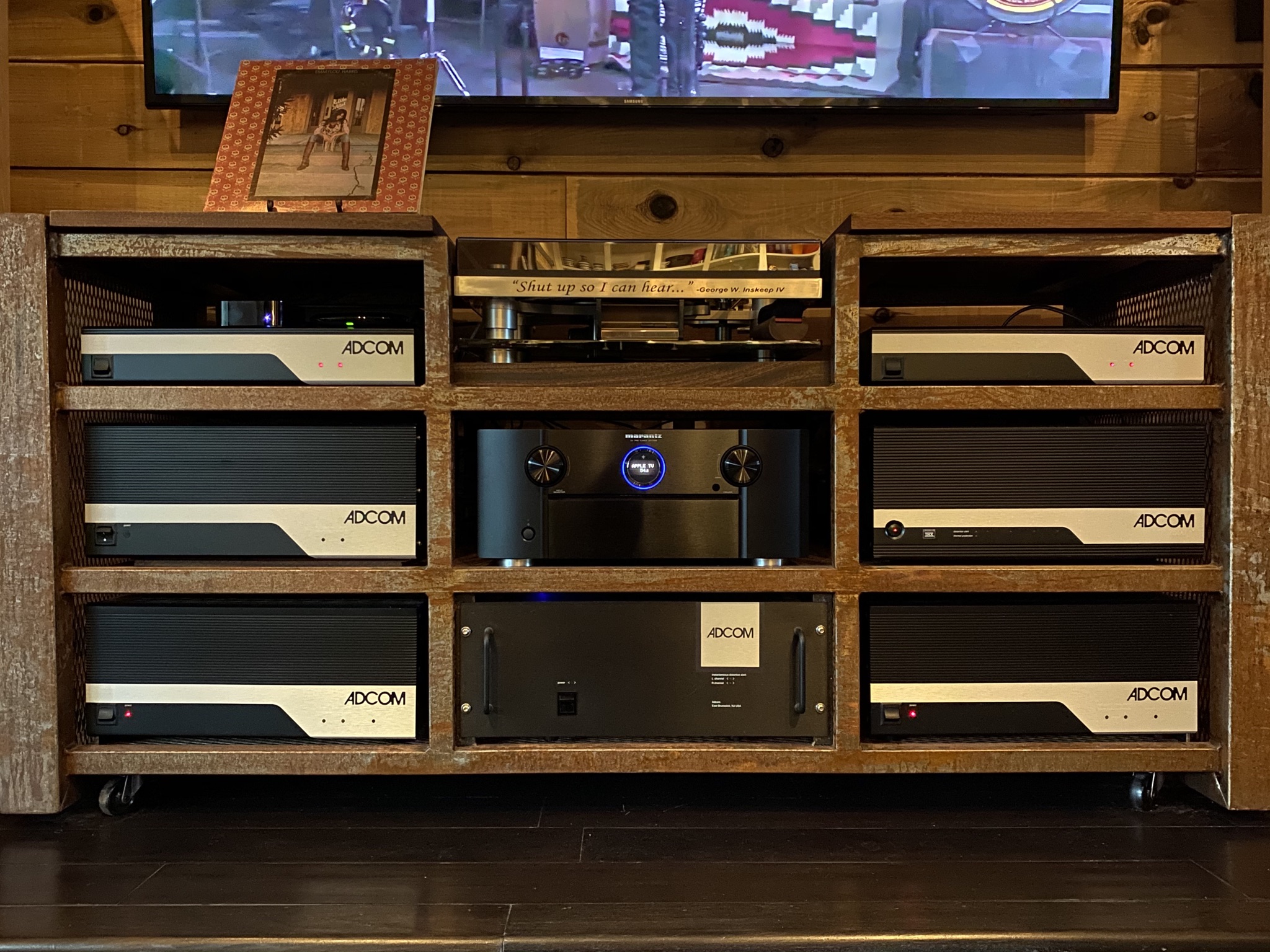

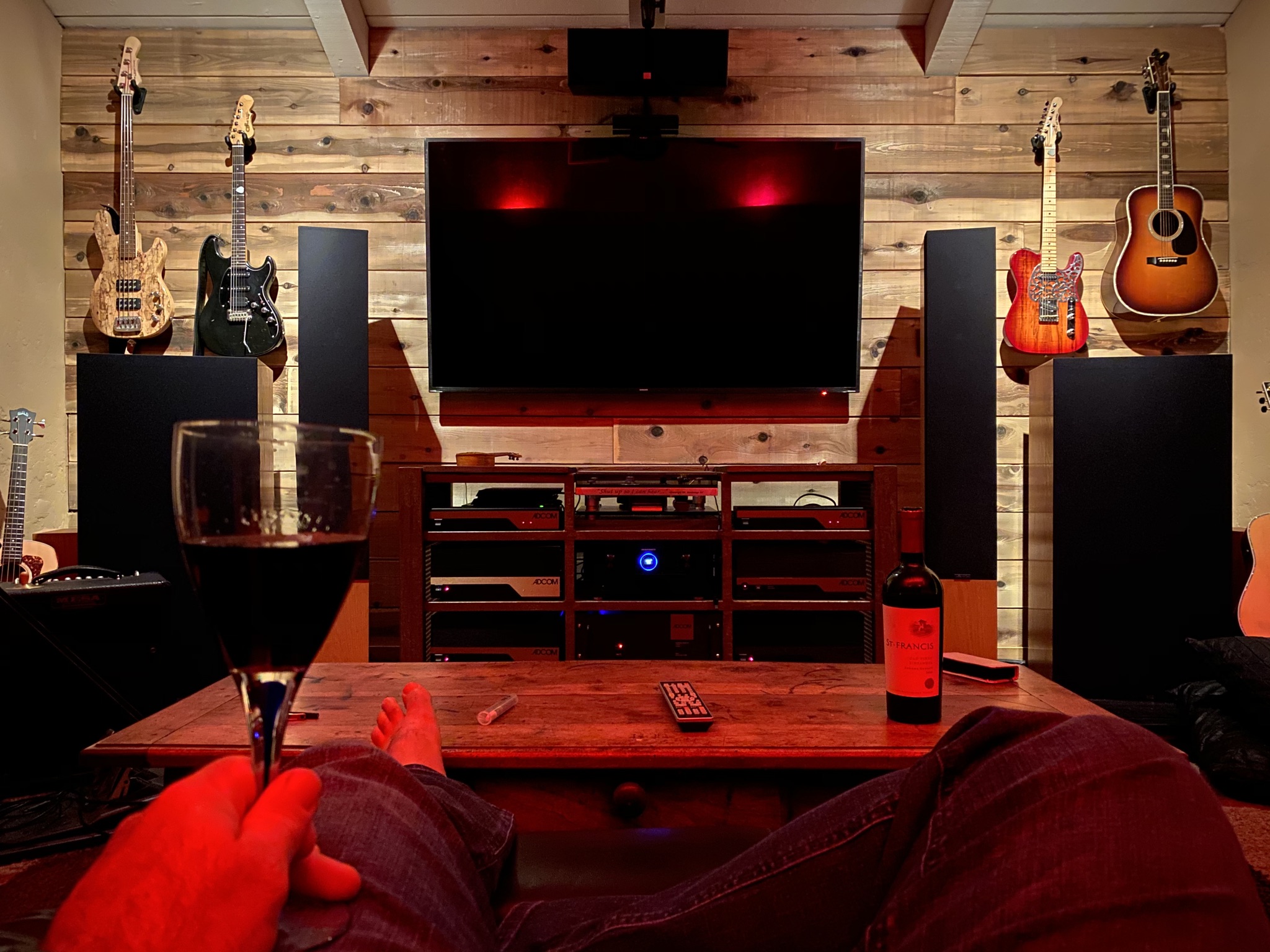

I think getting more is a great idea… 😉
Running 4, Two OG’s and two MKII’s, plus a 5 channel for surround. All 4 555’s are running bridged mono to the Snell A V reference speakers. One to the sub and one to the tower of each stereo channel.

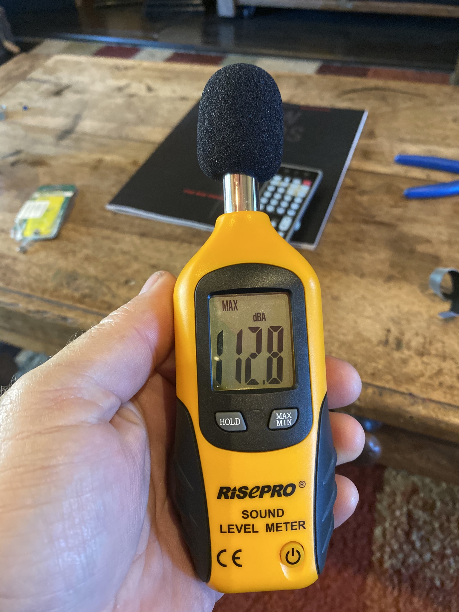

It’s the first/only HiFi system I’ve ever played guitar at stage volume with that can hang. It sounds actually live. Like, you can play an actual tambourine in the room and it is indistinguishable from the track. The intensity it through the roof.
