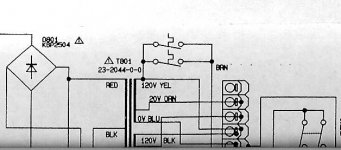

computeruser said:12 ohm 1/2W are the closest I have and they are now in. I see a reference in the service manual to an optional fan. Usually one
can tell where a fan would be mounted but on this amp I have no idea where it would go. Does anyone know?

Nope never saw a fan installed in a 555ii, can't even see where it would fit, Chris have you?
Hi K-amps.
The special order amp. Often looked at them and wondered. Never saw one installed. I understand they were a kit to make your Adcom into a vacuum cleaner (bagless).
I don't believe they would be of any use in a normal situation. Then there is the fan noise. Unpopular with the audio crowd for this reason.
-Chris
