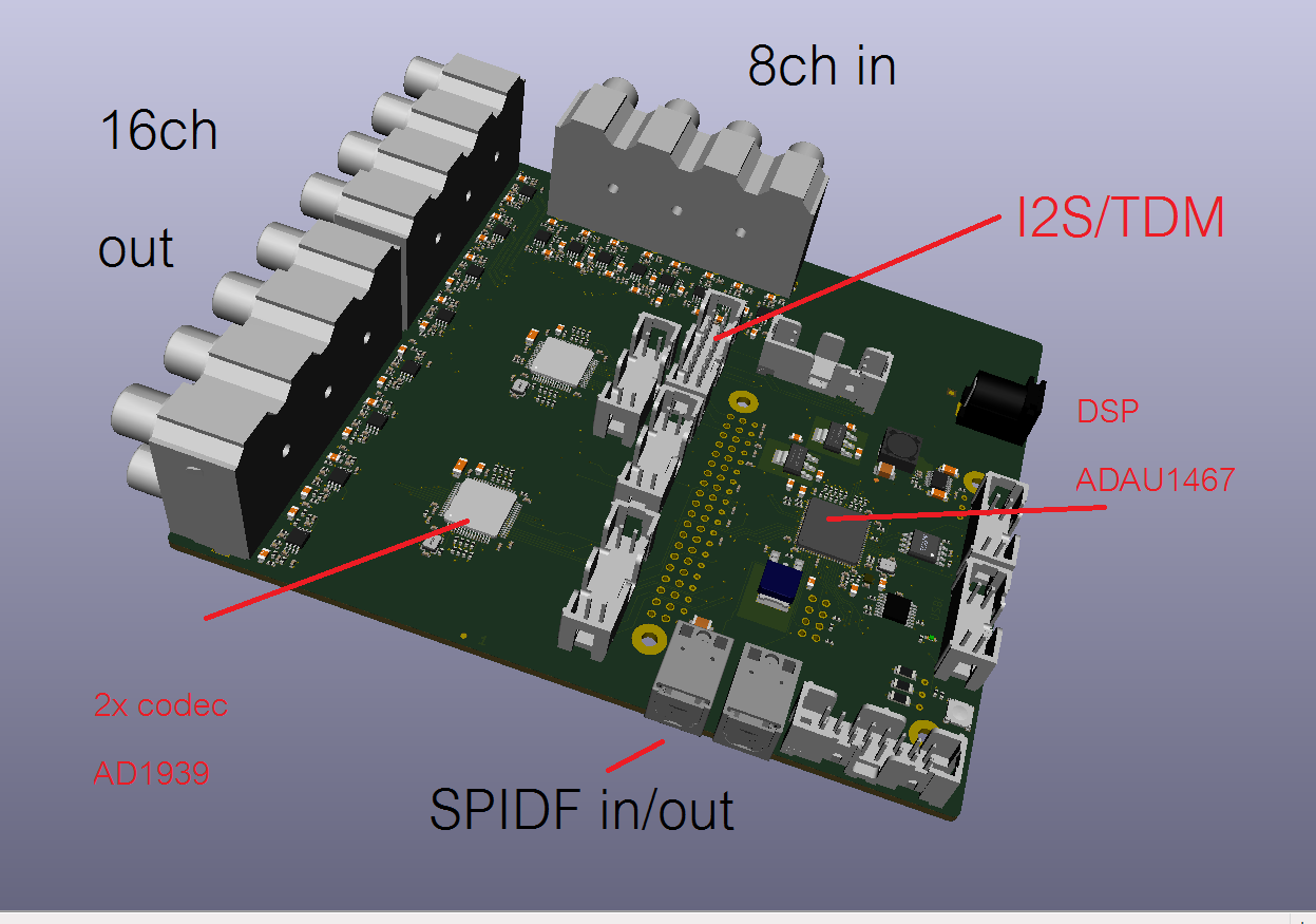

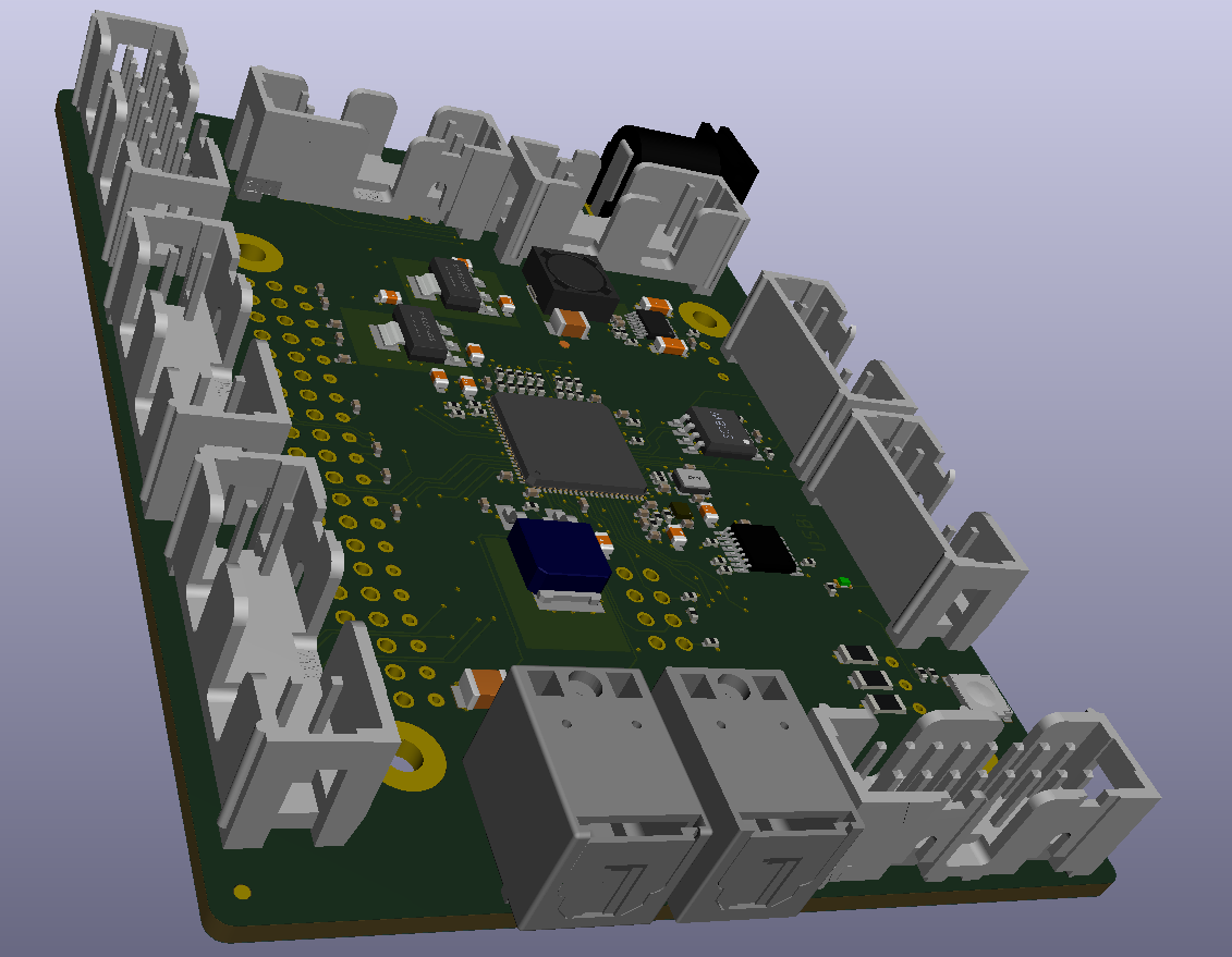

I have ADAU1467 eval board and I have also now designed my own board in kicad.
8 ch in, 16 ch out
spidf, bluetooth 5.0 module -> i2S
Raspberry interface as optional use, etc
see attached pics

Very nice! Are you considering making some group buy or?
Not sure exactly what you mean.
I have pick and place machine and can manufacture thoose boards myself.
But maybe you refer to sell them?
If anyone wants them they are for sale.
Not my original plan, but sharing is a necessity especially to share the sw effort with the community.
Due to vacation no assembled pcba to be expected before late August.
And normally it's always a risk for something to be fixed in a completely new design.
I am very certain there is a lot of people that would be interested.
You should at the very least consider costs and what you would sell it for, most of us do not have access to automated production equipment.
Not many DSP setups that can do 8 channels x 2 way speakers.
And there is also a shortage of more than 4x out DSP kits to work with the Raspberry.
No worries about the time aspect, most here do other stuff in the summer.
Ok.
Cost is a bit unclear but components alone probably mounts up to $100 range.
Also the wish list from the community is unclear.
I was now planning on adding MM/MC input as well.
Already is optiken to mount Bluetooth module.
What I want to follow up with later is class D amplifiers fed directly over I2S/TDM
Thats my goal to go digital all the way to the speaker element.
And have all elements individually boxed.
I would like to get out of the composite speaker mentality and into the single element mindset.
Updates will follow.

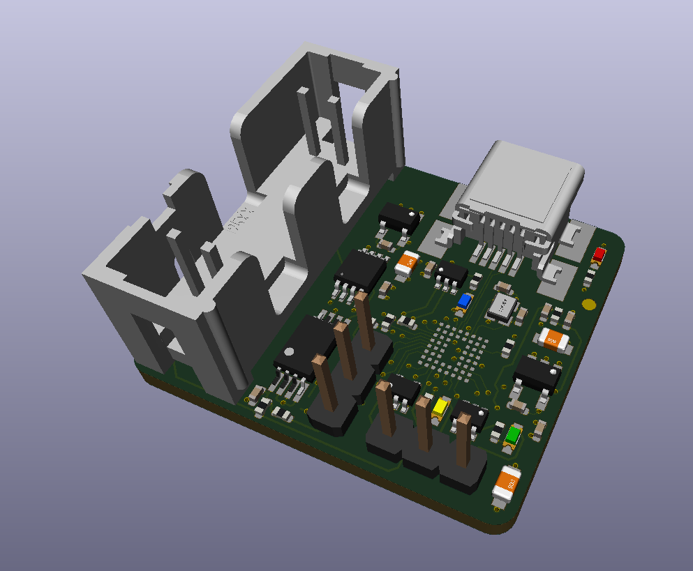

I am doing the USB to SPI interface now as that was fairly costly from analog device as an eval board.
Option to run both RPI3 as master or the PC
RPI3 can still control the codecs even in the case that PC control the DSP.
Selectable trough switches.
I also wonder how I can measure the THD and everything to make sure it really delivers top quality.
I do not know whether this translates to any new functionality or not.
But thank you :)
