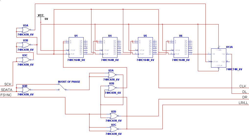

Even better universal shifter. Just what I had in mind. Tested this one in MultiSim, it's 100% working. This can be used interfacing 1865 to any form of I2S, as well as aligning data from 8414. One just needs to figure out required amounts of data shifting, which depends entirely on source I2S format.

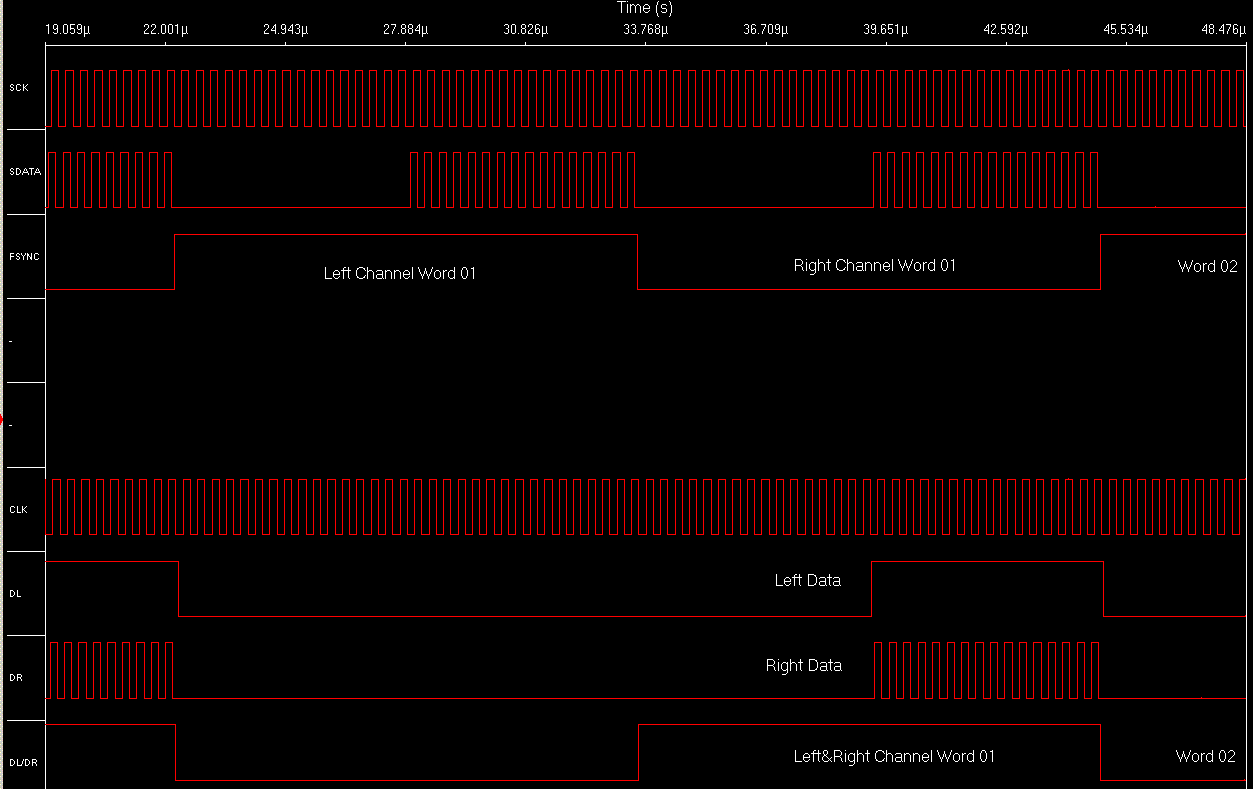

Had some spare time to play with MultiSim again. Found couple mistakes I made. First - shifting must be done for Left channel data, as it comes first in a sample, otherwise you are shifting Right channel data to other sample and in the end, have the same output delay between channels. Second - HC74 or similar flip flop must be added, to shift another 0.5 sck (thanks for the link Josiphal). This is because data is clocked from 8414 on the falling edge of sck, and HC164 locks it on rising edge of sck.
Below I will attach schematic and timing diagram for proper 8414 and 1865 interfacing. This is just my approach, could be done in a few other ways. Couple notes on this one: U2A, U2B, U2D separates data, U2C inverts latch signal. U3B, U3C 2X delays clock, as data is also 2x (or 3x if in out phase) delayed, to keep the sync. With 4XHC164 + HC74 Left data is ~39ns out of sync according to multisim. Everything else is already discussed. Again, I personally would use ALS logic, just to be on the safe side ;)
Looked at RocknaDAC interface schematics, maybe more elegant solution using RST for data separation, but this is using 9 IC's in total :eek:
