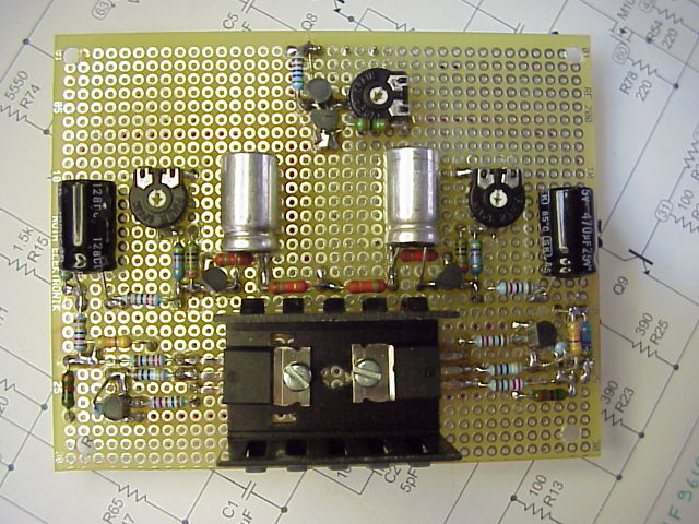

I bought some PCB's in the last group buy, (No, I won't sell them :) ) but this is how I started:
It's real cheap, very funny to do and has good results.
/Hugo :)
