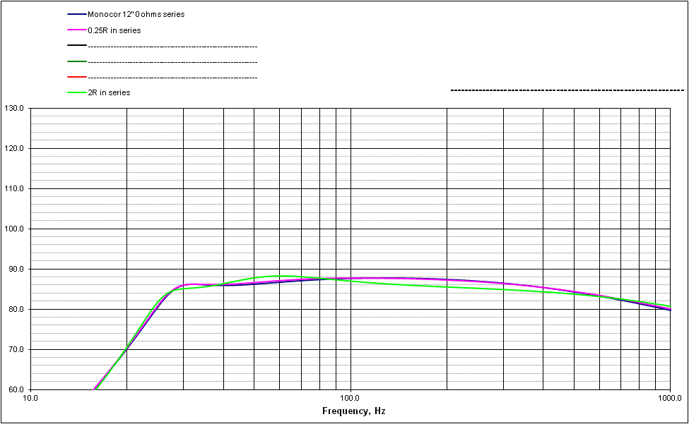

The other missing bit is sensitivity analysis (in the sense of sensitivity of frequency response to tolerances). The change of frequency response with variations in series R is actually surprisingly small, often swamped by driver to driver tolerances or change in driver parameters with room temperature.
Pick a driver, determine a box for some alignment, then add a few tenths of an ohm to the DCR. What happens? Compare it to small (10%) variations in Qms, fs, or Vas. My guess is that most people who fret about this haven't actually measured or even simmed these effects.

OK SY, here you are. A Monocor 12" woofer in a 55L BR box with 0R, 0.25R and 2R in series. I'll let the gentle readers decide.

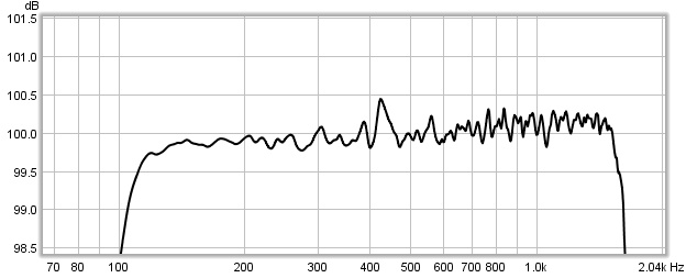

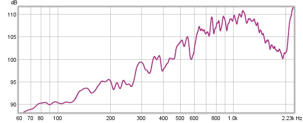

Current drive, voltage drive, it really doesn't matter; the driver's real drive requirements can be measured and matched, whether or not the driver is in a big box, little box or no box at all.
This makes it possible to take a speaker with a response like this:
and turn it into a speaker with response like this:
From this vantage point it is rationally possible to measure and observe what happens when multiple drivers are networked together with resistors, capacitors, and inductors. Good results are possible, but these components mostly just get in my way when used in this fashion.

CAD modeled freq response tells you nothing of the control the amp has to start and stop the cone motion.
Actually, that's exactly what it tells you- the amp can be modeled as a source impedance and variations in it examined (as Pano just showed dramatically). When you compare CAD versus measurement in the bass with real speakers and real amps, it's stunningly accurate.

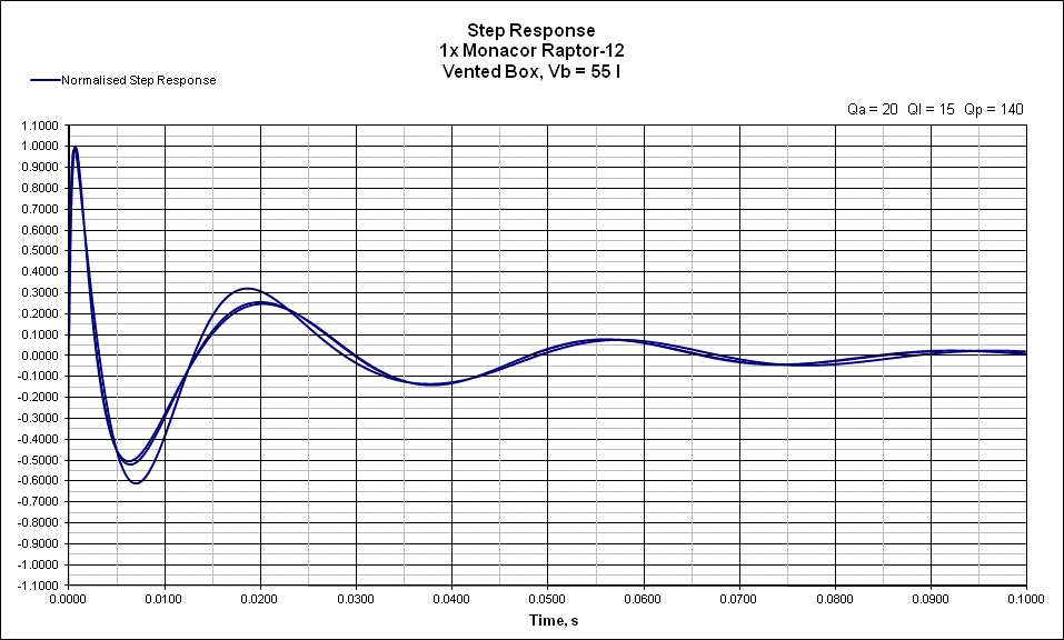

Administrator
Joined 2004
It does tell you a lot, as SY has mentioned. It's not perfect, but pretty good.
Below is the simulated step response of the same box and driver with the same series R 0R, 0.2R and 2R. You can see that there is about 1dB more overshoot with the 2 Ohm source impedance.
I can do some actual measurements if you like, or you can do them yourself.
No argument that lower output impedance can sound different than high, but it's nice to know why.
