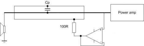

o.k. - so far i have found that i need unity gain opamp that be stable at unity gains, that will have reasonable slew rate and that will be able to work on high input voltages (up to +/-40 or 50V)
the schematic is attached...
can anybody help me with the opamp....
it needs to withstand the voltage at the output of the power amplifier (lets say that amplifier is arround 50-70W), it needs to be unity gain stable and also have rail-to-rail input/output topology or at least common mode input voltage range and output swing in the voltage range of the signal from the output of the power amp.....
I cannot see how you can remove the capacitance.
I probably oversimplify things here. But you can only lower the capacitance, and when you do you increase inductance.

www.iop.org/EJ/article/0957-0233/17/11/004/mst6_11_004.pdf
phn - look at this link above....this is how they do it with instrumentation....the problem is that i have higher input signal in loudspeaker cables....
that is why i need that partucular opamp (discrete or integrated doesn't matter).....
the capacitance of the cable is still there - you can't remove it physically doing this way but at least you do not have the voltage to charge that capacitor....
the use it in signal trasmission and in measuring eqipment - i want to use the same principle in speaker cables and in interconnect cables....
i need suggestions what to do with that opamp i need - for interconnect cables it is simple - but for the speaker cables i need opamp that can work with +/-50V input signal for my power amplifier.....

"Power chips" like the LM3886 easily handle +/-50V.

LM3886 can handle +/-50V at the input....i will see that in datasheets....if this is true and if they are unity gain stable than i have solved my problem..
