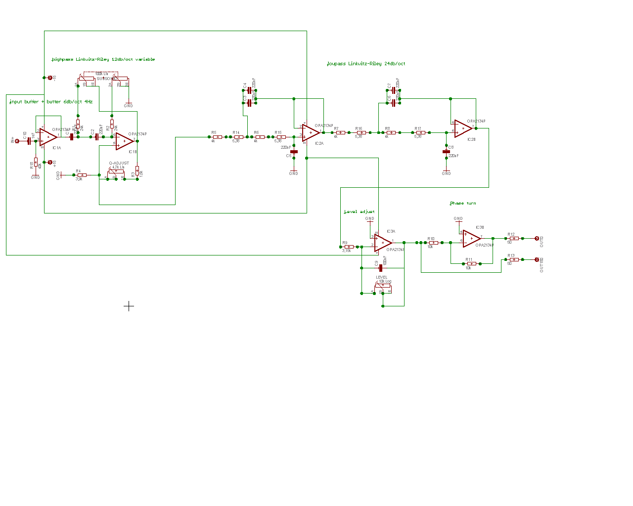

Now they are as close as i can put them.
Allso made CB more clear.
Does it look good now?
Thats better. I dont know if it is correct or not, but when you start at the lower let corner of the lay out (last post). There are 3 'large' holes above each other. If you start halfway the lowest 2 and you move to the right, you reach another 'large' hole. Just to the right of that there is a copper track (nearly) touching an copper island. It seems this is not supposed to be, but you might not be able to etch (how do you spell that??) that fine, so try to move it away a bit if you can or make sure ther is no shortcircuit after finishing the board.
One last point: there are a few corners where you have angles smaller than 90 degrees, try to prevent that, you might get sparks and burn you're board.
Besides that, I have no comment, it looks ok to me.
Greetz Mark
