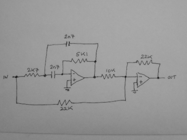

All pass using circuit of Steffen
Today I figured out the design for the second order all pass (delay) filter based on the circuit of Steffen. This circuit has the main advantage that it has 0dB of gain or loss for all frequencies, regardless of the delay. This overcomes a major issue with some other all-pass circuit topologies, that can have 10dB or more of loss, and so have to be followed with a big gain stage.
The circuit design is actually pretty simple, once you figure it out. There are only seven components and an op amp. The circuit can be built on my Universal Filter board.

ok, thanks.
I will stick with the attached topology, for now.
Regarding this shown topology, does it need a HF stability cap, as per the 1st order allpass? (and where is its placement)
With the values shown, how is the input impedance calculated?
Thanks.
Henry8,
Jeff Macaulay uses this scheme for an equalised subwoofer in "Feel the bass", Electronics World+Wireless World, August 1995, pages 636-640, the second op-amp having a capacitor across the feedback resistor to make it an integrator. Some details for calculation are provided. PM me with your email to get the article.
