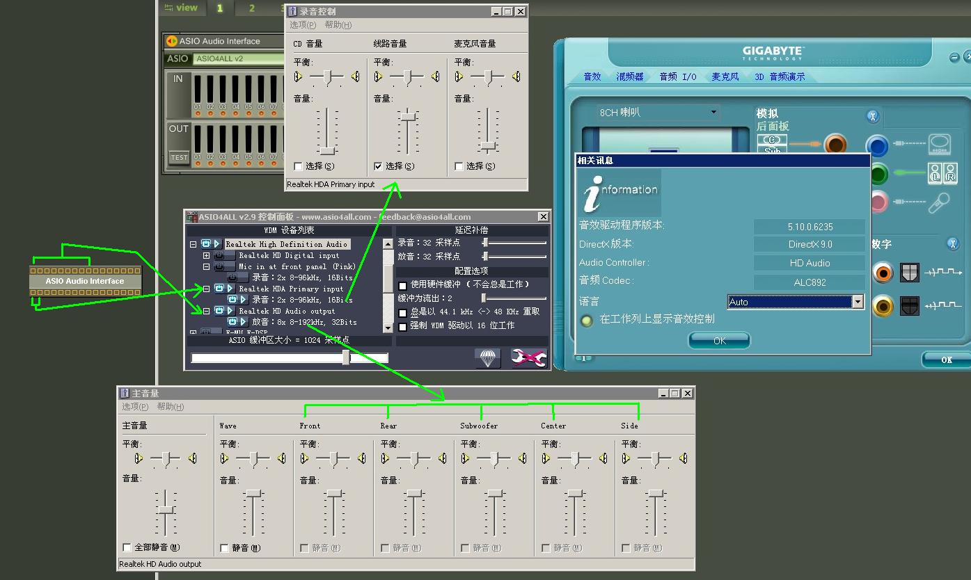

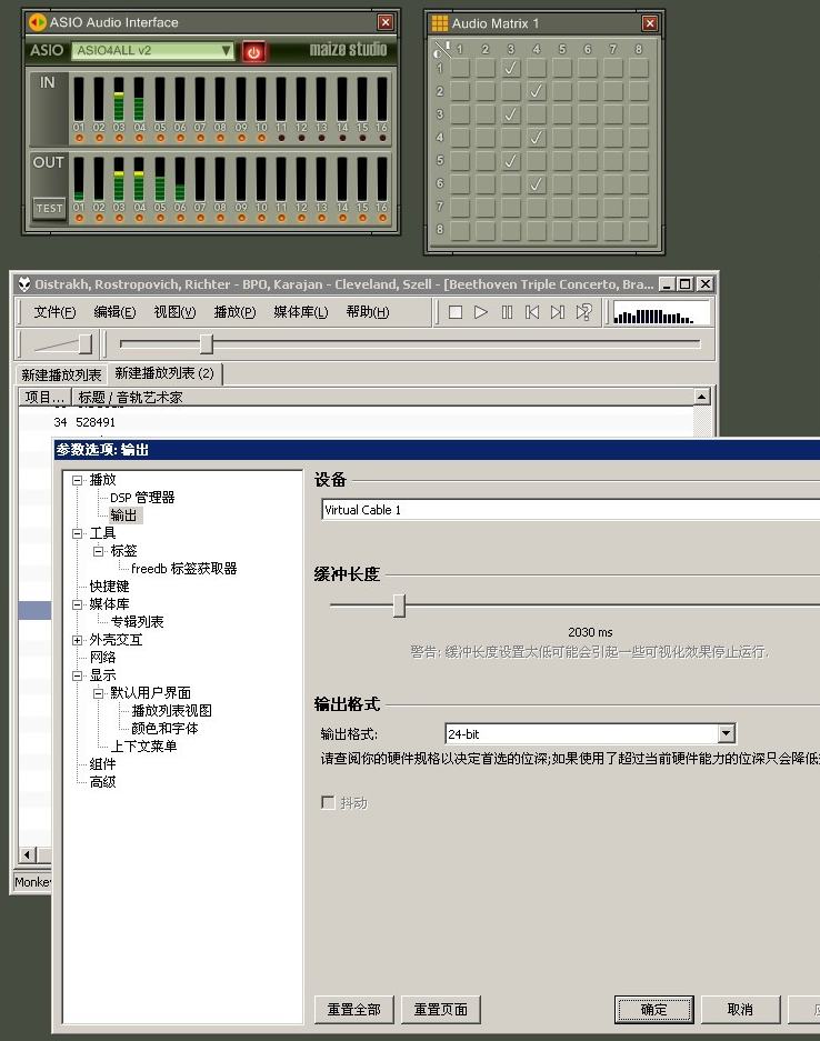

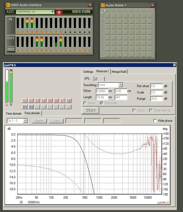

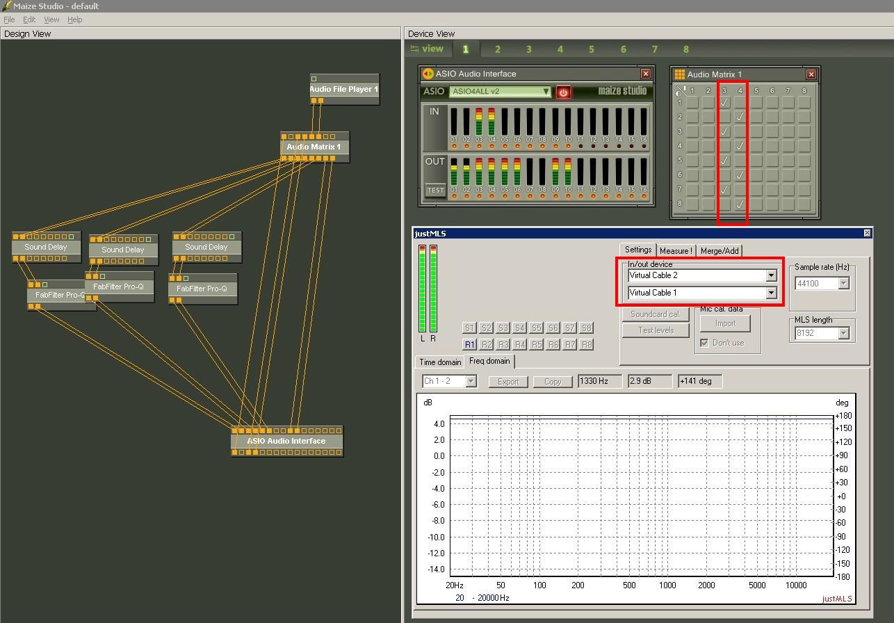

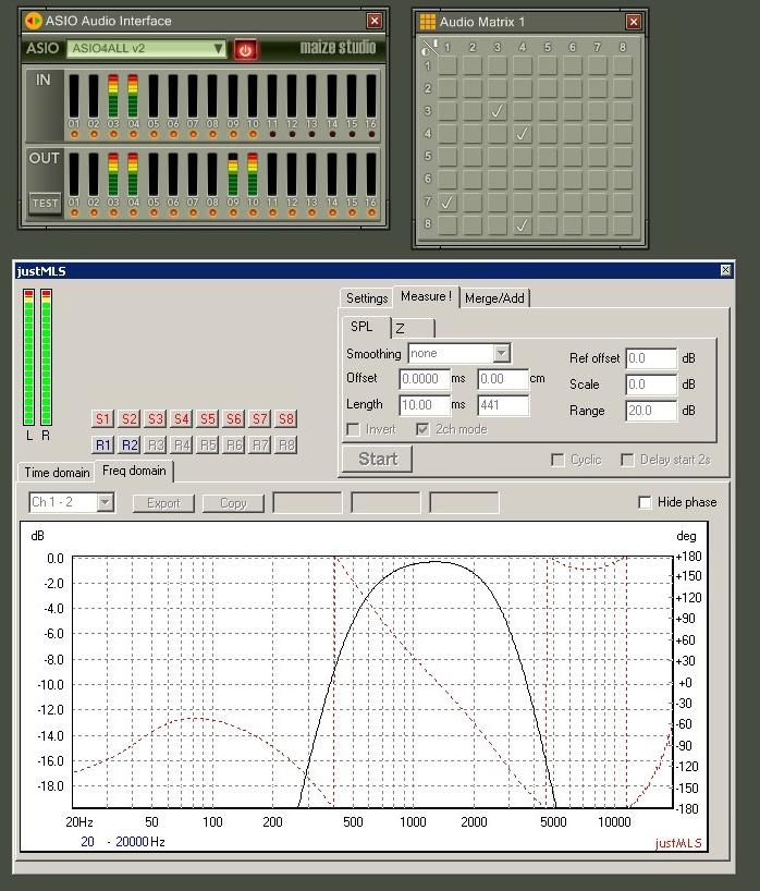

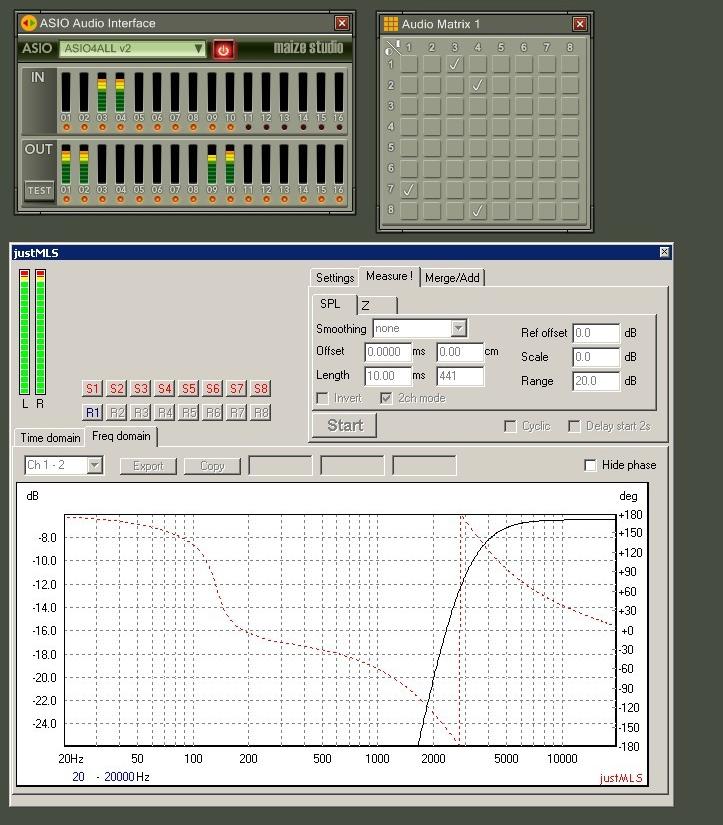

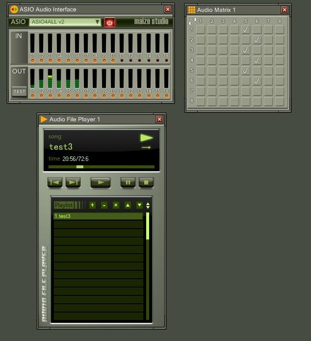

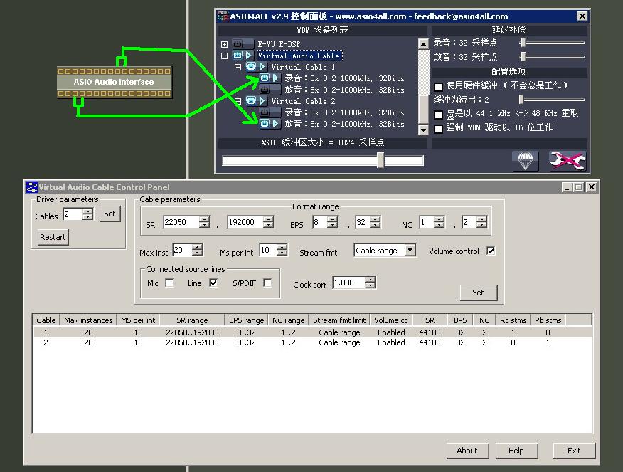

PC active crossover :
Realtek HD audio(ALC892)
Virtual Audio Cable
ASIO4ALL
Maize Studio玉米
FabFilter Pro-Q
Sound Delay
JustLMS
