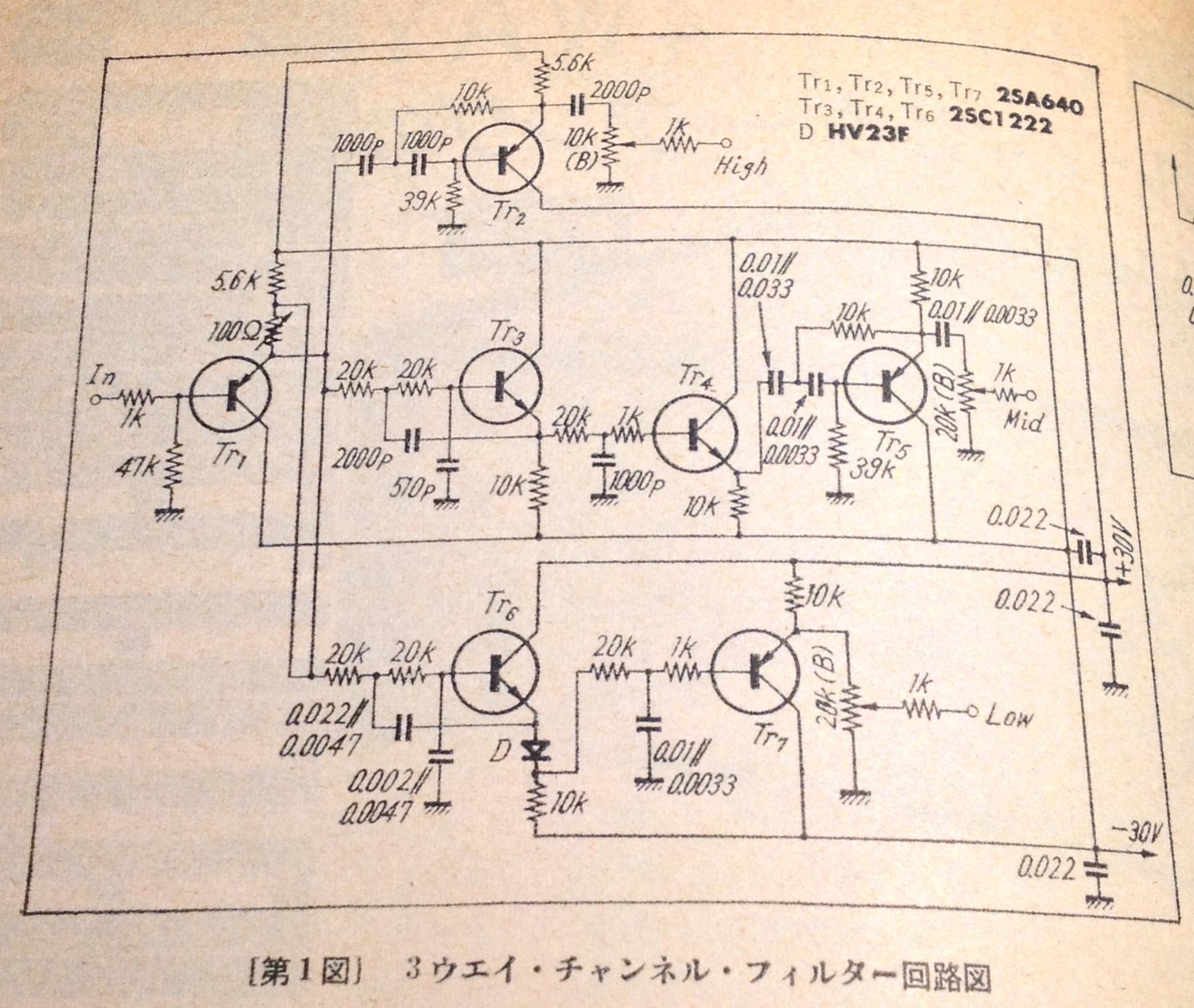

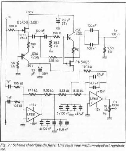

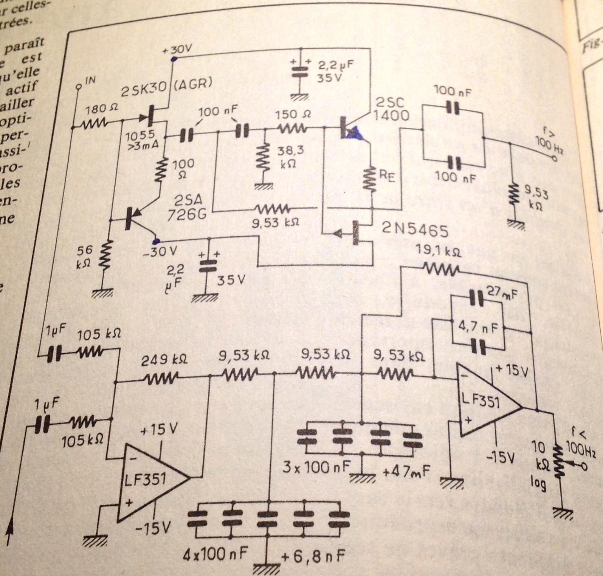

Anybody built this active crossover? I like the elegant high pass, so I am tempted to try. I may not have exact transistors though.

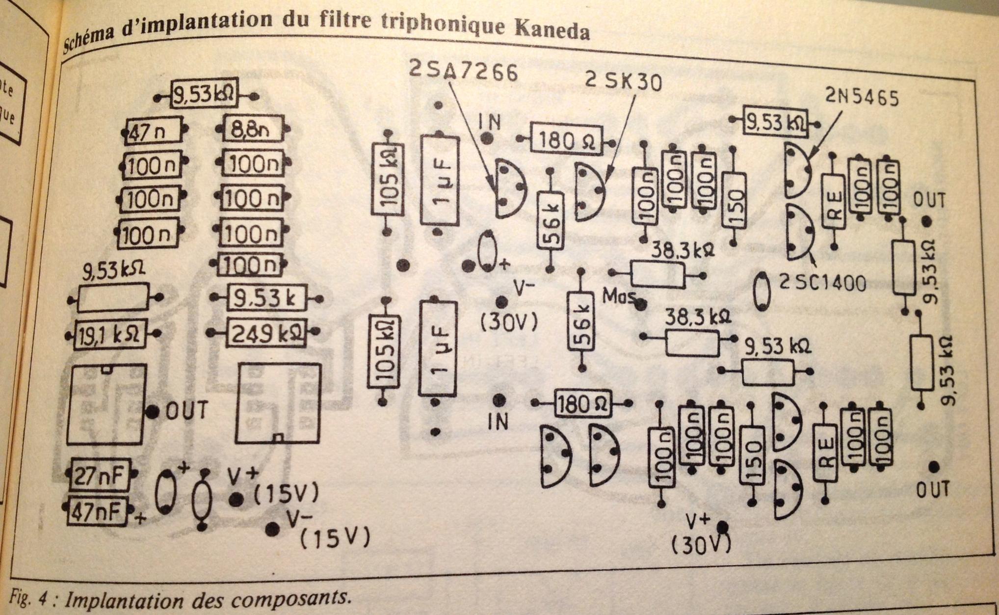

Yes, i plan to verify and recalculate critical cap values, since i plan to use ~150Hz crossover frequency. I will measure exact fr response.
I have few questions about jfets. I do not have K30 or N5465. However, i do have some others. Nelson, please take a look and let me know if any of these could be used.
J103/K246 matched pairs, i got few
Mpf102 got plenty
N4392 few left
N5460/N5457 matched pairs quite a few
Your help if much appreciated.

I ran some sims on the filters, and when I have time I'll post the results.
It's the usual situation, which is that no crossover is ideal for more than
one design - they all have to be tweaked to accommodate the phase and
amplitude response of the drivers.
I did not see in the article what the intended loudspeakers are. Do you
happen to know?
I can't read all the capacitor values. Do you have a better copy?

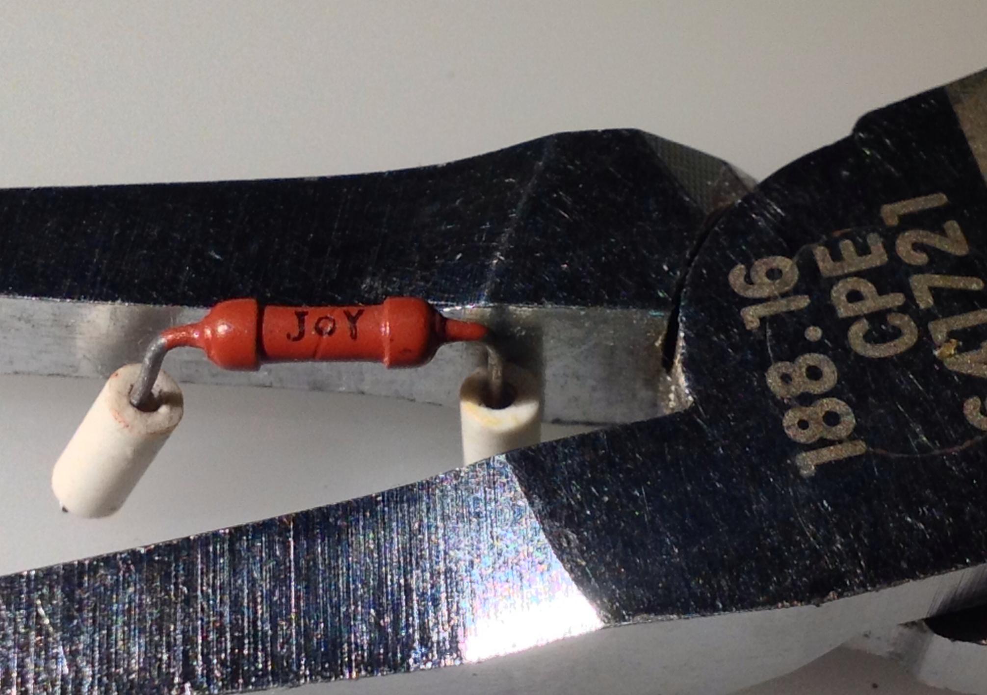

Lucky i get complete " L' Audiophile " paper edition,
funny on bench some vintage resistor made by JOY
Kind regards :)

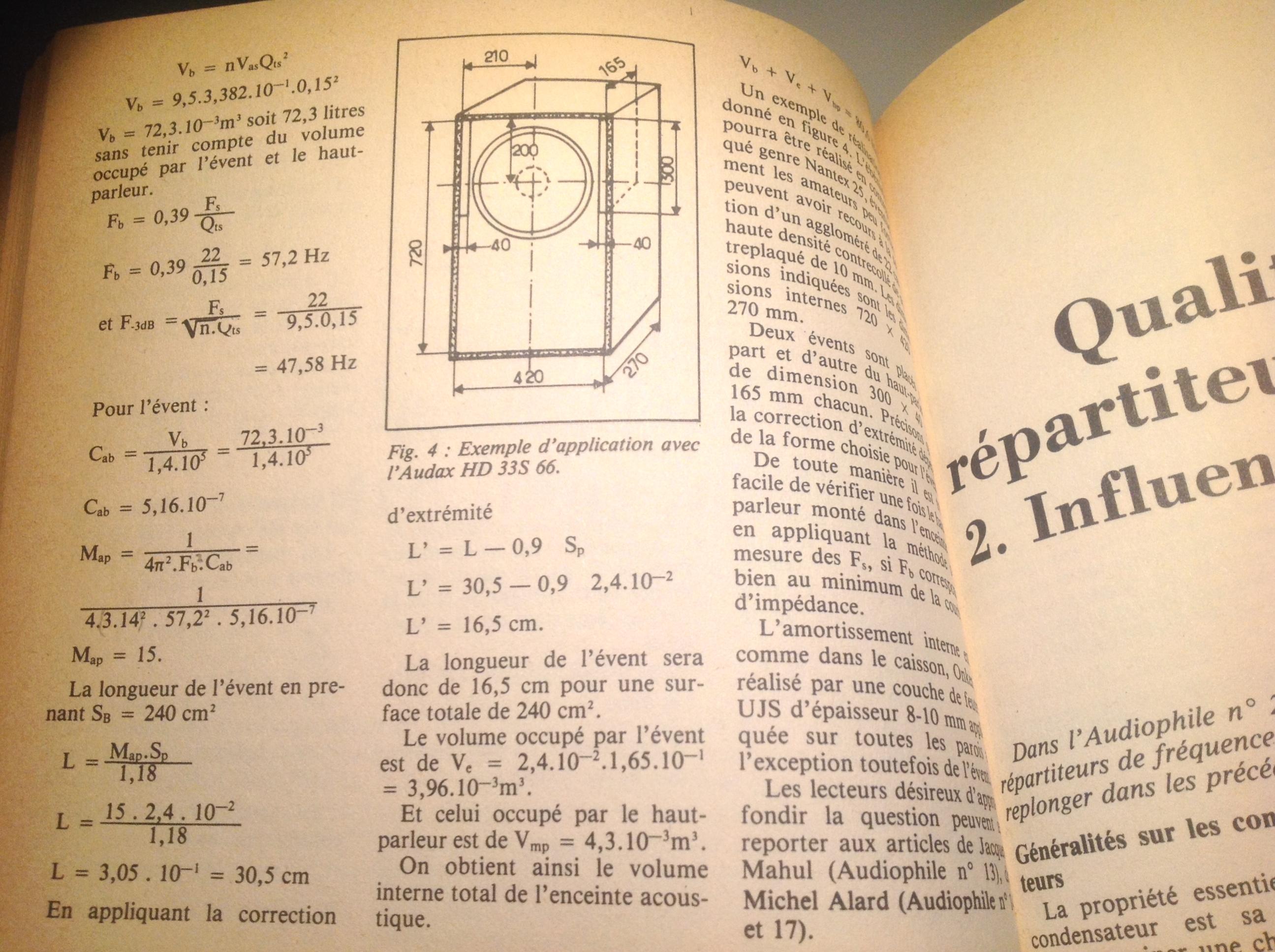

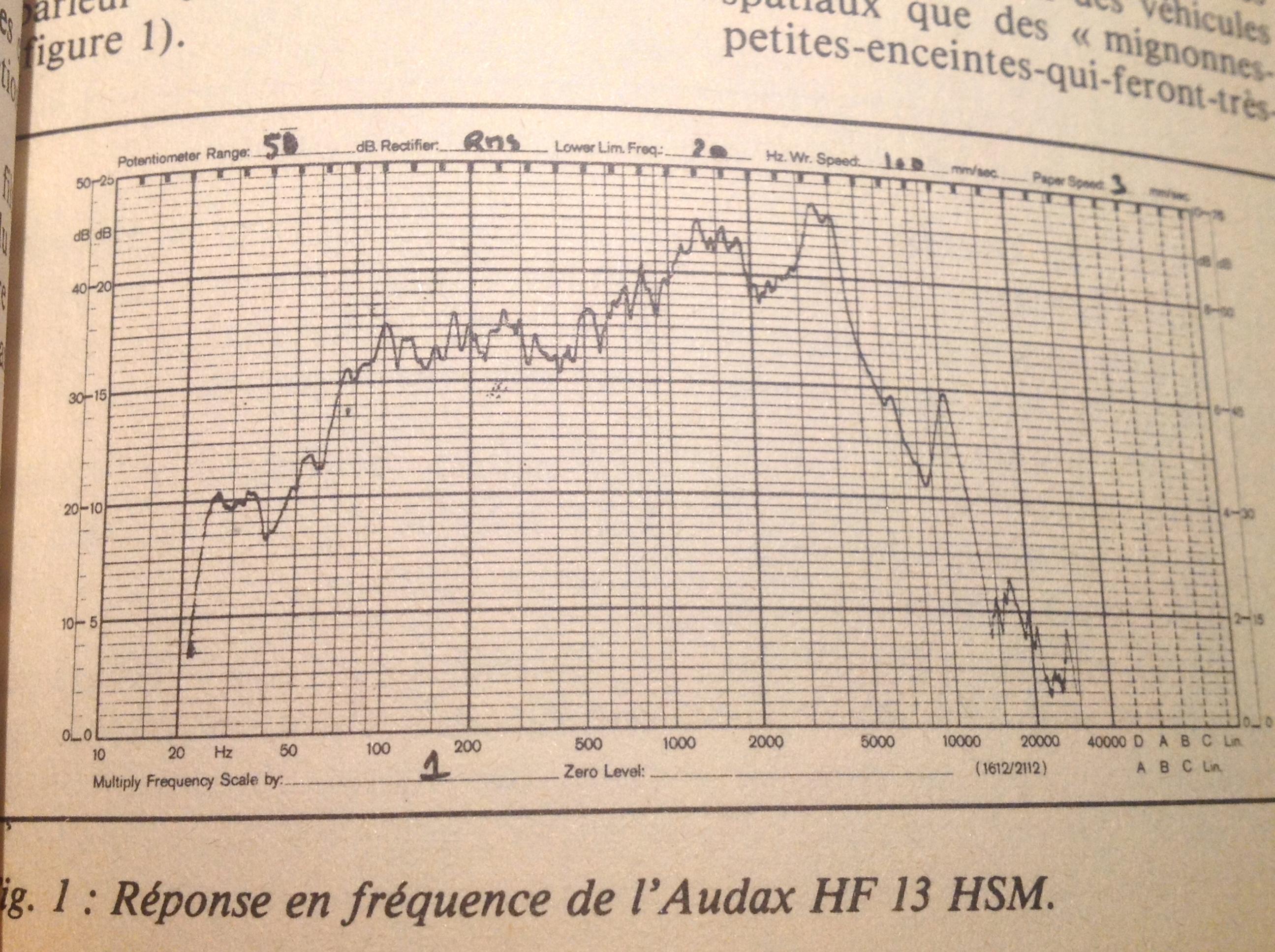

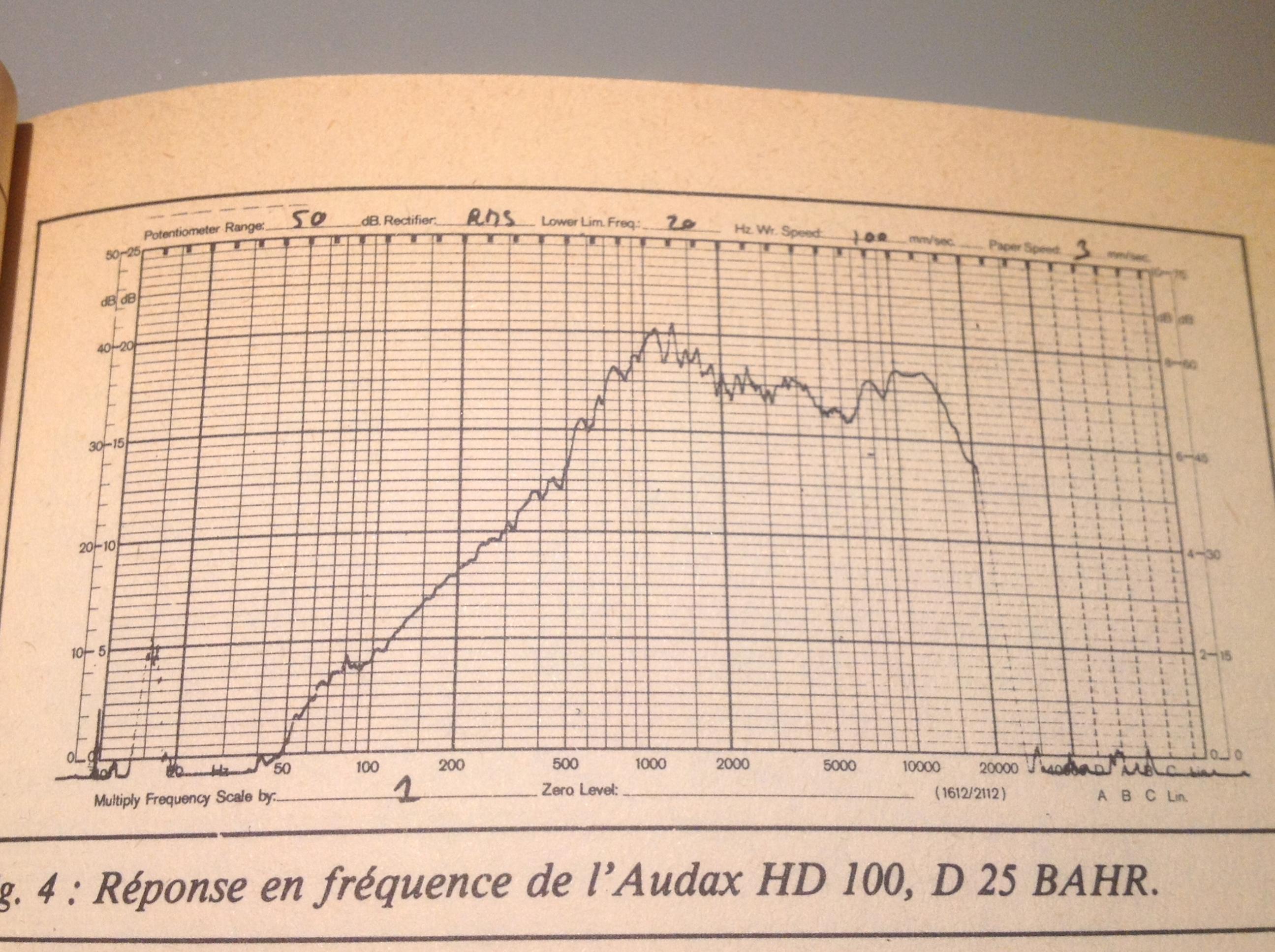

I did not see in the article what the intended loudspeakers are. Do you happen to know?
More informations about speakers used with Kaneda active filters are in "L'Audiophile " nr 23
" Little big enceinte "
High tweeter | Audax HD 100 D25 BAR
Medium | Audax HF 13 HSM 2CA 12
Low frequence central sub with Audax HD 33 S 66 or another candidate is Focal 10 C 01

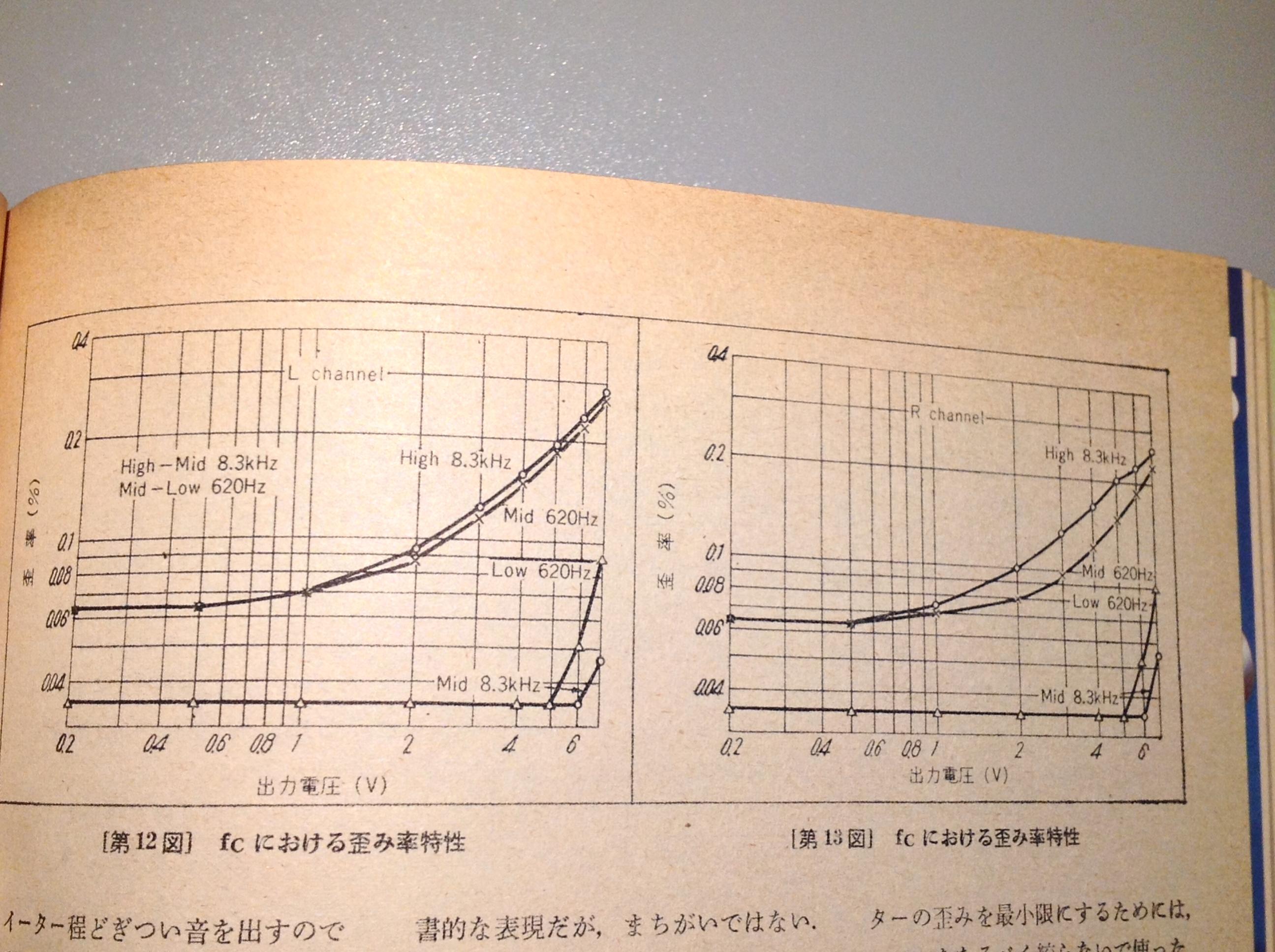

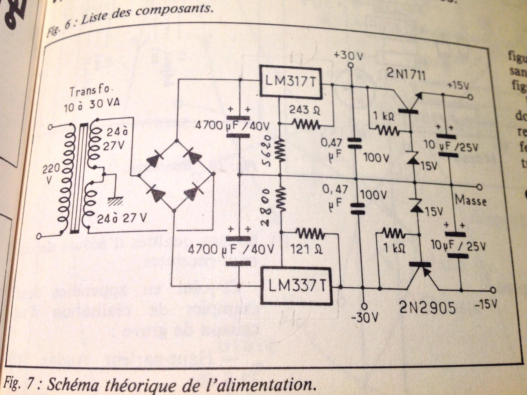

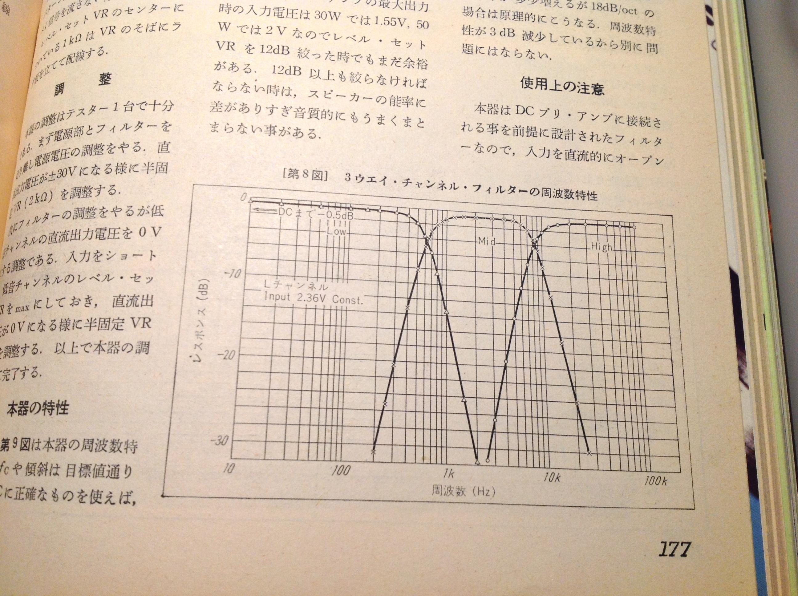

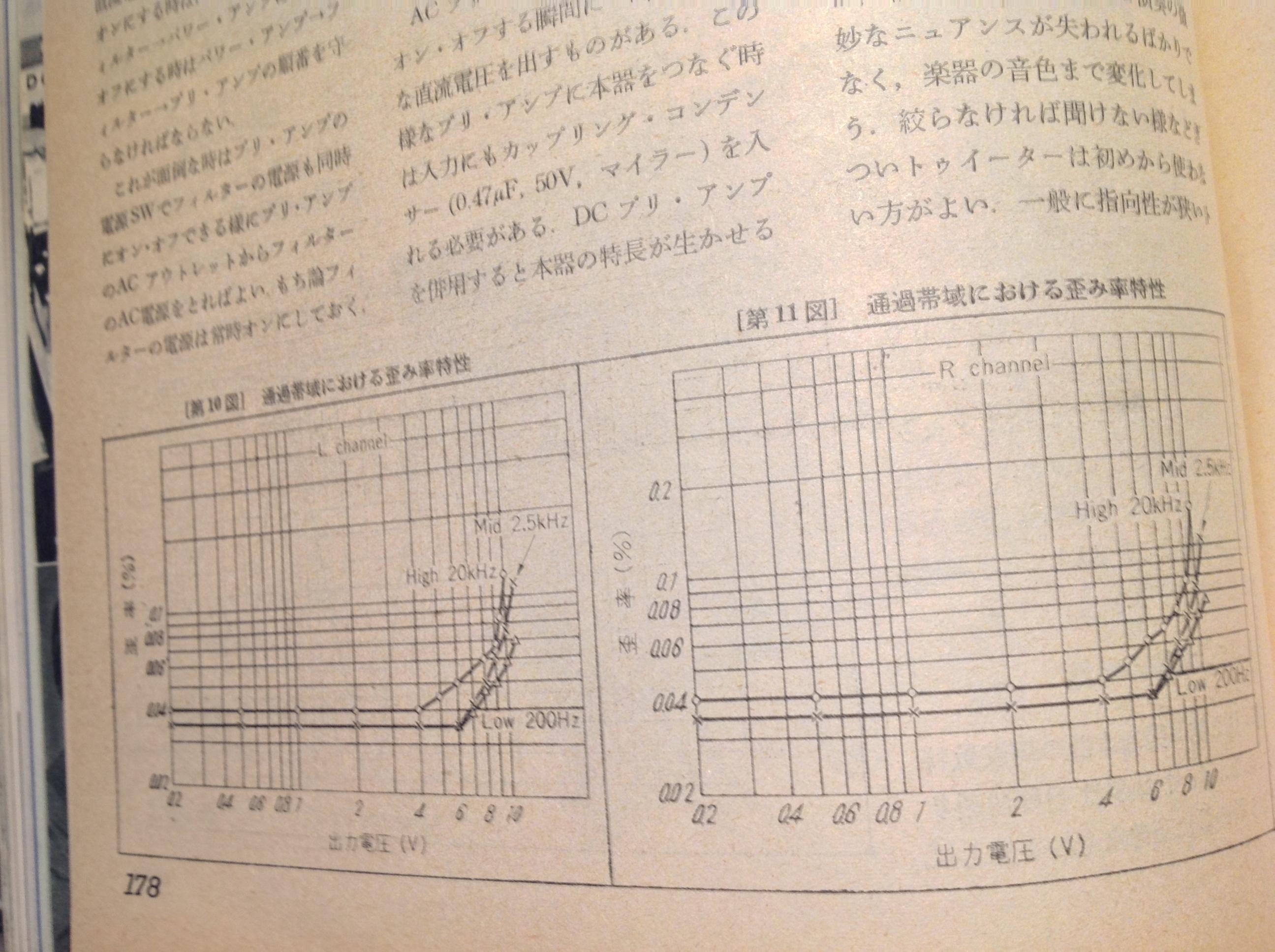

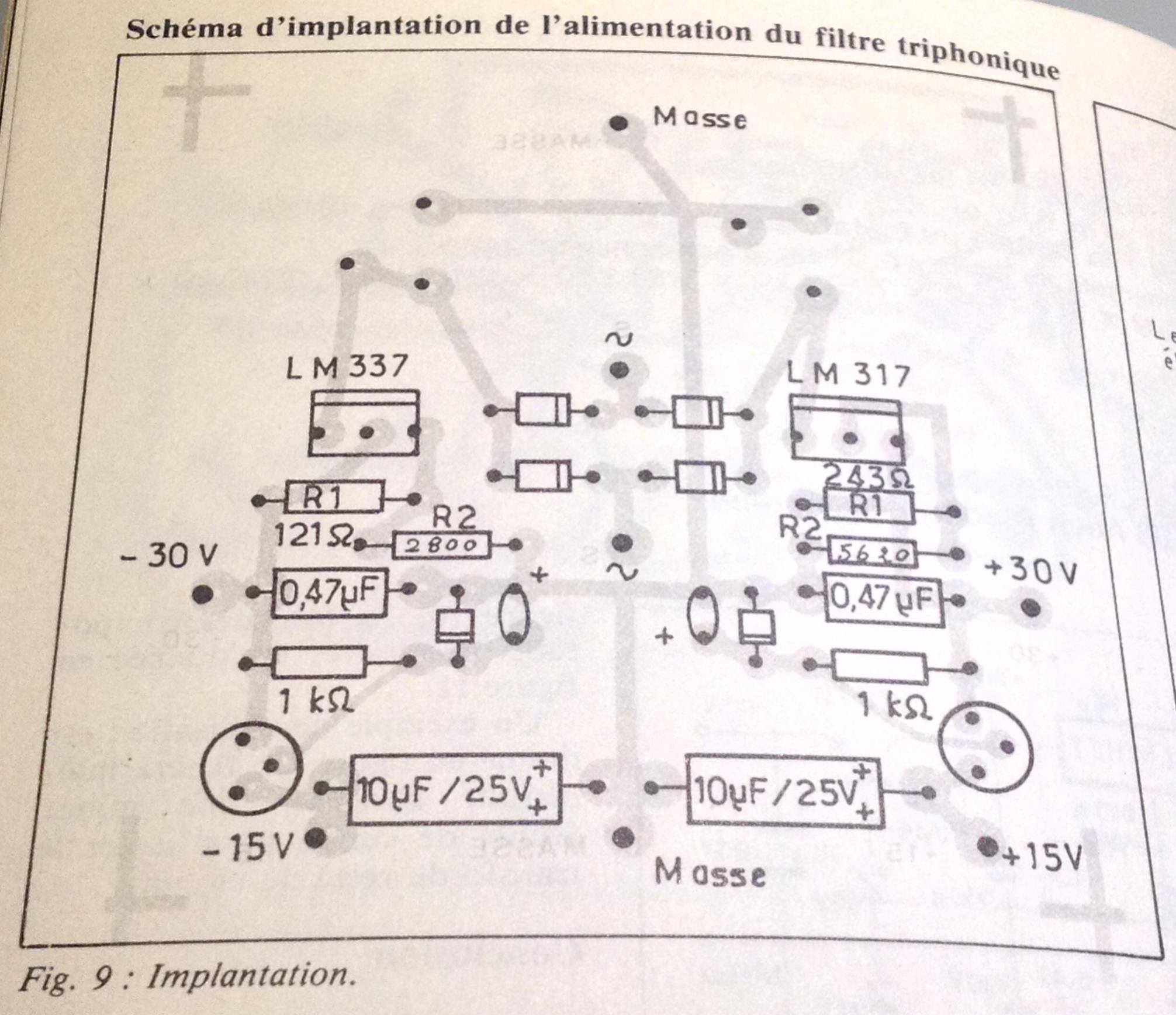

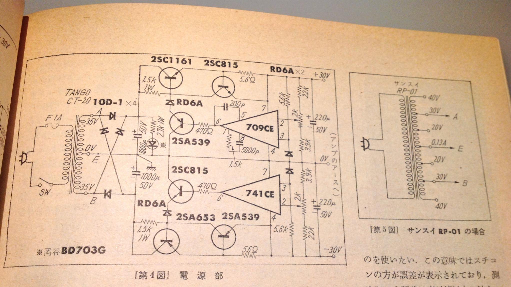

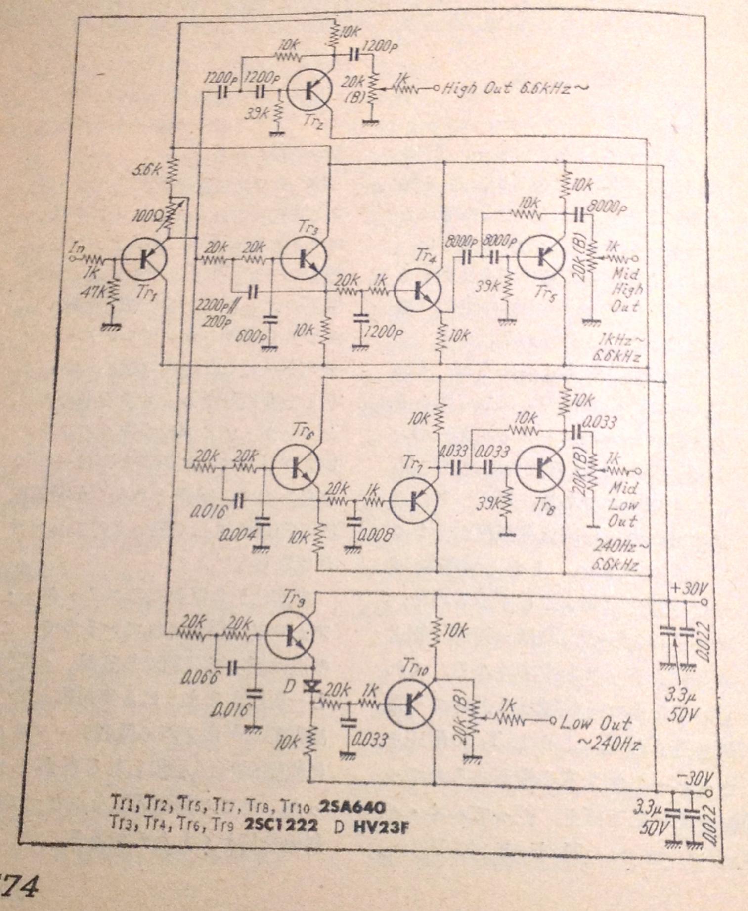

Kaneda 3 way active filter from " Stereo Technic " 1974
Thanks Soundhappy for all the information.
Thanks Adason indeed for interesting active filters thread :)
Version in Your post #1 was dedicatet originaly for small 2.1 audio system.

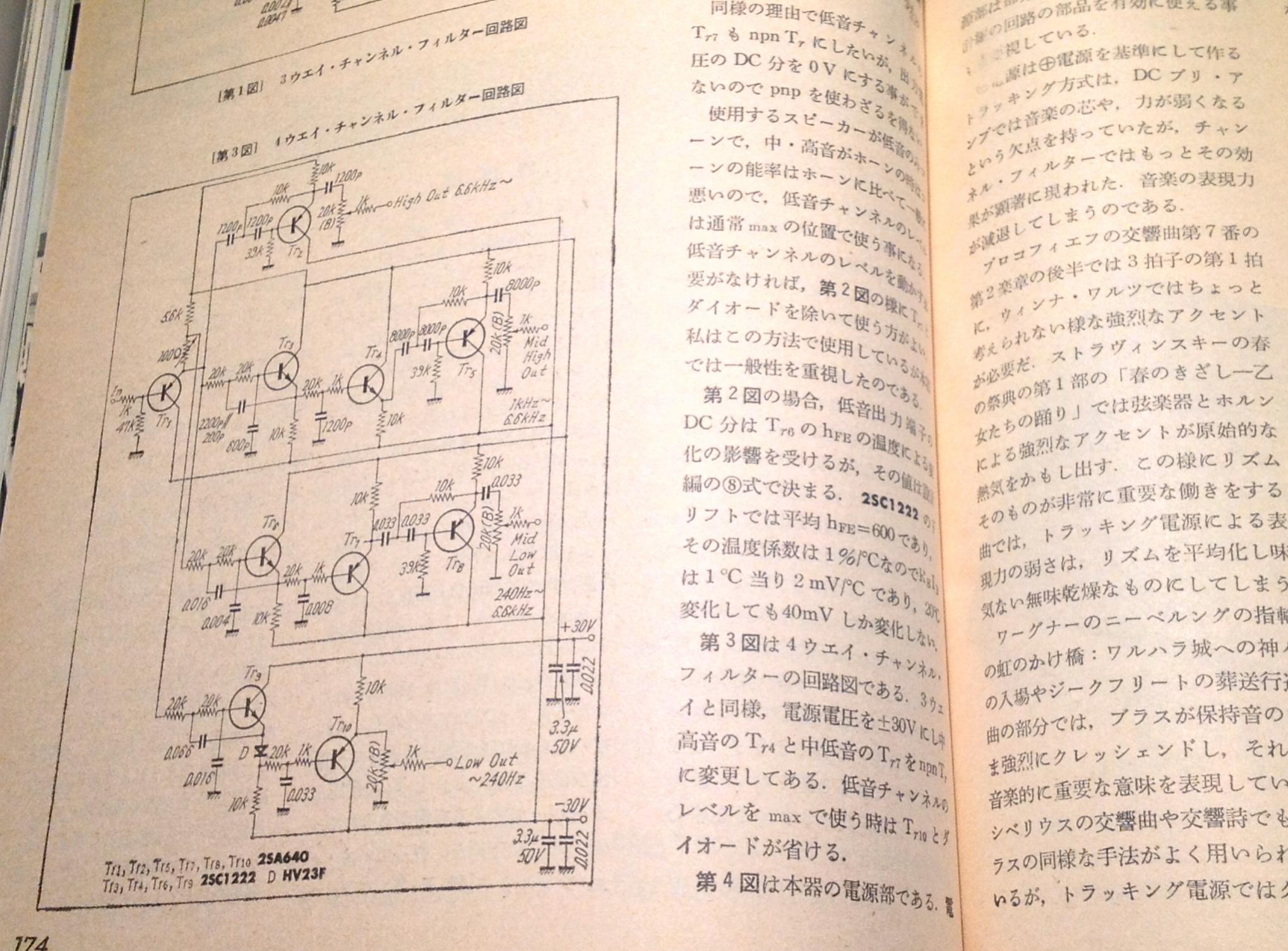

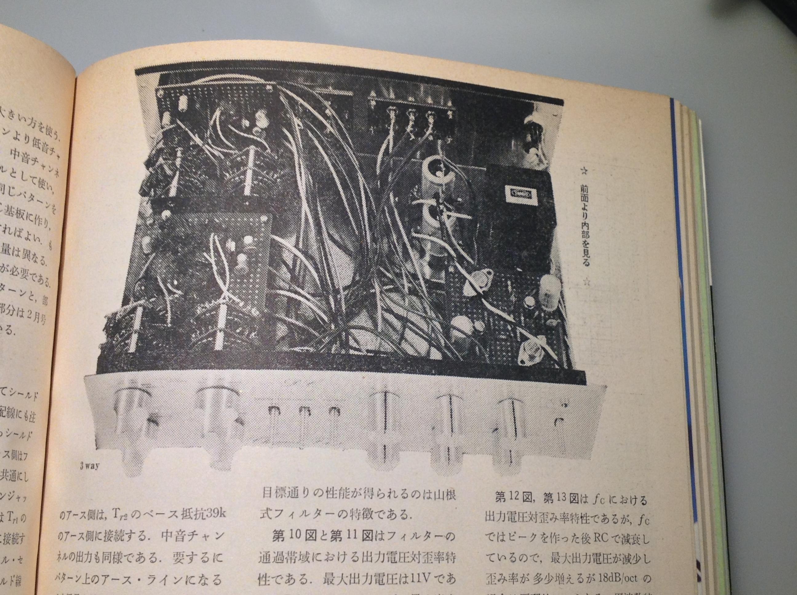

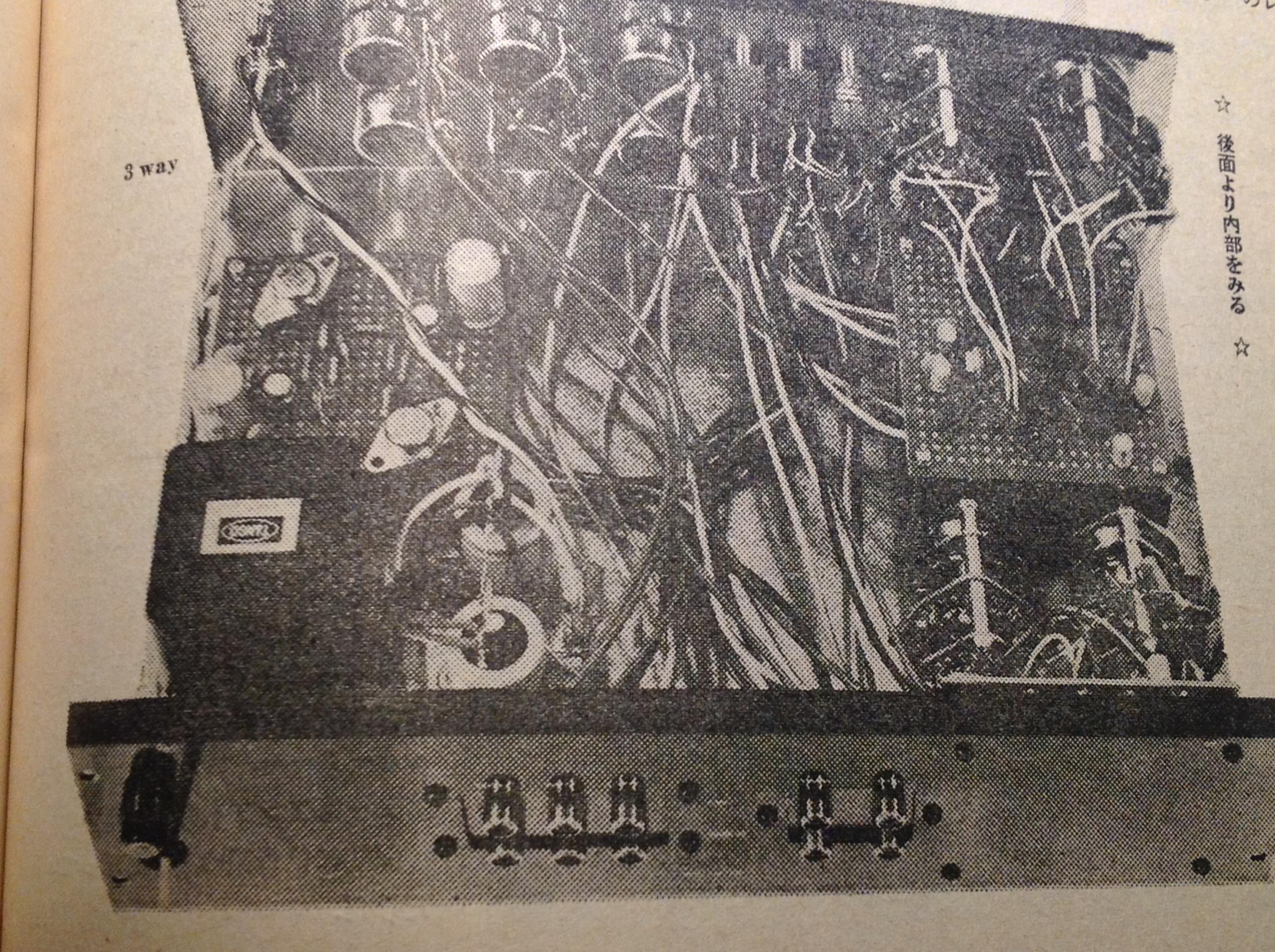

Sunday morning in my library I find Kaneda publication in " Stereo Technic " january 1974
about 3 voice and 4 voice active filters DIY with filters and psu schematics and first prototype builds photo's

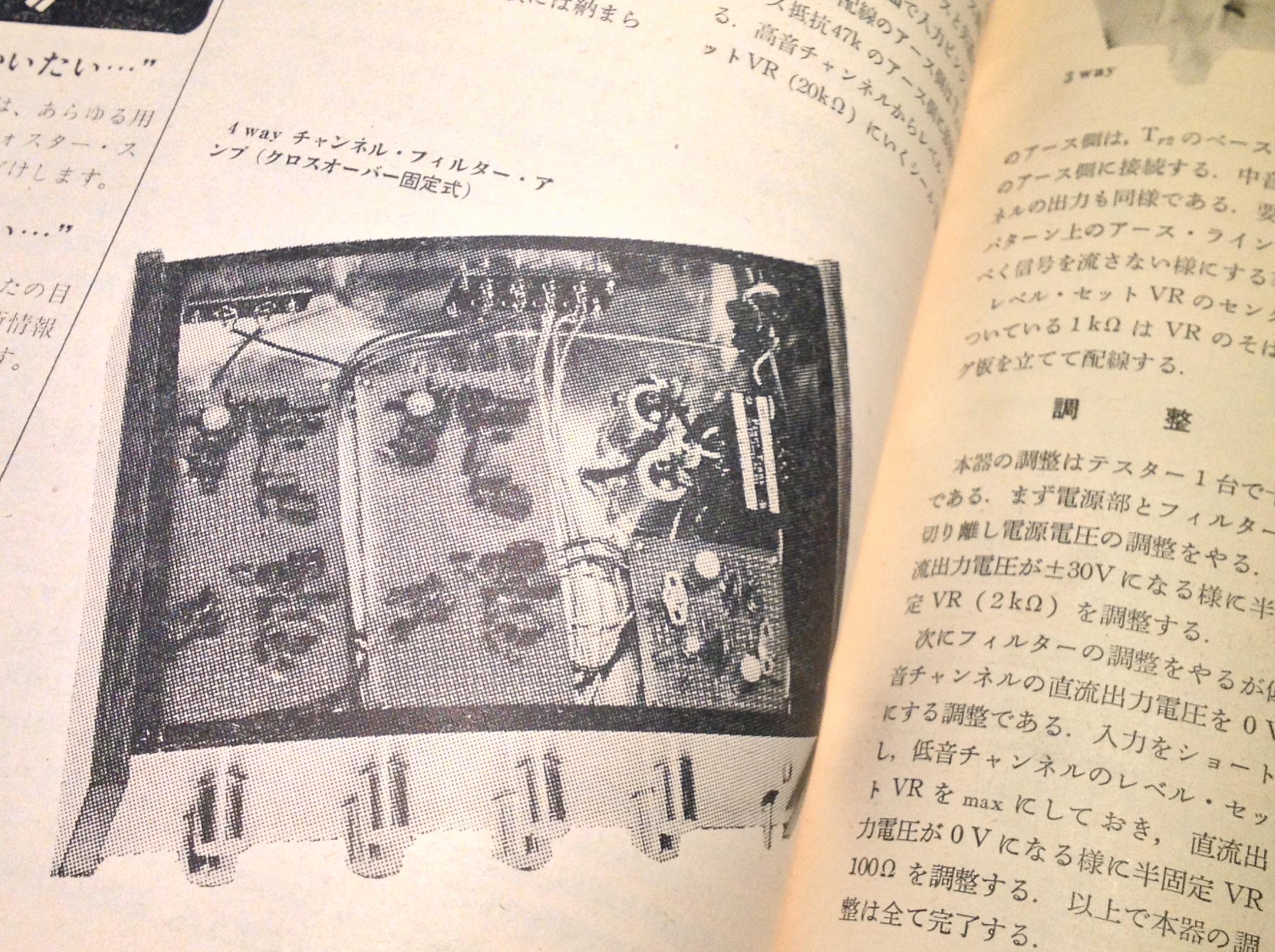

Kaneda 4 way active filter from " Stereo Technic " 1974
Original Kaneda 4 way active filter DIY publication :cheerful:

Over in the PL forum I was pointing out that the schematic in the first post
here is interesting because it has two buffer stages, with filter circuits in
between, that use a depletion mode Jfet self-biased with a bipolar transistor.
The first is an N channel Jfet with PNP bipolar and the 2nd is a P ch Jfet with
NPN bipolar. Presumably this was for cancellation of the opposite 2nd harmonic
distortion of both buffers.
Yes, it seems like a well designed circuit.
I guess there should be one more buffer on the output, since it uses one more high pass, to decouple it from next stage...
