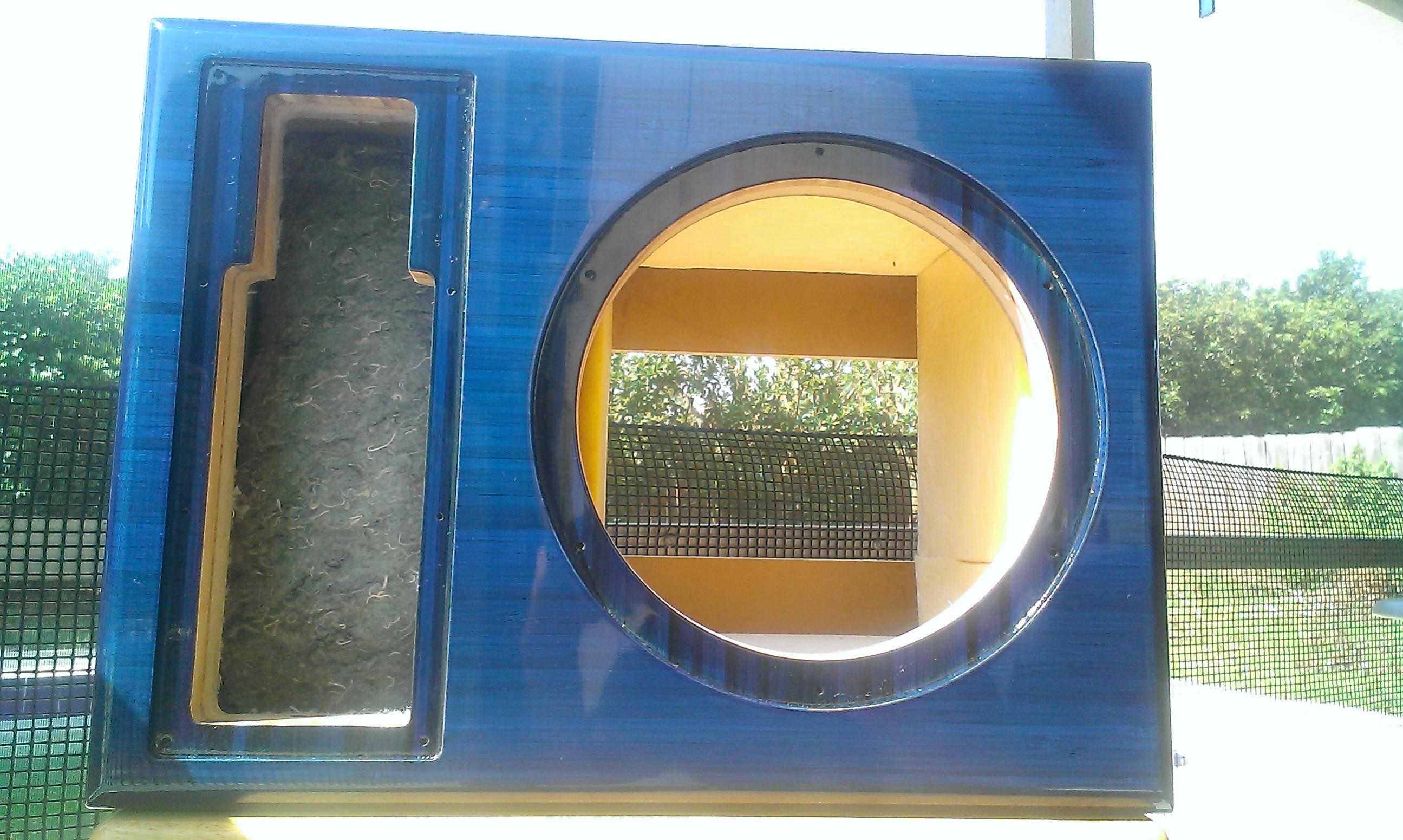

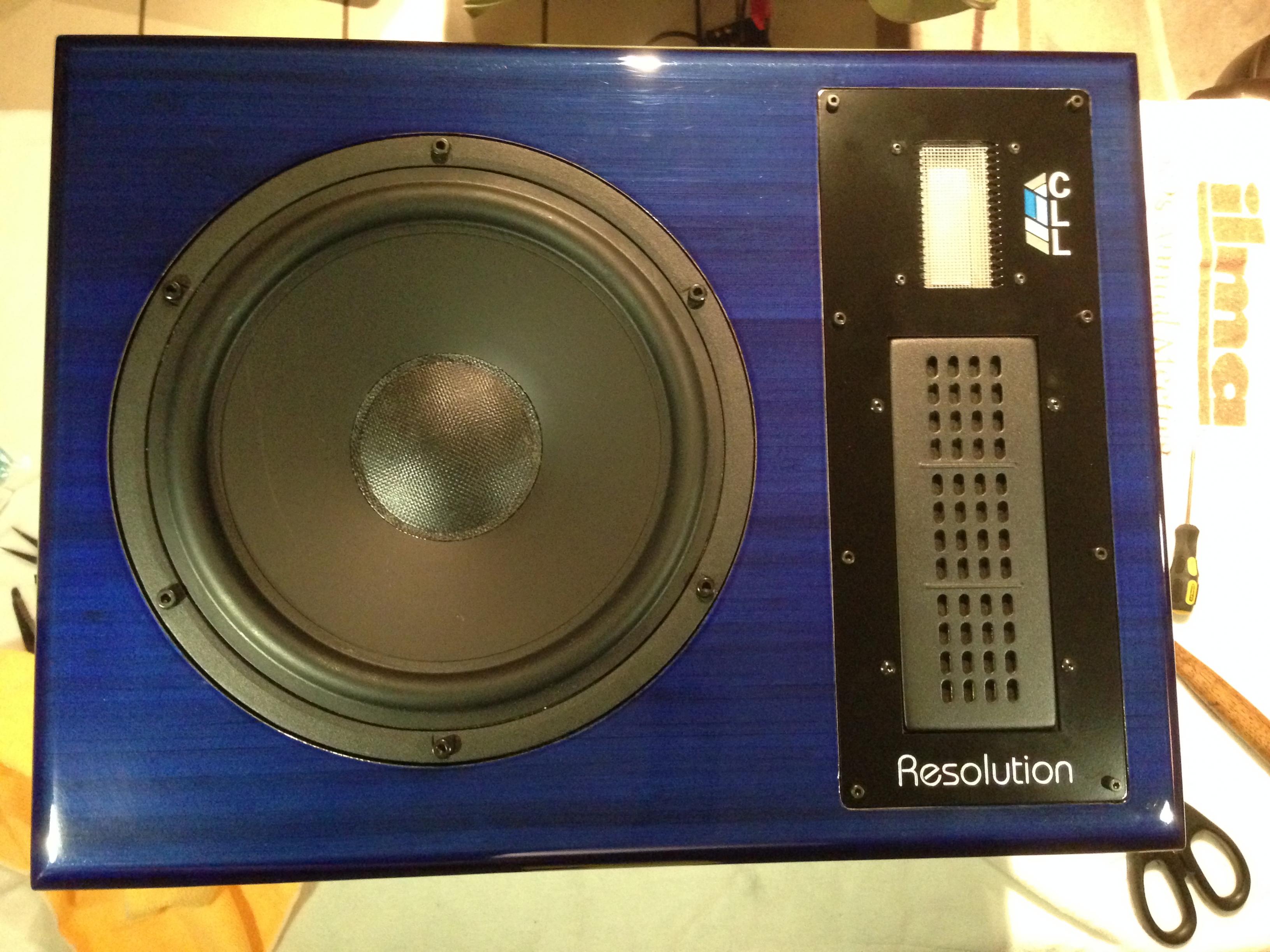

This project started out over a year ago as an idea I had for better monitors for studio "B" where I work. About 5 years ago, I designed some rather large, main monitors for the "A" room, but "B" has seen more use these past few years due to people's budgets shrinking and more folks being happy to work "in-the-box" rather than on a large format mixing console, so along with the lead recording engineer, I decided to come up with a new design.

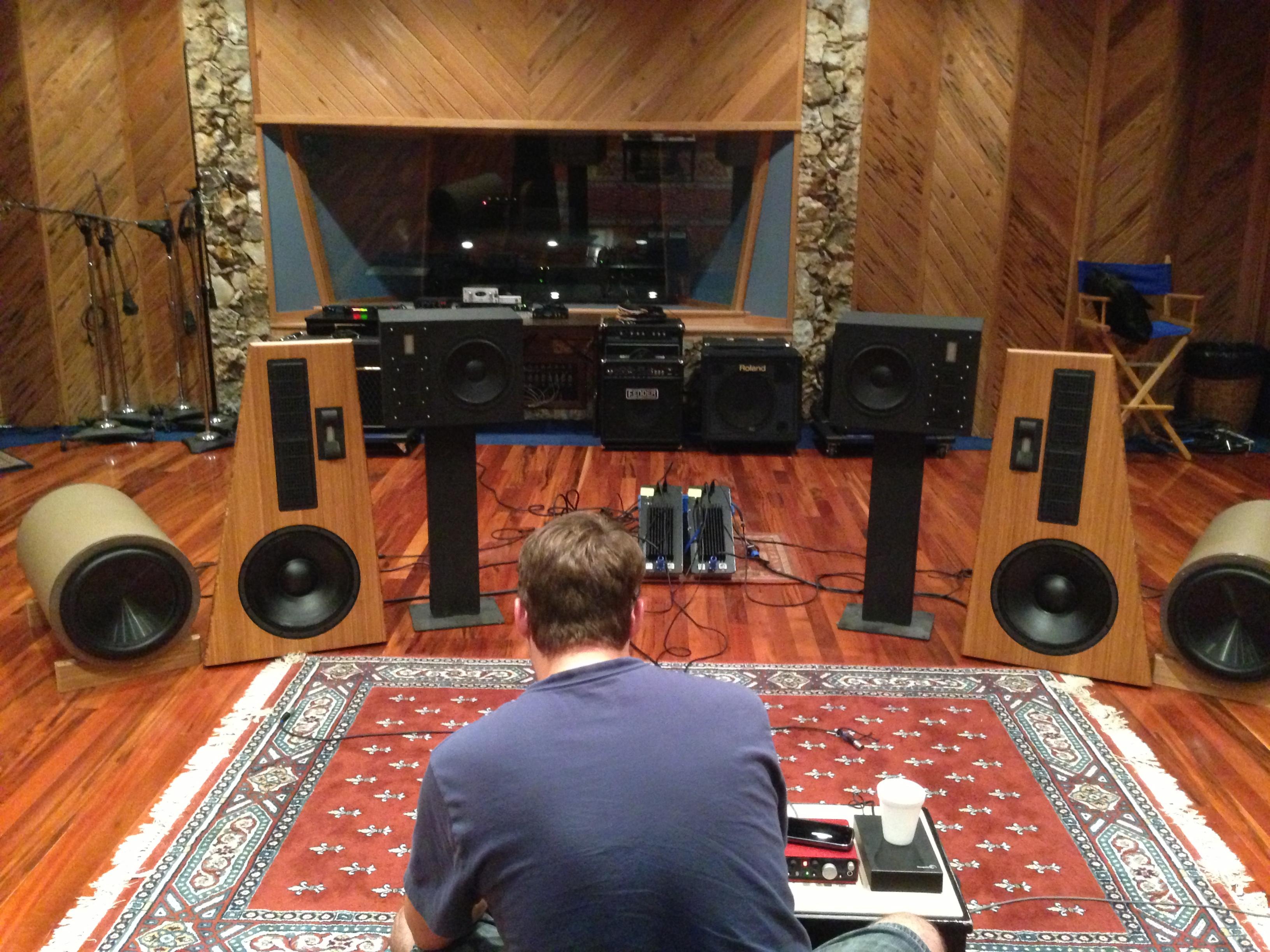

Last year we made some crude prototype boxes which have been in daily use since. You can see them in the first photo while being tested at another studio in town. While being tweeked based on feedback over the last year, we have been working out the build details in case we are fortunate enough to sell a few pairs to other engineers and producers.
Raal 70-20 OEM
Neo8-S (important to the design as the regular Neo8 was not up to the task)
Scan Speak 10" woofer

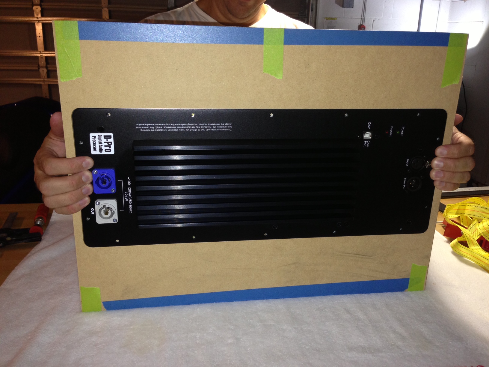

Digmoda amp/dsp modules
We auditioned and tested the Powersoft D-cell modules which were preferable due to compact form factor, preset recall and pricing, but sonically they were not as transparent as the Digmoda, so we tested the initial design with my own Digmoda from the large open baffle design I made for myself a few years ago.

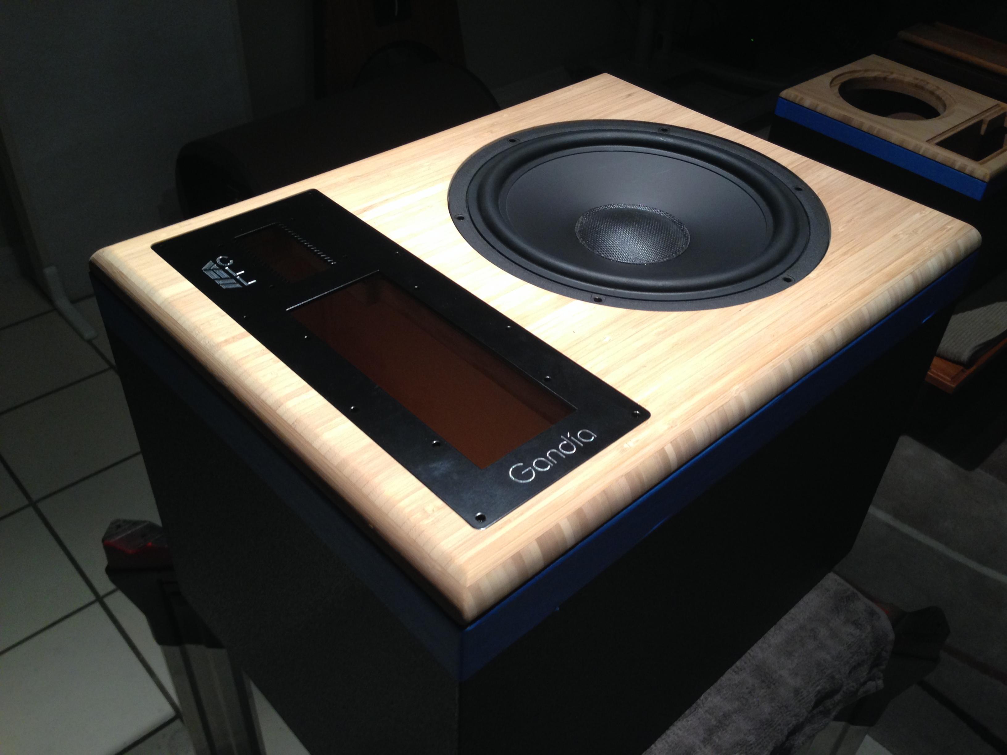

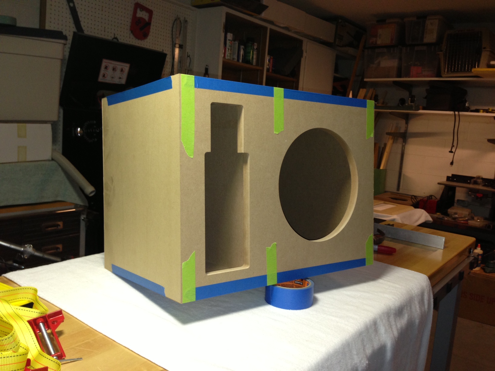

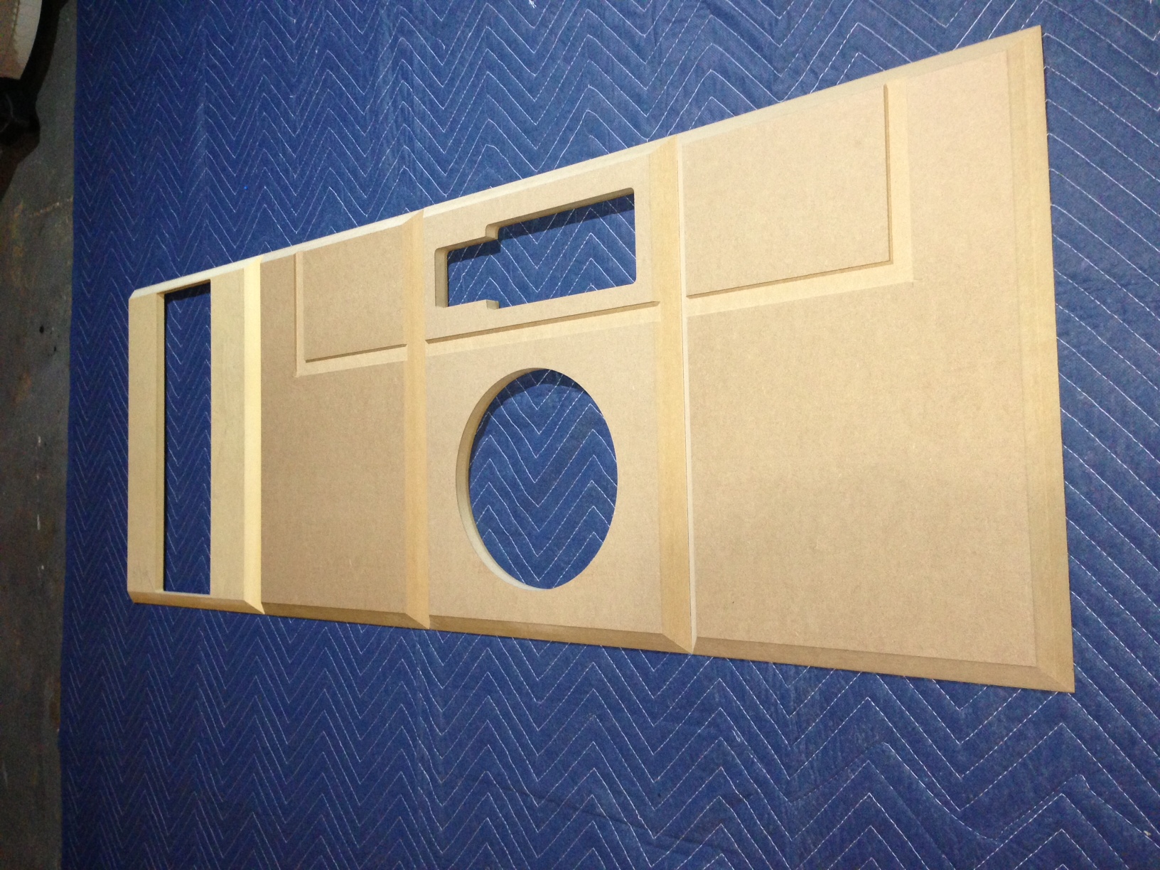

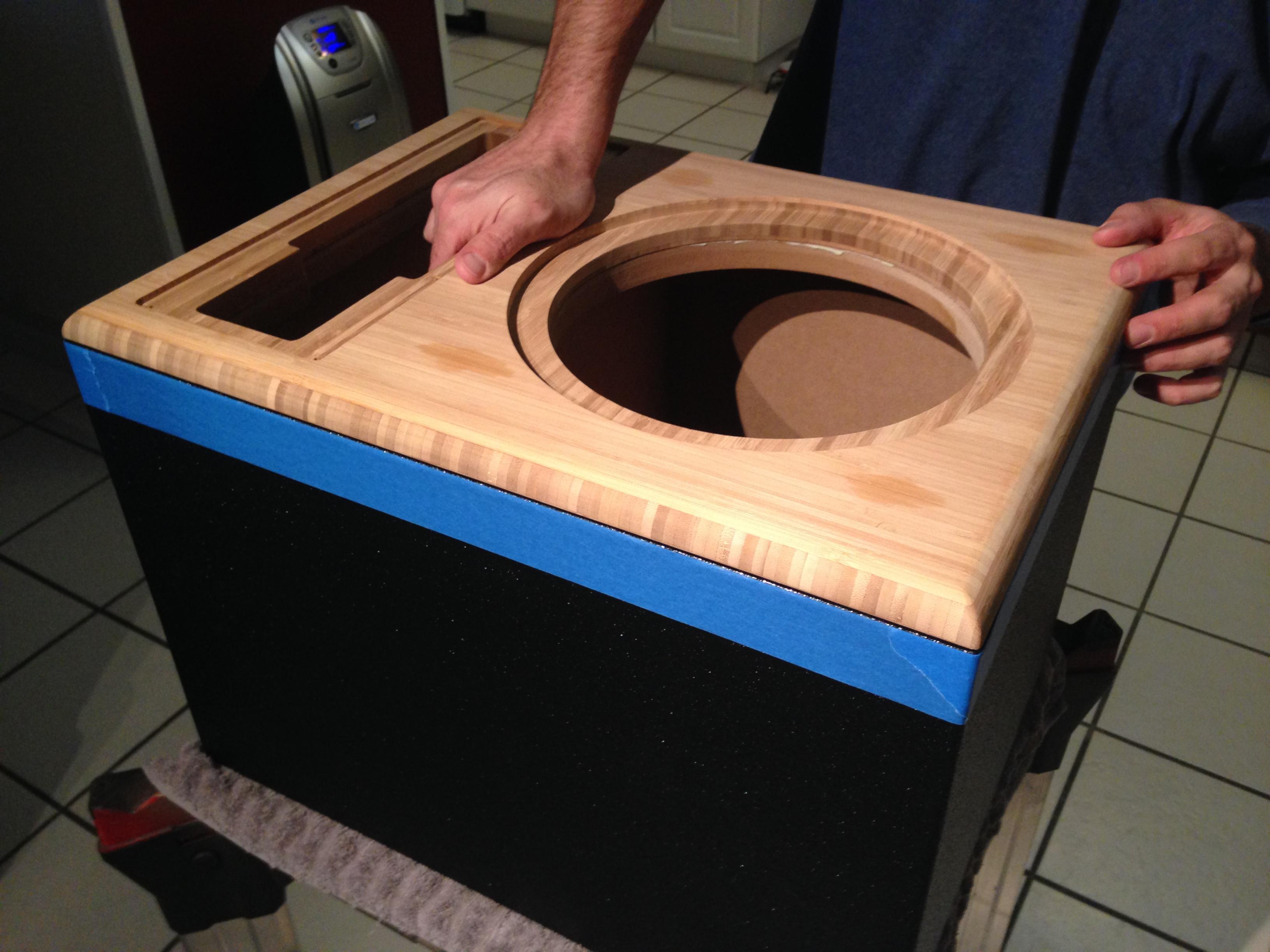

Cabinet is CNC machined with 45deg edges to make construction nearly foolproof. Tape the edges, flip over to glue and fold together. It worked out like a charm. Best, straightest boxes I've ever built. The box is coated on all sides except the front baffle with a 2-part, hot spray finish similar to truck bedliner or the coating used on higher-end PA speaker cabinets. The front gets an additional layer of bamboo ply for rigidity as well as cosmetics. This pair was finished with an tinted, automotive clearcoat inspired by some custom Paul Reed Smith guitars. Lined generously with rigid fiberglass and stuffed with Bonded Logic.

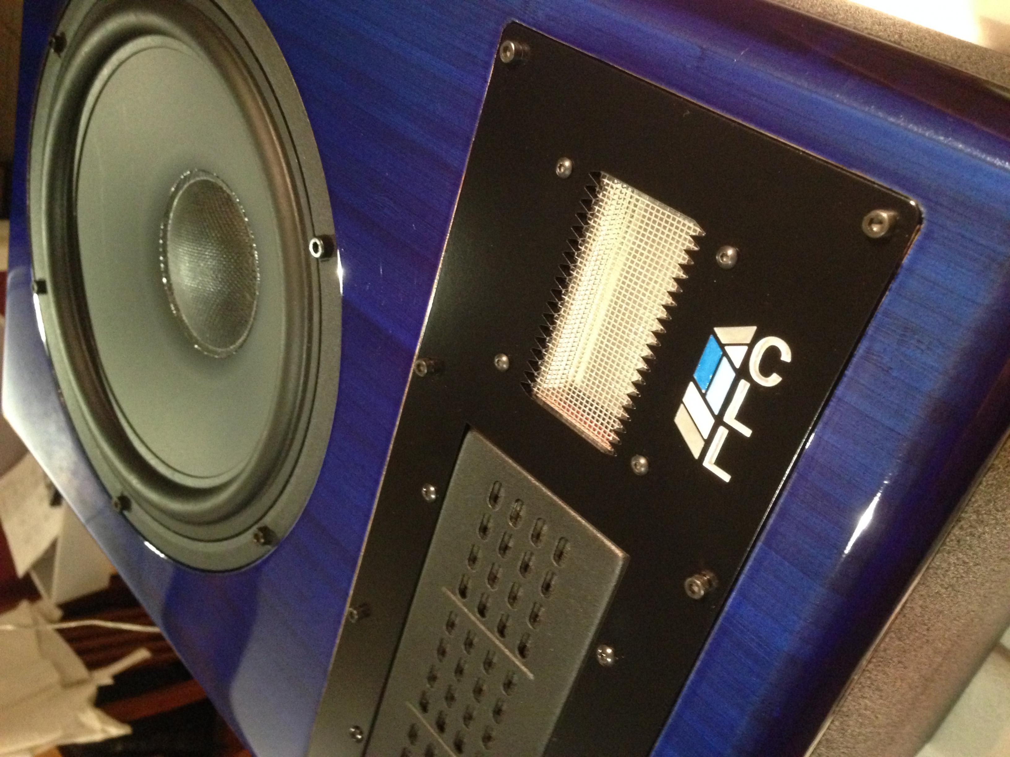

We designed a custom-made faceplate to hold the Raal and Neo as close together as possible. This also gives us space for a logo and/or the clients name as a custom option.

We are pretty pleased overall with the looks and the sound. I'm pretty critical though, so there are a few cosmetic issues we will sort out for any produced for sale. There will be a few design changes too, like adding some additional bracing in the woofer chamber. So far, they've been compared to monitors costing upwards of $8,000 per pair and we feel we have them beat in regards to resolution(hence the name) and overall quality. There's something with the combo of Raal and planar mids that traditional cone/dome drivers don't give you. In fact, in direct comparison to my large open baffles, in that picture of the huge studio space, these monitors sounded better. Obviously they gave up ultimate dynamics and low end reach, but as far as midrange clarity(really hearing INTO the recording) and sense of space, they beat mine. I was happy and pissed at the same time! The acoustic space they could portray was truly holographic. On good, hi-rez recordings made in a natural acoustic space, it was like a huge bubble of sound being cast into the studio. Taking either speaker back to a normal sized room, close to walls was a real bummer after that experience. We have not come close to realizing that performance anywhere else.

The woofer is placed beside the mid/tweet to keep the height low enough for seated listening when placed over top of a desk or mixing console. Since the x-over from woofer to mid is low enough, there is no problem with lobing off to the sides.

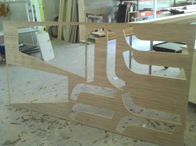

You have to luv CNC machinery... nice monitors.
Thank you.

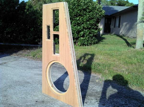

Yeah, I got all of the layers of my OB CNC'd as well and will never go back to homemade boxes if I can afford it. It has been difficult to find a shop that wants to do the work AND has their machine set-up well enough to get the 45deg design to work, but once we did, man it is sweet!
