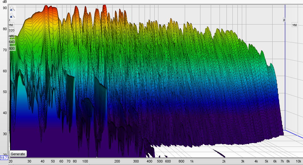

As an update from my part (mostly regarding usage of electroacoustic absorbers), I went beyond using only one method to get good bass in my room. I supplemented the existing two big Hofa's (functional bass trap type) with two EQ Acoustics panels (membrane bass trap type) and increase the number of multiple subwoofers from two to five. The improvement is so substantial that I can call for armistice and will resist spending more on either acoustic treatment or subwoofers because I want my room looks like a home, not a recording studio.
I tested all the hard bass tracks I knew or recommended by others and on neither one I found any trace of "instability", all sounded as they should (I'll come back with a waterfall I did on that occasion).
Regarding the effect of a passive electroacoustic absorber, I observed that it is so diminished after I increased the number of usual bass traps and subwoofers. To the level it becomes indiscernible. As long as my room was untreated it was quite discernible, not the case now.

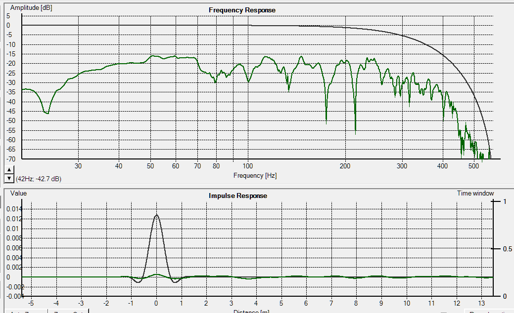

Indeed, mono under 100Hz and two "mild" parametrics on 51Hz and 61Hz.
Positions, as staying on the couch were:
- one in front, between the mains, in phase.
- one in front, left-upper corner, in phase.
- two identical, left wall (~2/3 wall lenght) and right wall (~1/3 wall lenght), both in phase.
- one on rear wall, right corner (better in the middle but poor WAF), in phase (if put in antiphase then 25Hz dip disappears but interval 25Hz-50Hz decreases).
I put two graphs; on waterfall, do not mind those 80Hz and 160Hz noises caused by an autogenerator in nearby building which got tested for an hour just when I did my experiments :)

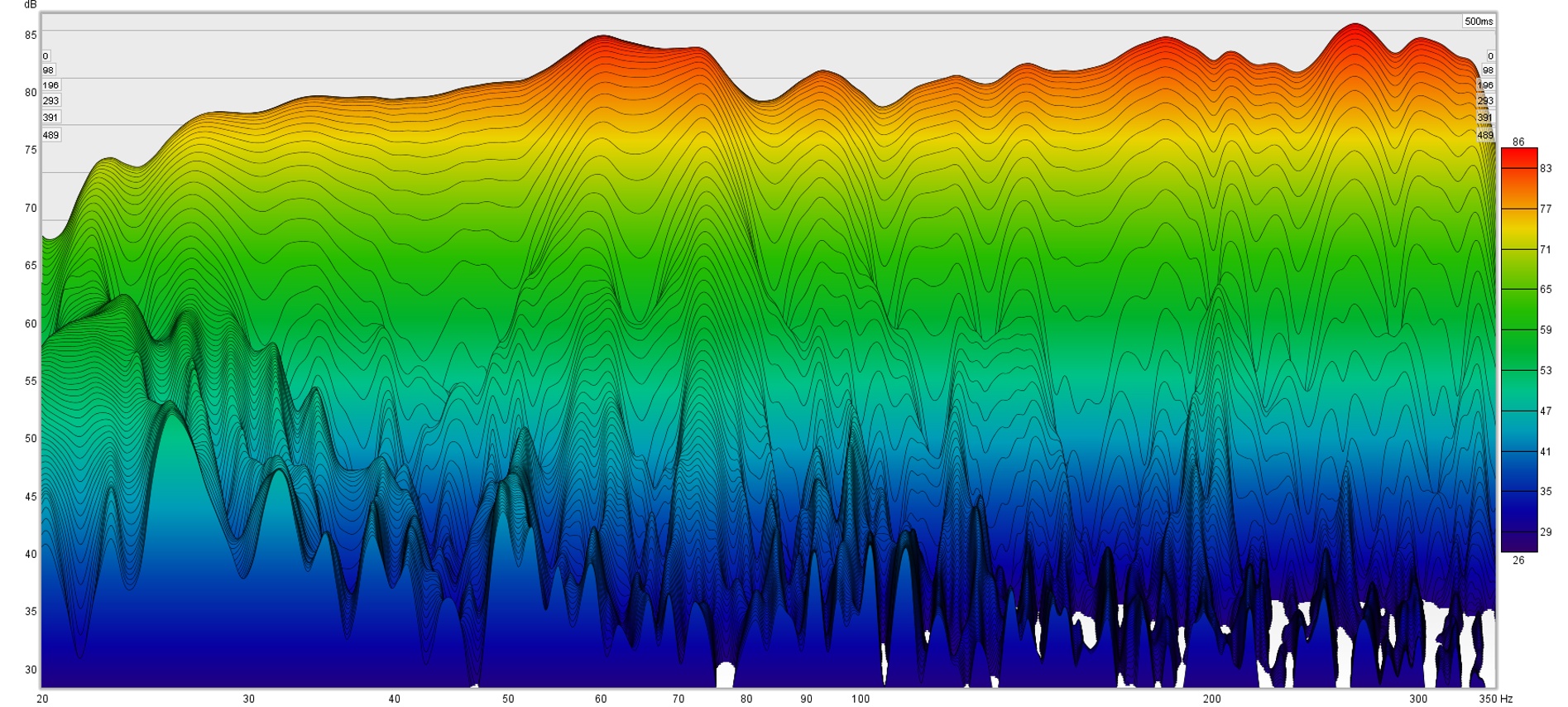

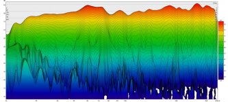

I would advice to zoom in the waterfall between something like 20-350 Hz and use 5 dB increments. See example below.
Either way, looks like you have a lot of resonances.
