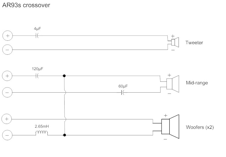

I have a pair of AR93s speakers that I am restoring. I have refoamed the woofers and mid-range drivers, and am now working on the crossovers. I want to draw up a schematic of the crossover, and would like help making sure that it is drawn correctly. I am a complete beginner at drawing schematics, and I am unfamiliar with the basics of electricity flow in a circuit. I could find no schematics for the AR93s crossover on the internet, and would like to make a good one to share.

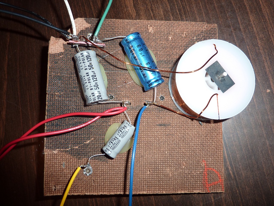

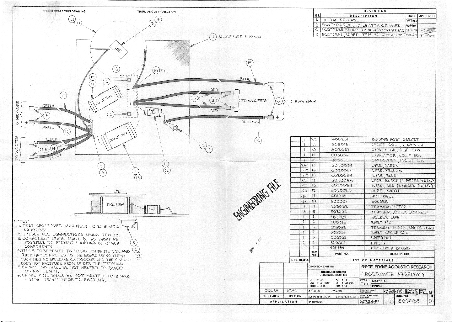

I have examined the actual crossover taken from the speaker, and have drawn up a schematic that shows the connections pretty accurately. I also found a great engineering drawing of the crossover from the library at the Classic Speaker Pages. This drawing appears to be authentic, from Acoustic Research, and exactly matches the crossover from my speaker. This drawing, and many others for AR speakers, can be found here:
http://www.classicspeakerpages.net/...special_sections/drawings/SpeakerDrawings.swf
I am a bit puzzled by this crossover, for a couple reasons:
1) The 120µF capacitor appears to be in series with the mid-range driver. The mid-range driver already has a 60µF capacitor in series. I would think the 120µF capacitor would be serving as a high-pass filter for the woofers.
2) The 2.65mH air-core inductor, which appears to be in series with the woofers, is on the negative line (on the wire returning from the negative terminal of the woofer to the negative terminal of the binding post). All the crossover schematics I have seen show the components on the positive lines. (The inductor in my speaker measures 2.65mH, although the engineering drawing specifies 2.623mH).
I understand that these questions may only be serving to show my ignorance in this subject. As can be seen in the engineering drawing, the wires to the negative terminals of the woofers, the wire to the positive terminal of the mid-range, the air-core inductor, and the 120µF capacitor all connect to one solder point. Why is this, and how is it correctly drawn?

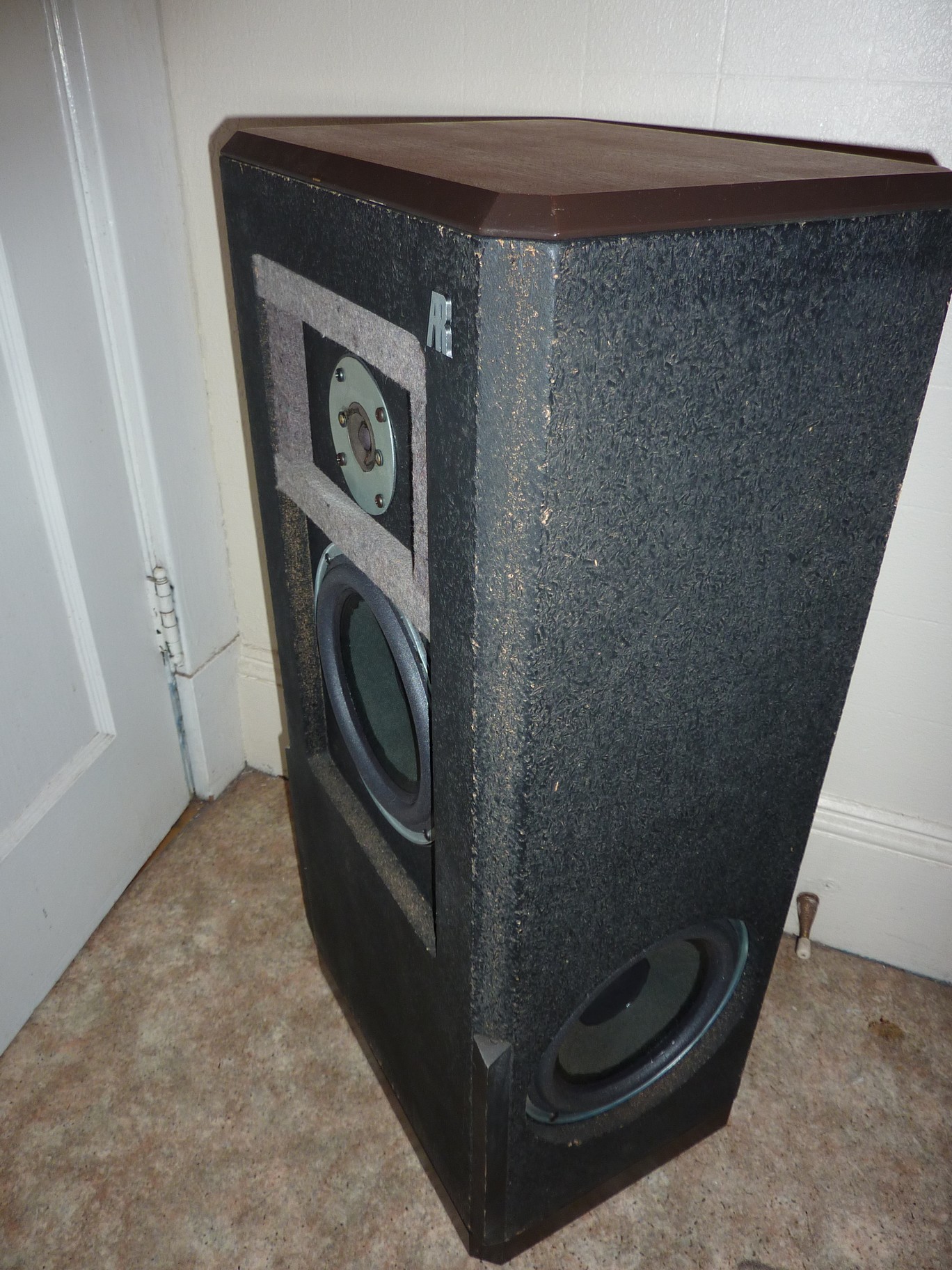

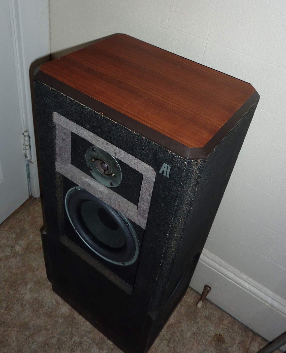

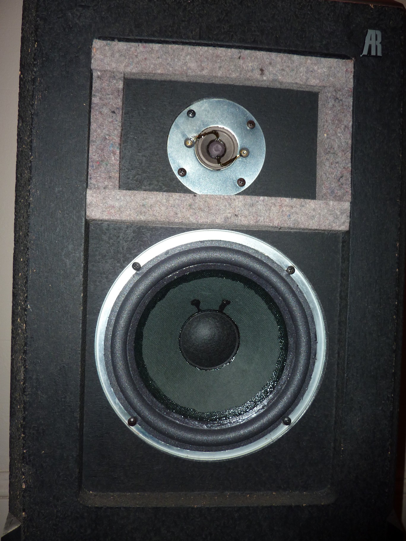

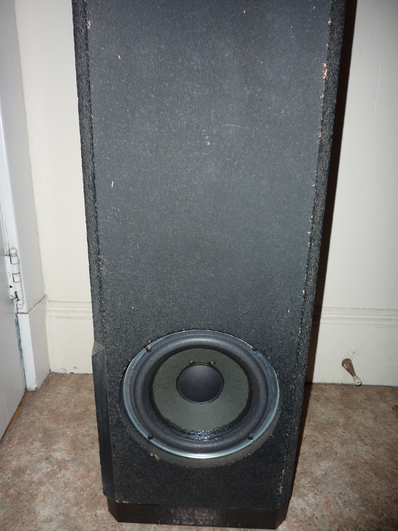

Here are some photos of one AR93s speaker, with the cloth sock off. There are two woofers, one on each side of the cabinet. I have more photos (including close-ups of the drivers), and can post them, if requested.
The 120uF effectively isn't in series with the mid, such is the nature of
series crossovers, which can be very confusing. The bass/mid x/o is
series first order on the bass and second order on the midrange.
More confusing is the current through the mid mostly passes through
the 120uF so it seems to be in series, but it strictly it isn't. One way
of looking at it is the mid is driven by the voltage across the inductor
with current provided by the capacitor, and the bass units are driven
by the voltage across the capacitor with the inductor providing current.
Best to look at as a 1st order series driving a bass unit and a mid unit
fitted with a series capacitor (the 60uF). Unlike parallel the impedance
of one drive unit (or unit +cap) affects the signal to the other driver.
(And hence the possible superiority of 1st order series vs. parallel,
you can use this interaction to your advantage if it works well.)
rgds, sreten.
two different schematics above
bandolino's schematic shows a Third Order high-pass filter to the midrange , and a Second Order low-pass filter to the woofer
-{which combines with the mechanical upper midrange rolloff of the woofer to form a higher order low pass filter}.
The position of the 60uF cap is unusual.
Depending on the output impedance of the driving amplifier , it could be argued that the mids' high-pass filter is Second Order electrical ,
and there will also be the mechanical roll-off of the low frequency end of the mids driver combined with the electrical network to form a higher order high-pass filter.
The inductor is connected in such way so as to cause it to perform two functions - one for mids and other for bass.
Yes, I do see an argument for First Order low-pass to the woofer , but it would only be partially such.
I think there will be a bit of a mixture occurring there ,
and what will actually be happening will depend on the inductances of the voice-coils of woofers and midrange.
filter to the woofer . The position of the 60uF cap is unusual. Depending on the output impedance of the
driving amplifier , it could be argued that the mids' high-pass filter is Second Order electrical , The
inductor is connected in such way so as to cause it to perform two functions - one for each driver.
system7 has drawn a different circuit.
Hi, Every point above in your post is wrong, rgds, sreten.
corrections were made in my post above
Hi sreten ,
I realized my errors and was editing whilst you posted.
What remains in my post is defendable - it requires some thinking about ,
and in particular about the inductances along with the effective increases of resistance with frequency in the woofers and midrange driver.
Villchur and who-ever other engineers there knew how to integrate external crossover components with the electrical and mechanical characteristics of their drivers.
Further discussion is welcome !

FWIW, the schematic I came up with was simply untangling the confusing AR filter schematic. AFAIK, it is an accurate electrical representation of the crossover in a form the modern eye can follow. Just Topology really. :cool:
