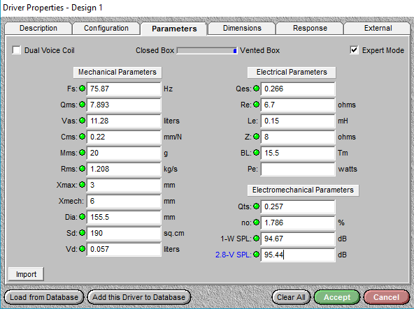

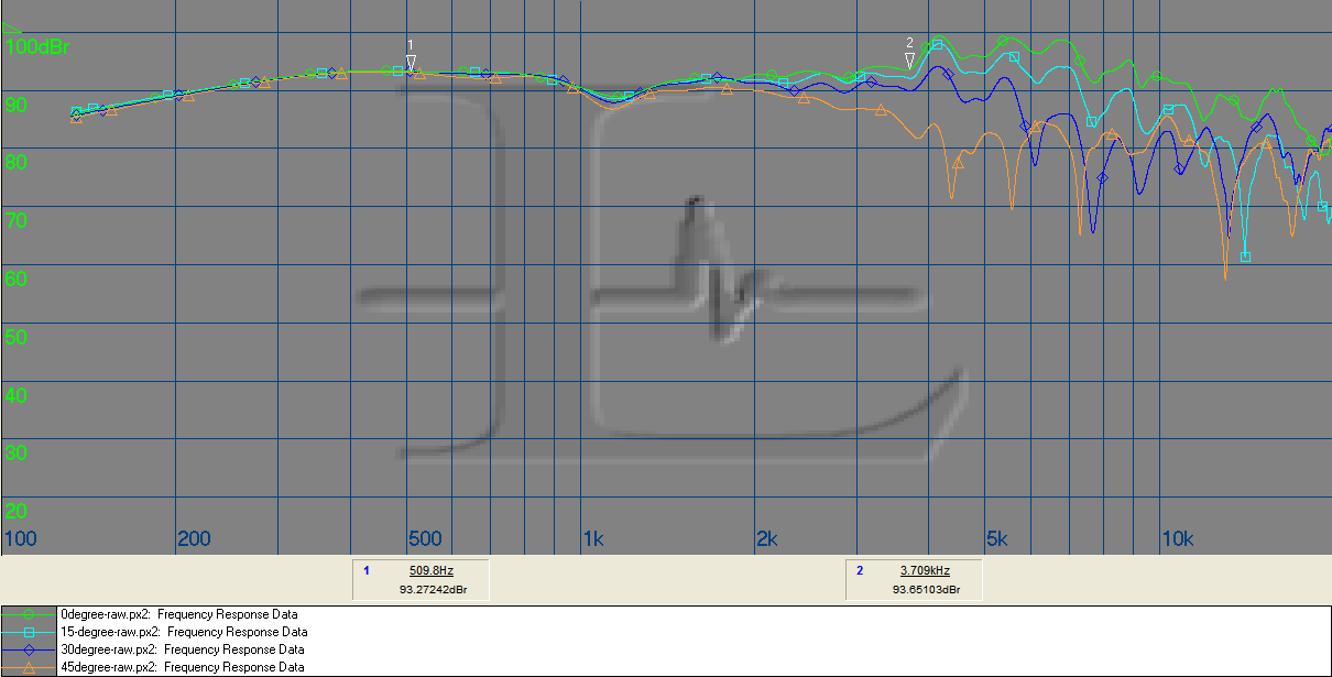

Recently AE sent me this info about the TD8M. I also have data for TD6M if you're interested.

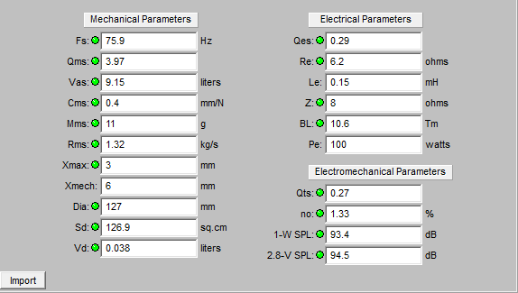

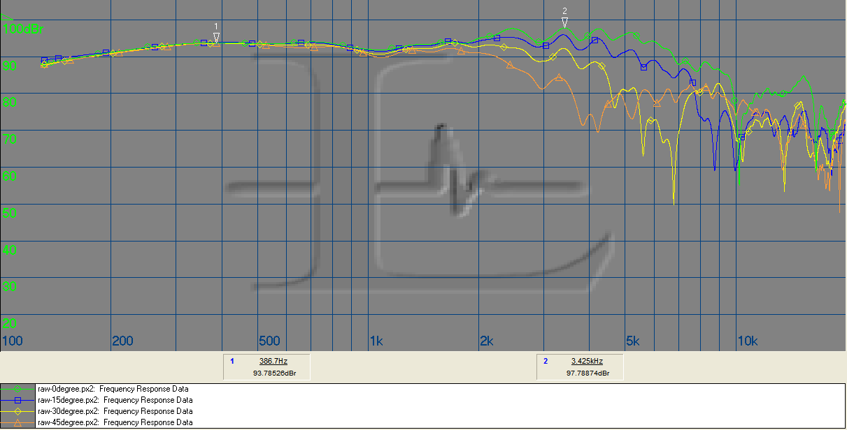

pixelpusher, can you also show data for TD6M, especially FR?
Sure, here is TD6M

This is great! Thank you!!
Either you are a lot convincing than me or AE has shifted gears. I was in touch with them a couple years ago and they were not willing to share data.
That FR confirms my suspicion the TD8M could be crossed at 2kHz nicely to a TPL150H. I'llamame give them a call to think through the combination of impedance and sensitivity - both too low for SETs.
..the combination of impedance and sensitivity - both too low for SETs.
