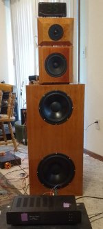

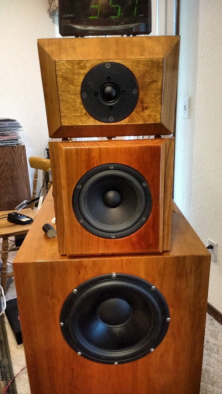

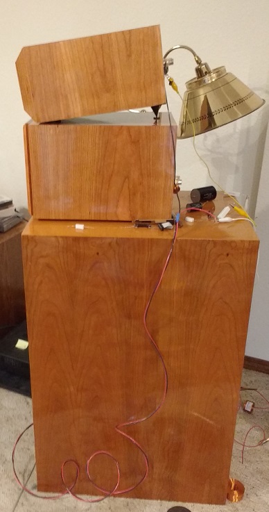

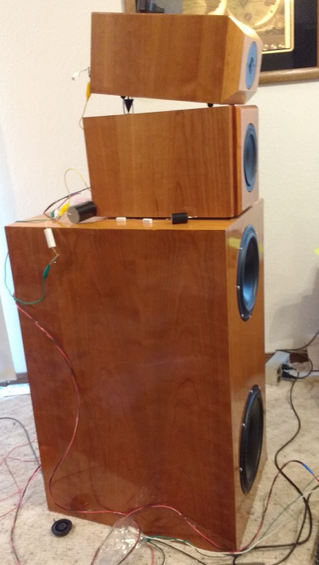

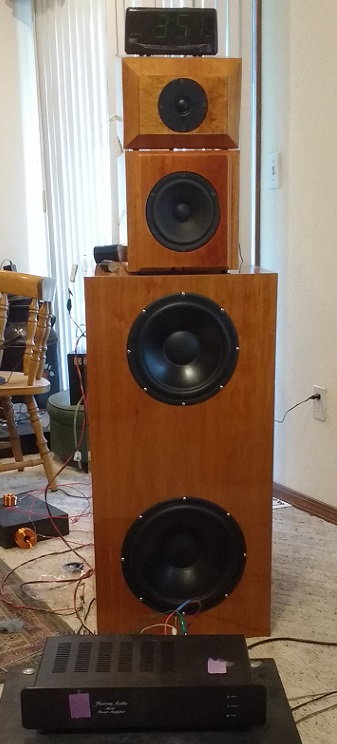

Hey T.O.!! Hope all is well with you and your family. Still want to get up there to scare some fishies.
Let's see if I can figure out all this internet stuff....
So there's a front view, side view, close-up front and side view of the left speaker.
All cherry veneer over 3/4" baltic birch except for the cherry-stained bb front tweeter baffle face and the solid cherry midrange baffle face. Crossover parts all over the place. Time alignment and timing completely adjustable. Cone spike on back of tweeter box to help aim the tw at the listening position.
Doesn't sound too bad for a small system.

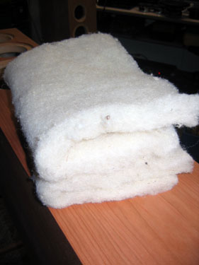

Hi Bill,
Thank you for the quick revert.
I cannot find any pics of unpacked Pellon wool batting. Images that I found are all of the retail plastic bag. There are some pics of rolls, but those are of poly-blended or poly material.
I am attaching a picture on some Monacor MDM-3 (from Troel Gravesen's site)- is the Pellon product similar once you unpack it? What is the approximate thickness?
- Zia
