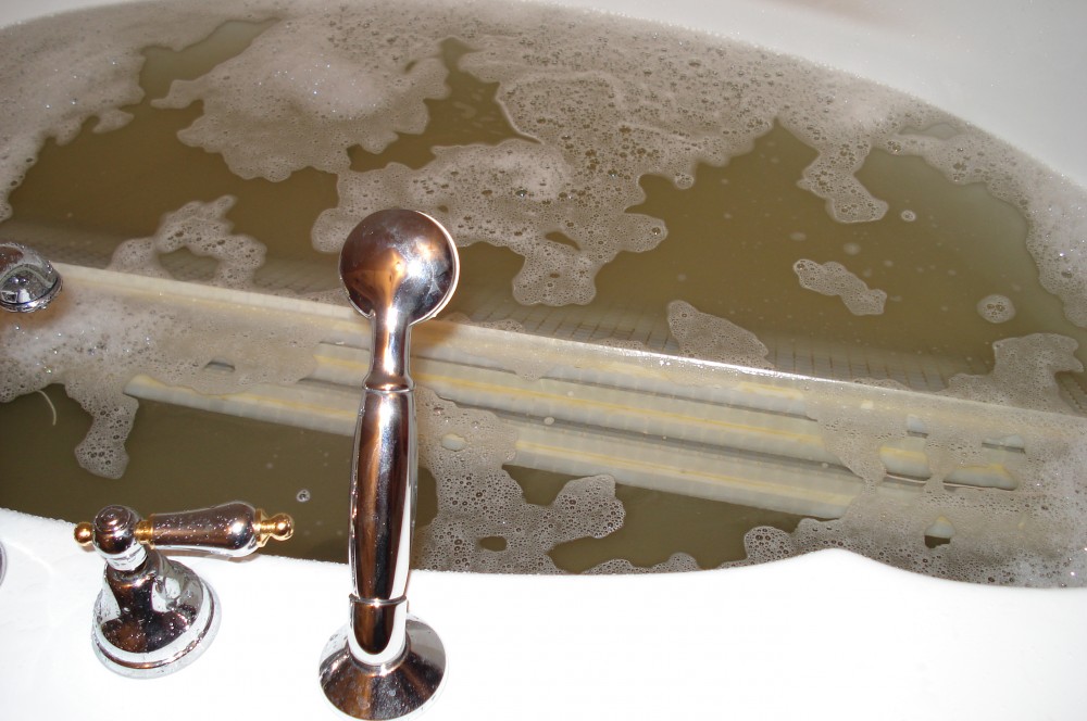

Acoustat panels soaking in luke warm water and very very mild liquid detergent like ( Dawn ) then very important - rinse - rinse - rinse - and rinse again.
Quote:Acoustat panels soaking in luke warm water and very very mild liquid detergent like ( Dawn ) then very important - rinse - rinse - rinse - and rinse again.
This is not good advice. Detergent is a conductor at the voltages used in these speakers. Fact is that detergent has been used as a diaphragm treatment to make it conductive. Do not use detergent on your panels. Best regards Moray James.
Thank's for the warning moray the reason i gave this advice is that this was the way more than a hundred panels where cleaned without any problems tests where done before with different solutions before using diswashing liquid soap.
I hear what you are saying the problem is that you are using a product name which can change from region to region and not be available in others. Detergents contain surfactants and while the product you used did rinse off other may not and not all folks will take the time to rinse enough times. I would say better not to take the chance if you do not intend to test fully. Here again most folks tend to be very lazy and will opt for the least they think they can get away with. So that is my recommendation and folks can do what they like with it. If you have tested and confirmed that you can safely use a detergent (can you measure surface resistance?) then great but if you cannot they I would not recommend the risk. Best regards Moray James.

After I removed the felt strips I used LesToil degreaser/cleaner in warm water and let them soak . Amazing how dirty the water became.Then emptied the tub refilled with fresh water soaked for a couple of hours, repeated twice, then let them dry for a week. Working OK for the past 8 months.

All i can say Atom666, is that you did it the RIGHT way and one more thing the ORIGINAL felt strips had to much glue on them when putting them back just put a little contact glue it will do the job.
