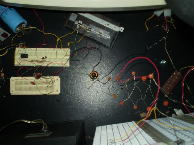

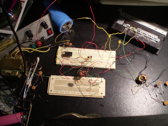

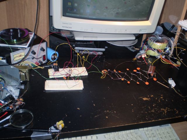

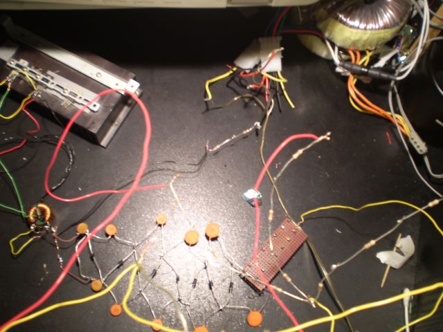

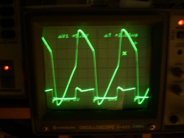

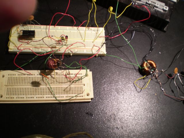

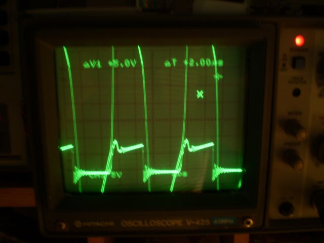

Ger, what does your bias look like? i'm running 2kv, you have seen the pics as i built mine per Charlie's spec and parts list, can you post a pic, we have discussed this via phone, curious as how they look. pic is worth a thousand words.
Here you go! jer

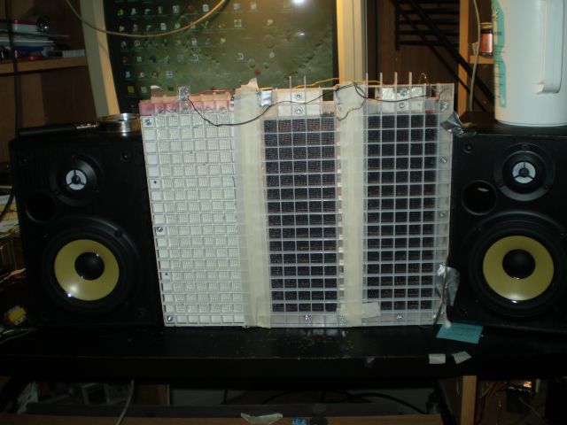

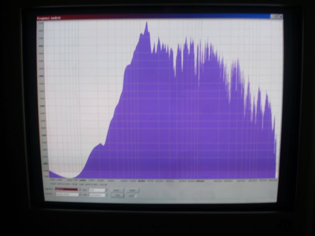

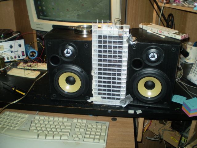

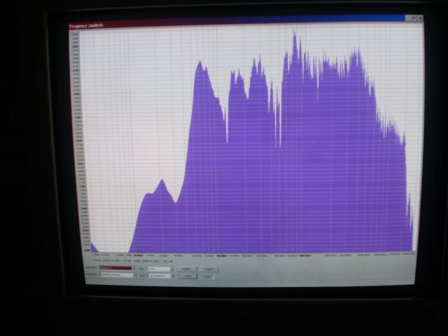

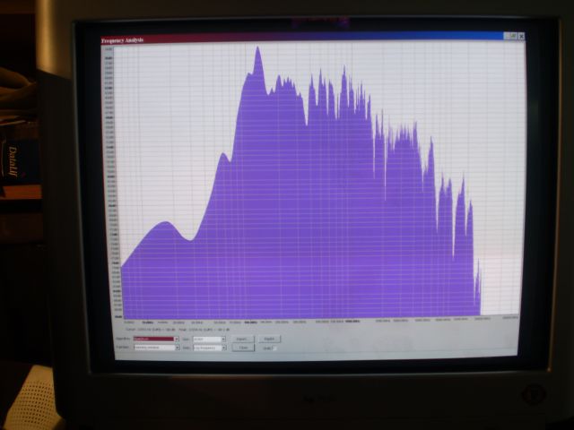

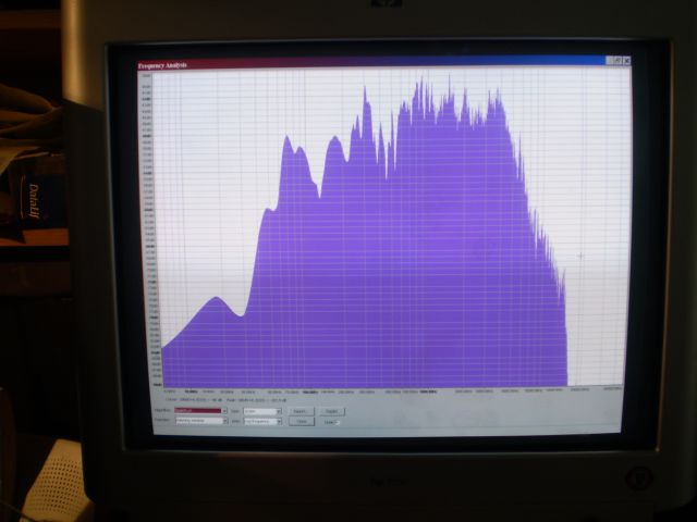

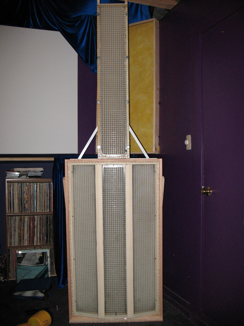

Here is the setup I was working on today.
The response pics turned at to be fuzzy,sorry,stupid camera.
All of the test were done with pink noise and exactly the same power level at 1 meter away.
The power level was at aprox 7Vrms or 20Vp-p the equivelent of 6.25 watts into 8 ohms.
The three panel setup matched and exceded the efficiancy of the box speaker by as much as 3db to 6db.
The single panel seemed to measure not much less than 2db to 4db that of the box speaker but matched the efficiancy at the higher end of the frequency spectrum
Again these were just some quick more controled measurements than the ones I have done earlier.
IMO not bad for a little panel.
I will consider these findings in my next small panel build for a desktop setup.
sorry no spl numbers yet but still pretty impressive.
And yes the added resistors solved the imbalance problem.
MY transformation ratio is confirmed at aprox. 1:216 with a 10 turn primary on each core connected in parallel and the four 120v windings in series.
With a 1v peak to peak 500hz signal on the primary and a measured 216v peak to peak across the four 120v series tied windings
Also I had forgot to block off the tweeter in the combined test . jer
