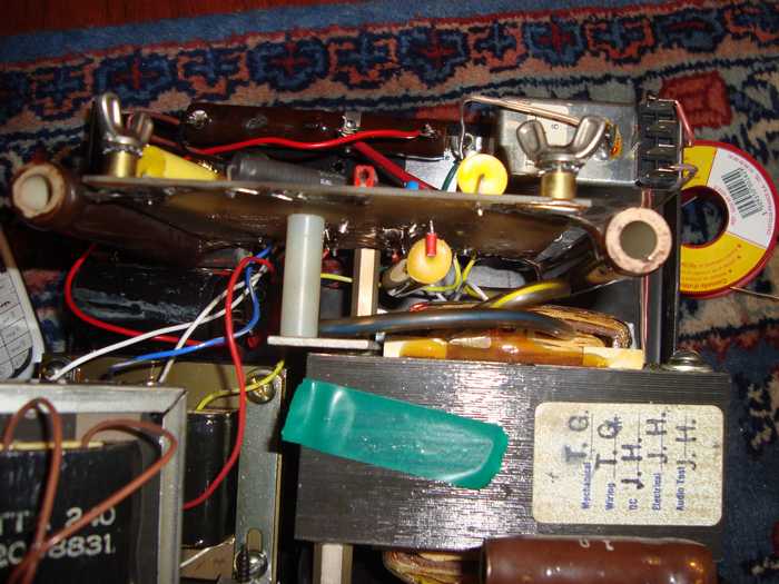

Do perform the "C Mod", regardless of possessing "Medallion" transformers. First, replace all of the high voltage disc caps on the voltage multiplier board.
I see that some had questions pertaining to the physical mounting of the other components. The following pictures demonstrate the method I utilized to mount the capacitor bank (Solon, Mundorf, and Russian Teflon) on two, quarter inch thick phenolic boards.
Mounting screws were added to the top and painted black to camouflage them. The only visible alteration to these beautiful speakers is the Vampire brand speaker binding posts replacing the original, pitiful binding posts. These were never up to the quality level of this classic.
This Photo shows the mounting of the added resistance and wiring changes utilizing Teflon insulated silver and (I think) DB brand Teflon insulated copper.
The Mills resistors, like the capacitor bank are paralleled, with each component measured and matched to achieve the most accurate left/right identity. Many will consider this useless or overkill but this is my hobby. It may seem senseless on a production run of 10000 units but this is the only pair I'm doing and to ignore this minute detail would, to me, be unthinkable.
The final result was neither small nor imagined. I will not go into the magical, musical changes that I heard. Be it the circuitry alterations or the replacement of very old electrolytic capacitors with new film types ...
Perform this Modification!!!

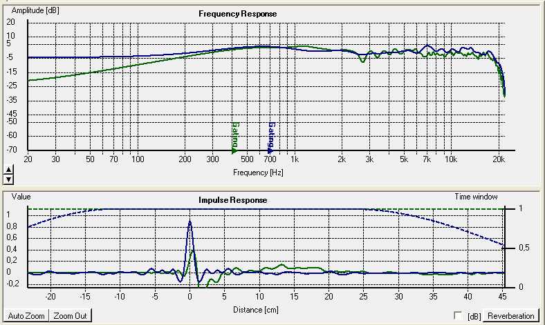

I own Acoustat 1+1 since 10 years and I love the sound and design.
But I'm not satisfied with the overall stereo image and sound stage.
As comparison I owe old magnepan 3 in an active configuration, which have less transparency and dynamics, but give a lot larger and deeper stereo stage.
In the upper frequency the sound of the Acoustat comes 'from the speaker' and not from behind them as with the Magnepan. It makes the listening a bit tiring. I would call this 'too much directivity in the upper mids'
The curves herejoined represent the frequency response of both speakers in similar conditions.The 1+1 are blue and magnepan are green. Only the impulse response shows a significant difference : 1+1 shows larger dynamics, the facts are very impressive...
I do think that there is something wrong somewhere ...

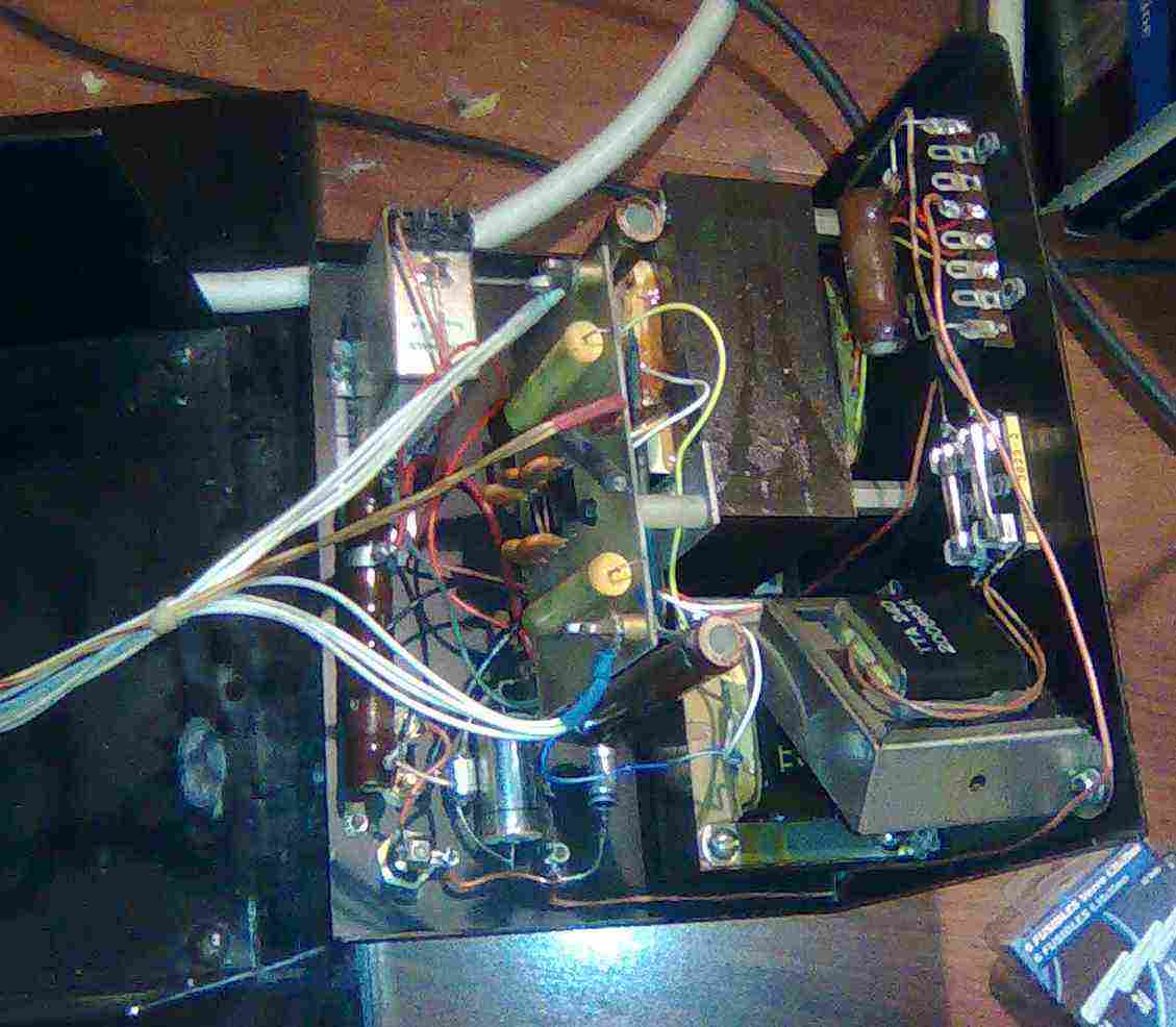

Here are also a photo of the interface.
Since this photo, I changed the electrolytic cap, the yellow caps, and the high tension ladder diodes and caps. It improved the transparency of the sound, but the stereo remains focused on the speakers.
Can you confirm to me the values of the high pass filter caps in the MK121 interface ?
Is there something I should do to improve things ?

Acoustannoy, I followed the "C Mod" pretty closely. The bank of capacitors shown is composed of:
(1) A Solon 47mfd. Film.
(2) A Solon 10mfd. Film.
(3) A Mundorf 1mfd, Film.
(4) A Mundorf .1mfd. and
(5) A .01mfd. Russian Teflon
Please keep in mind that there is resistance added along with a slight (but significant) circuit modification.
I'm hesitant to say this but I've never heard a Magnepan setup that I would prefer over these 'Stats.
It could be speaker location, supporting electronics, room acoustics, or just personal preference but these were very good before the update and magnitudes better afterward.
I highly recommend these changes!!

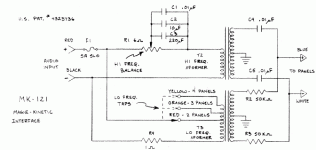

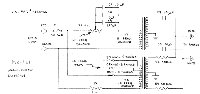

Bobzilla, the total value of the cap bank you use is about 58 microfarad.
The original MK121 interface is given for 230 microfarad (picture).
What is wrong ?

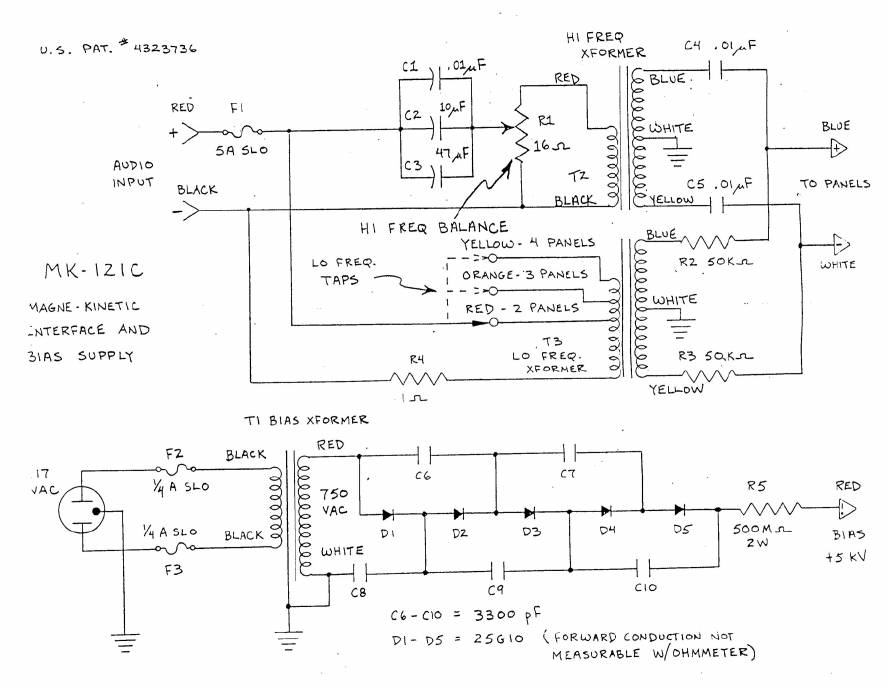

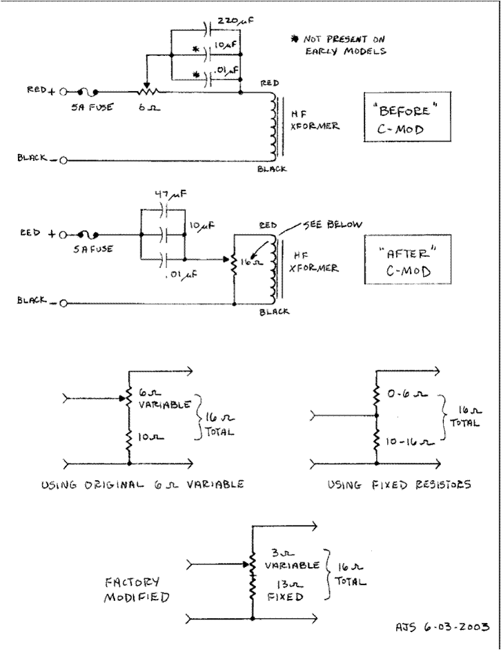

Hello Acoustannoy,
There is nothing wrong. The original MK121 interface did use 230uF as the schematic you posted shows.
But, the C-mod uses 57uF as shown in the attached schematic of the MK-121C interface.
See also the upgrade sheet Andy Szabo(aka AcoustatAnswerMan) posted some time ago that neatly summarizes several resistor network options when adding the ModC to your MK-121 interfaces.

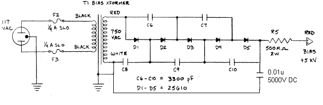

I had the most impressive improvement today, through the addition of the cap as recommended on
Izzy Wizzy Audio
Izzy Wizzy Audio
(sketch herewith - the 0,01microfarad 5000V is a yelow polyester cap)
Modification is easy to do, and for the first time I had a significant improvement of the stereo image in the two directions : it is broader and deeper, the sound does not stick to the speakers as before ! Female voices are impressive.
1- I highly recommend this mod
2- I don't understand the technical reason
3- what can be done to go even further ? Does increasing the cap value makes sense ?
Mathieu

For the Izzy Wizzy high voltage mod, I added a .022uF 6000 volt Wima polypropolene capacitor to the high voltage circuit in each interface. It had the same effect you described for your .01mfd 5000 volt mod.
I also replaced the 500 MegOhm resistor with a 20 MegOhm one in each interface. The speakers now play a little bit louder and seem to be more dynamic. I remember reading that this mod increases the high voltage to the panels.
The smaller interface cases on my 1+1 speakers do not have enough room for large capacitors such as the ones that Bobzilla used. So I used two Solen 28mfd polypropolene caps for a total of 56mfd. For a bypass cap, I used a .18mfd Jensen paper-in-oil cap. I prefer it over the stock .1mfd polystyrene bypass capacitor.
The improvement in sound was immediately obvious to my friends who are not into audio at all. They commented on the better sound even though I did not tell them that I had modified the interfaces. The speakers are much more relaxed to listen to. I hear more detail. The sound does not "stick" to the panels as much as before.
I also did these mods to a friend's Acoustat 2+2 interfaces. He was happily surprised.

Also, be advised that the added 0.01uF capacitor charges to the full bias voltage and will store considerably more charge than the unmodified HV supply. So, be carefull and make sure the capacitors are discharged before performing any additional work on the supply.

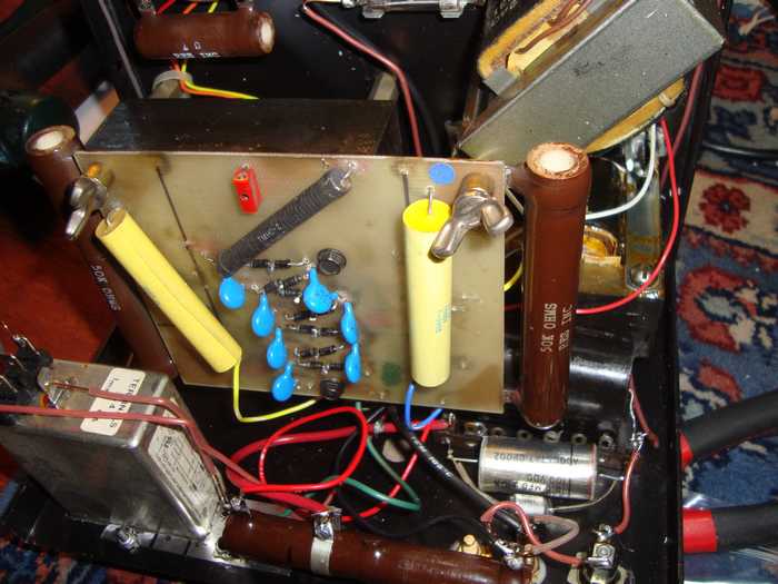

The old 1+1 never sounded so good in 10 years. Here are photos of the interfaces. You can see
- the modified 47mF cap (I kept the original 10mF and 0,1mF ones
- the additional HT ladder step (caps and diode were changed)
- the additional 0,01 mF/5kV cap.
The wiring is not very professional, and the variable resistors are burnt at some places...

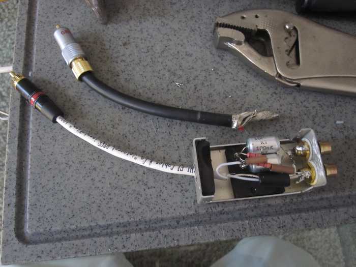

a. I put also photos of the 'Active-passive' filter which is located between the preamp and the amp.
It is a 6db/oct on the photo, which was modified into a 12db/oct.
Such filters give astoning good results in terms of dynamics and transprency. I changed all my active filter stuff against this solution.
Design is done with help of the Micro-cap simulation software.
...To whom it may interest, I designed also such a 2way 12db/oct-18db/oct filter for my Magnepan IIIa, with incredible dynamic results, without any loss of information.
