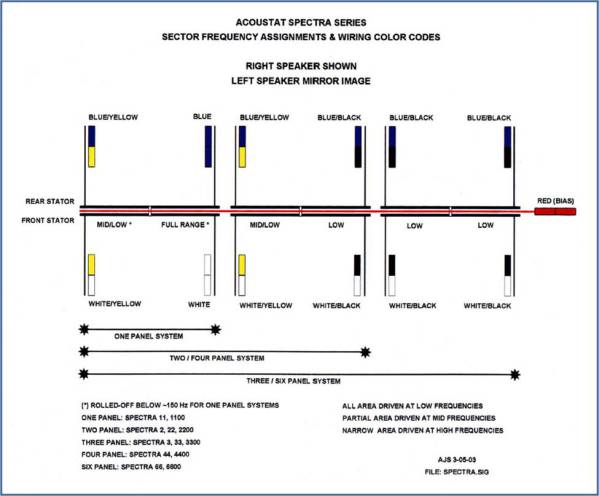

I remember seeing a diagram showing the frequency ranges supported by the four "segments" in the 22s.
For the Spectra 22 I am currently using for the right channel it seems to be (looking at the front of the speaker):
UL: MF + LF
UR: Full range
LL: LF
LR: Full range
Should I try swapping the left and right speakers?

I don't understand your designations, but what you should hear on the right speaker is the full range segment (where the high frequencies come from) as the second segment from the left edge, as viewed from the front. Conversely, on the left speaker, you should hear the high frequencies coming from the second segment from the right edge of the speaker, as viewed from the front.
If you don't hear the high frequencies as described above, you may have connected the panels incorrectly to the interface. Make sure you properly distinguish the blue group of wires from the white group, and then follow the color coded wires and corresponding terminals within each group. Failure to have the panels wired correctly may result in frequency imbalances, as well as imaging irregularities.
Look here...you may have this....Spectra stock setup
All Acoustat are on 24/7...less unpluged.
Some may say 22s have, over ripe bass...all 4 panels play bass...I have the Spectra 3 an 11s....have fun
Thanks for posting my Spectra segmentation drawing. I don't have it handy where I am right now. It's a good explanation of the arrangement and color-coding of the sectors in all the Spectra models.

Look here...you may have this....Spectra stock setup..have fun
Thank you tyu for the diagram. That was helpful. I have not seen a planar speaker organized this way before. Assuming the segments are physically identical, experimentally re-ordering them should be easily executed via wire swapping without changing the loading on the audio frequency taps.
