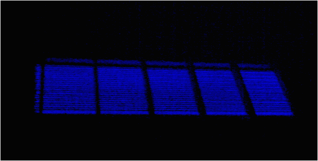

Where are you seeing the blue glow?
Is it the straight sections of the wires? or just on the ends of the wires where they loop around the pins. I have only seen blue glow pulsing with the music when I was intentionally overdriving the Acoustats to test for threshold of air-break down which occurred at a bit over 35Vrms for frequencies < 200Hz where the LF transformer defines step-up ratio.
Attached is a pic I took(not Acoustat) showing what I am talking about, blue corona discharge when air is conducting in the gap.
Pic was taken with steady sine wave so camera would capture.
More info here:
http://www.diyaudio.com/forums/planars-exotics/246846-first-time-esl-builder-7.html#post3764641
If I remember correctly, you live near the coast?
Perhaps moist salty air promotes the corona at lower voltage levels than normal.

I have observed glowing wires, BUT not inside the panels themselves. The only place I've seen this occur is along the run of wires up the rear of the speaker, where the front and rear stator wires are bundled together. This is why on the Spectra models, we changed to running the front and rear stator wires in separate PVC jackets, to keep these highest-potential points away from each other. Worked like a charm, although we never attributed any real problems to corona-glow.
Furthermore, these corona observations have occurred only under very high drive conditions, bordering on over-driving, and only visible in a completely darkened room. Of course, this phenomenon is more easily observed on smaller speakers, where drive levels are higher for a given SPL output, and bass equalization is greatest.
