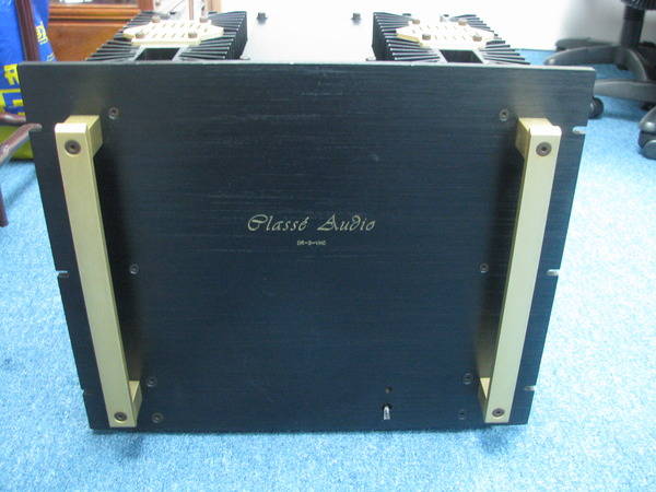

Interesting. Well, that'll be an easy enough experiment to conduct. Kevin, who rebuilt the interface units, has a Hafler XL-600 that will push the ante up to 450wpc that he's offered me to try. Surely that's adequate power for the 22's...surely.
It is NOT the quantity of watts it's the QUALITY, i drove mine with this 45x2 watts for 13 years but it was a pure class A.
