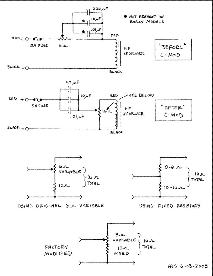

The Acoustat C-Mod was NOT just a change in capacitor value. The high-pass filter feeding the HF transformer changes from a series network to a series/parallel network, resulting in a smoother roll-in and less chance of core saturation. Merely changing the capacitor value will NOT give you the C-Mod, and doing so is not recommended. The resistor values and network configuration must also be changed.
While it is true that the LF transformer does not have a low-pass filter associated with it, it does not really operate full-range due to its natural roll-off.
Schematics and instructions for the C-Mod are available from www.audiocircuit.com. Note that doing the modification is beneficial for both original and Medallion transformers: they are independent changes. The parts required are commonly available, and the instructions provide several options for creating the new HF Balance Control. The 16-ohm slider resistor required for interfaces so equipped may still be available from eBay seller Soundvalves, who bought most of the obsolete Acoustat parts inventory from Rockford. If not still available, the instructions provide a way around that.
One nice thing about the C-Mod is that the 47-uF capacitor is much easier to upgrade to a film-type, as compared to the original 220-uF (huge AND expensive!)

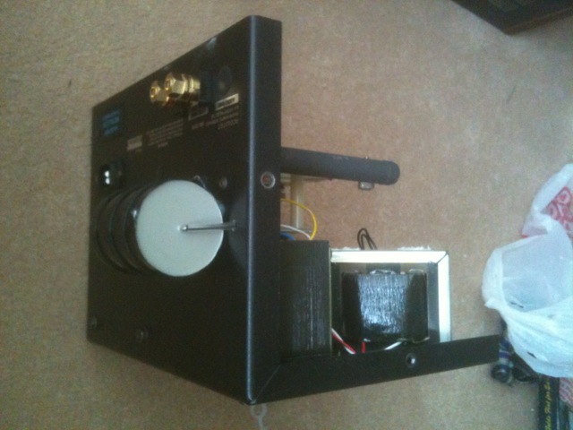

The picture shows the inside of my Acoustat Red Medallion C interface with the new Solen 47uF capacitor in front. It looks like the new capacitor (bottom) will fit either in front of the circuit board on right side, or above big transformer in back. There's more space in back, but nothing convenient to support the capacitor with and a long lead would be required, and there's high voltage back there. I'm leaning toward front installation.
In front, the capacitor could rise straight from where the fuseholder is, or lie flat above the fuse and two speaker terminals. Either way space is very tight, and one concern is that the capacitor would be very close to the 50K power resistor. If the resistor gets hot it could damage the capacitor, and there is high voltage on that resistor too. I might be able to give it "just enough" space, it looks like I could give it about 5mm space. Opportunities for support are also limited, but it would be somewhat self-supporting from it's own lead, so doesn't need that much additional support. If it falls "down" in operation it simply hits the wood base of the speaker. where the interace is installed.
I could possibly bend the power resistor out of the way, bit by bit using one or two sets of longnose pliers. The danger is that I could break it off it's solder pads, or, even worse, crack the old circuit board.
Another thought crosses my mind too. I could connect the capacitor BEFORE the fuse, so the capacitor effectively bypasses the fuse for the high frequencies. The speaker would still be protected from DC and low frequencies, which is likely where any problem would be. The fuse doesn't really do a great job of protection anyway from sustained loud music, sustained loud music can burn the transformer without melting the fuse. The fuse mainly protects against amplifier failure, and also provides nuisance warnings that you are playing too loud.
I could also have the capacitor outside, either as an independent entity (with new input terminal) allowing easy changes, but clumsy and space consuming, or strapped to the case with twist tie (requires new holes in case, not easy) or glued (ugly).
I might suggest two options, either or both of which may ease the difficulty of mounting the 47-uF film capacitor.
The first would be to find a capacitor with a lower voltage rating, which would likely be smaller in size. You could also use two smaller values in parallel, which might open-up further mounting possibilities.
The second would be to use self-adhesive pads designed for securing cable-ties. Find a spot on the rear surface of the chassis, mount the tab, run the cable-tie through it, and secure the capacitor to that. Using the self-adhesive pad avoids any need for drilling holes in the chassis. I have used a similar technique in my Spectra's (which admittedly have a little more room available).
That is a great idea Andy about the cable tie mounts. There are mounts like that that also only need one screw if adhesive was not enough.The second would be to use self-adhesive pads designed for securing cable-ties. Find a spot on the rear surface of the chassis, mount the tab, run the cable-tie through it, and secure the capacitor to that. Using the self-adhesive pad avoids any need for drilling holes in the chassis. I have used a similar technique in my Spectra's (which admittedly have a little more room available).
For those who read schematics better than they read words, here is another set of great circuit diagrams from Andy depicting what he just posted in words.
