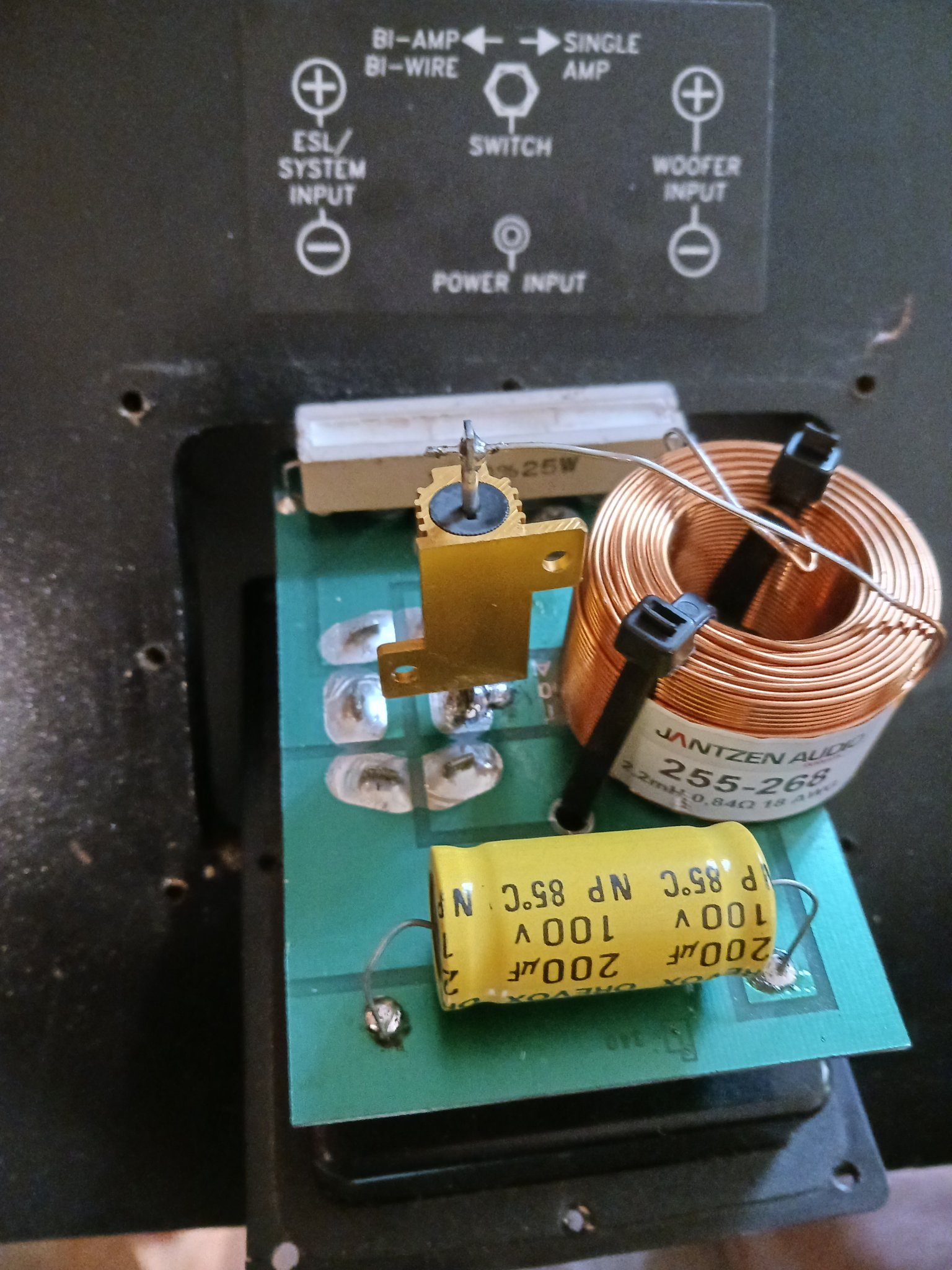

Inductance is probably close enough (2.2 vs 2.3 mH) but you may find the need to put a 0.5 or 0.6 ohm resistor in series with the coil to reduce the woofer level. It depends on your tastes, really. Resistor should be rated at least 20-25 watts, and mounted so it has some free-air ventilation.
Got the crossovers rebuilt. New inductors and caps. The 200 uf caps were waaaay off. They measured 280uf and 281uf. And one of the old Inductors was melted & probably shorted internally. I did add a 1 ohm resistor to the inductor. So should be an spec now. Sounds soo much better. Thank you for the help!

That was quick! I might suggest a better securing of the resistor body. I would be concerned about vibration/stress cracking of the solder joint where the resistor is connected to the PCB. I realize there isn't much room to mount the resistor, nor is the plastic input cup suitable for mounting due to the potential of heating of the resistor. Time to get creative!
