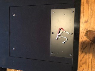

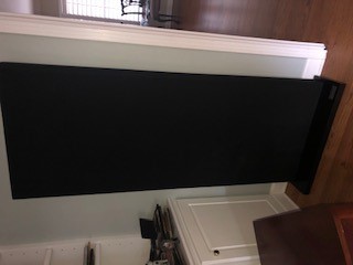

model 3 back panel
I have the Model 3 that is 70"x28". On the back there is an upholstered panel I can't remove. I removed all of the screws and I can pull it back a half inch or so, but it's still attached somehow.
Anyone know how to remove this panel? thank you,

Those are actually model Three/M. This was also available with a woofer as a Three/MH. That panel was to attach the woofer to.
https://www.vintageshifi.com/repert....php?pdf=Acoustat-Model-3-M-Owners-Manual.pdf
Based on the manual you linked it does look like mine are the 3m and likely utilize the same frame as the 3mh but without the woofer option. (Thanks, I never knew why mine were taller that the other 3s.) The woofer would then attach to the space now occupied in my speaker by a black upholstered piece of mdf or plywood. To that piece my interface is attached.
I reviewed the manual and don't see in the description of the 3m or 3mh how to remove that panel. I'm guessing that when delivered as a 3m, the black panel is in place and when delivered as a 3mh it is not attached, as the instructions don't mention removing the panel to install the woofer.
I still need to remove the panel because unfortunately one of the t-nuts that holds an interface screw pushed through and is now rattling around the bottom of the cabinet.
Sure I can remove the cloth top to bottom but that's a huge endevor.
I have not tried removing the bottom base - I wonder if the bottom of my mysterious panel is attached to the base somehow. Any ideas? thanks again,
