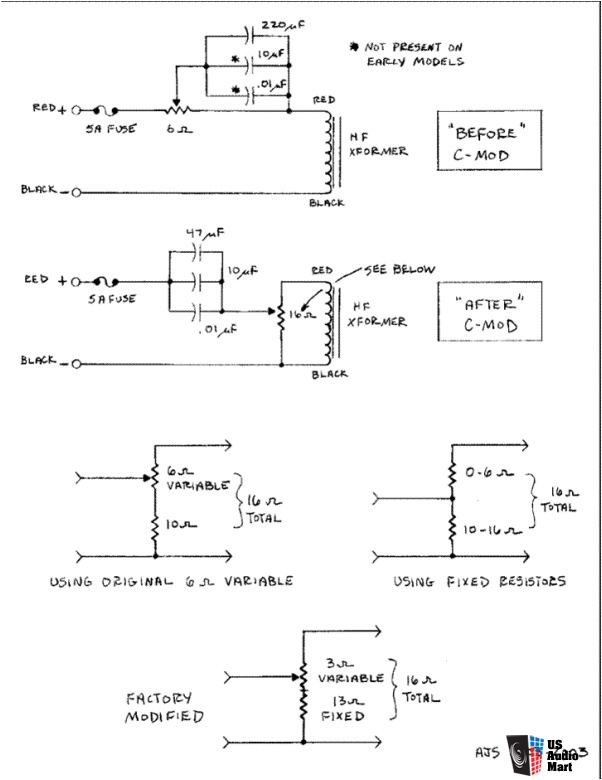

"A BLUE medallion label indicates the original Medallion transformers. This was an expensive modification. A RED label indicates Medallion transformers plus the C-Mod. The C-Mod was relatively inexpensive and is easy to do after-the-fact using commonly available parts. The C-Mod can also be done to non-Medallion interfaces with the same positive results."
Did your BLUE interfaces have the "C" mod done? If not, these would be a step up, but as Andy states above, the "C" mod can be done pretty inexpensively.
