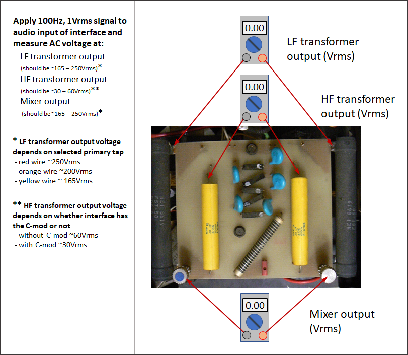

Do you(or a tech friend) have access to a signal generator you can hook up to the amplifier driving the speakers and a DMM(digital multimeter)? If so, I would recommend measuring the output of your HF & LF transformers and the mixer at 100Hz. Based on what you measure, the fault should be narrowed down to the mixer parts or a particular transformer.
With the interface unplugged from the wall and the wiring to the panels disconnected, apply a 100Hz signal @ 1Vrms to the audio input binding posts using signal generator and power amplifier. If possible measure the voltages on the “good” interface before the “bad” so you know what to expect. The voltage values shown in the attachment are ballpark numbers, but they won’t be far off.
Let us know what you find out.
