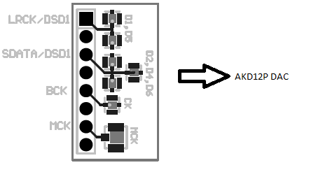

Regarding the fanout, I figured the data lines should be able to drive 3 inputs if it works correctly with the Buffalo 2, since it internally (as in on the PCB) connects several inputs together. Basically, what I want to do is this and if I understand Dustin correctly here the only way to support I2S/DSD/SPDIF that way is to short D1 to D5 and D2 to D4 to D6 since the internal switching do not cover this. Since I don't want to hack into the ackoDAC PCB I thought I'd do it externally, but really, the result should be the same.
fanout
This should work fine. It is the cable capacitance the would affect the drive from WaveIO so keep it as short as possible. Of course each input has its own 'gate' capacitance. Combining inputs (on-board or externally) increases the effective capacitance so a buffer after WaveIO could be useful especially if you are looking forward to dual mono fanout
Remapped Connections I2S/DSD
Thanks acko. Should I worry about trace impedance and reflections?
It is best to used a small adapter with all the w.fl coax connected as shown. Then use a short length of w.fl cable assy from this adapter to DAC
Can be made to match the type of transport used. Shown is for SDTrans384. Others similar. What is your transport?
Edit: LRCK/DSD1 should be LRCK/DSD2

I'm planning to use the WaveIO (which uses u.fl for I2S), but who knows what the future holds...
The (current) design of my PCB is very similar to your picture, apart from being modular, i.e. 1 input u.fl and footprints for 3 output w.fls per PCB. Maybe I should make it a one PCB solution like yours, as this will be neater and there's no need to connect resistors to ground on unused connector footprints to minimize reflections.
I thought I'd be clever and save money on manufacturing as few PCBs I don't need as possible, but all things considered, maybe it's not such a good idea after all. Also, the additional cost will be quite small considering the cost of the rest of the build :)

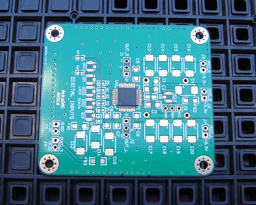

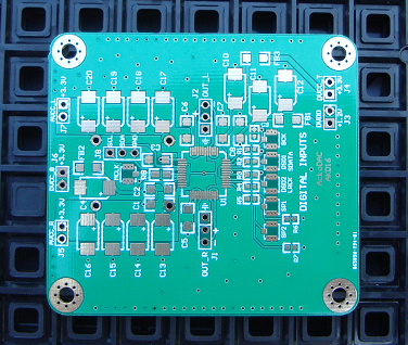

AKD16 Re-release
There has been some updates to this 9016 DAC board. New version has inputs re-mapped for stereo I2S/DSD and 2CH Spdif (TTL). Board layout has been further improved and now with U.FL coax for direct connection to popular transports. Available as bare boards and chip mounted options.

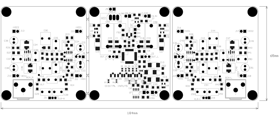

9016 DAC Combo
Some updates of on a complete DAC system based on 9016. This combo board has both DAC and IV cct integrated as shown. Shown panelized with the options to detach IV and re-mount/stack if desired.
DAC side has LDOs for both digital and analog side and can be powered by a single external 5V-12V supply. Analog AVCC has mounting options for 3-term shunt regs or similar.
IV stage requires symmetrical supplies (+/-5-to +/-15V). Both SE and Balanced outputs. Clock and controller are external-TBA. Physical board will be available in ~4wks

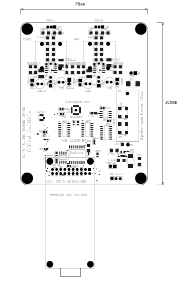

Oh, Amanero Combo384 is perfectly integrated into the DAC!
By the way, would you inform us which frequencies of synchronous master clocks you assume?
Yes, I am trying to see if Zero DPLL_BW lock can be achieved by this tighter integration. Obviously there will be no more interconnect signal/clock cables and capacitance to worry about... Amanero's flexibility makes it the best choice for Full Sync mode but other transports could also be used and inputs will be provided.
Sync frequencies are 98.304/90.3168MHz from possibly a custom build XO module this time for further enhancement.
Digital section will all be fully assembled and tested. Options for power supplies of choice and final build (space permitting) could include on-board controller and digital Volume.
