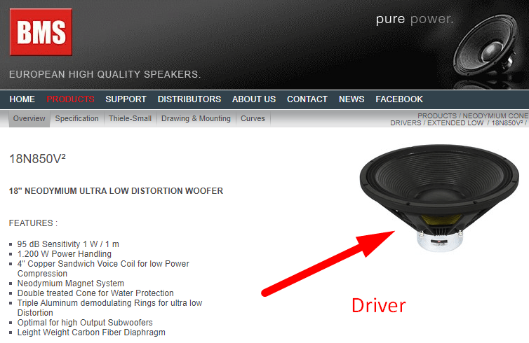

Now i´m searching a new chassis for the Achat ant wanted to ask u guys if you have a Chassis that you would put in the Achat instead of the original, or would you use the original?
https://www.thomannmusic.com/the_box_speaker_185008a.htm | So that's the original Chassis that is build into the Achat on delivery.
Now i´m tinkering if i should the original chassis from above or something like this: https://www.thomannmusic.com/turbosound_ts_18sw700_8a.htm

Replace the driver with the original, sell the box, and look for a different model subwoofer(s) capable of reaching lower.
Or replace the driver, buy an additional Achat 118 for more output, and accept the compromise in low end extension.

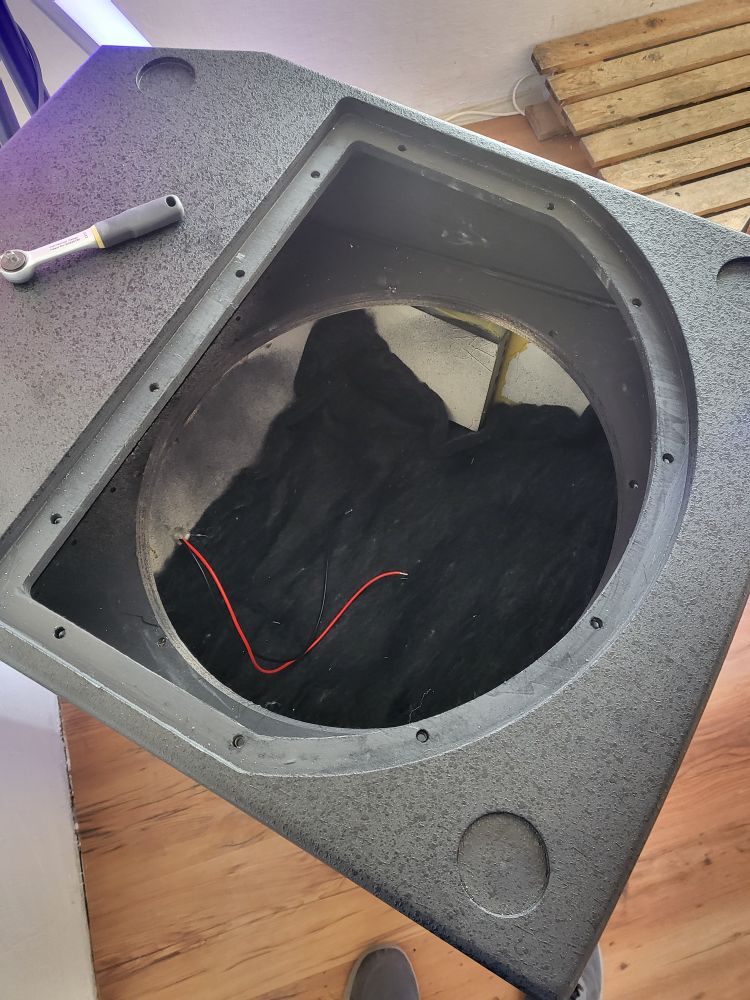

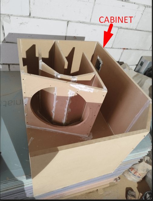

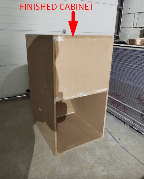

Btw, I looked at your link and the cabinet is a horn design , I am puzzled what type of horn
Can you post some pics of the internals? With the driver removed?

Edit: And for the internals, unfortunately i only have that picture:
Edit2: Afaik the 18" layed in a Housing completly closed with the Cone looking to the Top and a plate with idk 10° and a small vent at the end.

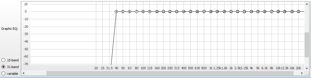

are you using analog or digital cross over?
what is the make and model of your crossover / processor
what is your Low Pass filter settings ?

we do not call the drivers chassis ... chassis is the metal frame of a pickup or car... or the mount plate of the PCB boards on a power amplifier
so we call the actual cone with the spider.coil, suspension etc
the Driver.... and the wood enclosure is the cabinet...

what you did in your APO is for now but
you need a HIGH PASS at 35Hz LR 48db at least 24db Slope to be safe
play some 40hz test tone... then a 35hz test tone,,, then a 30hz test tone
if your APO cut is ok , you must hear good 40hz... weak 35 and almost none or none at 30hz
if you still hear strong 35hz and 30hz move the cut on your APO higher
and try again
