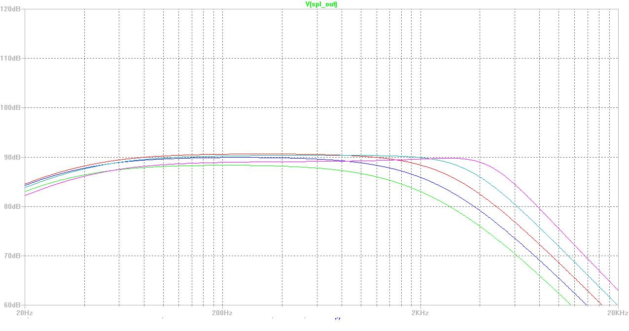

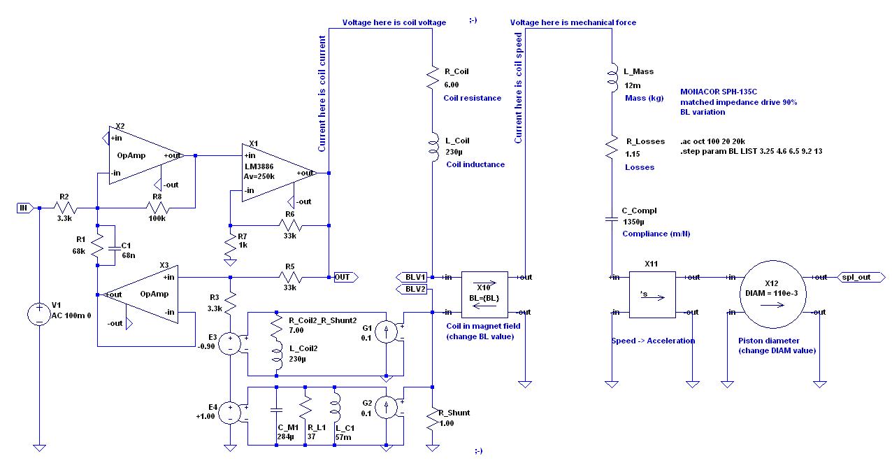

Here are the LTspice simulations. Please read the .pdf.
  • Matched Impedance drive 90% LM3886 plus Opamp flat - BL variation (curves).JPG
  • 0 - diyAudio Matched Impedance Drive.pdf

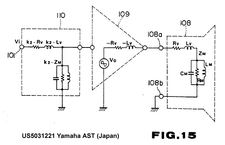

Wow, I thought everyone had forgotten about this. I read about it years ago but never saw anything come out of it. Looks like it is time for re-reading.
Like you I remember having read something about the "Matched Impedance" drive. Now I'm asking myself from where I got the idea of the "Matched Impedance" drive. Can you please help me finding publications about it?
Today I went digging Wireless World, the AES publications and the US patents, and could not find a single line about the "Matched Impedance" drive arrangement. I read more than 100 publications. None of them explicitly exploit the "Matched Impedance" arrangement. Some US patents like the Yamaha AST patent US5031221 represents in fig.15 the negative LR and parallel positive CRL networks, but even doing so they avoid talking about the "minimal loss" theorem when the transmission medium gets impedance-matched, thus they omit the crucial BL independence considerations. They may do this on purpose, for not disclosing the most interesting feature of such arrangement.
Most patents I saw looked like revamped Voigt bridges and Maxwell bridges. I did some more LTspice simulations. Using simulations, a Voigt bridge or a Maxwell bridge translates into a "Speed-Follower". This means that with a Voigt bridge or a Maxwell bridge 1) the frequency response gets easily extended in the deep bass (1st-order lowpass -3dB at 20 Hz if you introduce the required -6dB/oct equalizing function), but 2) any BL nonlinearity will be reciprocated and certainly not cancelled.
Using LTspice, I found a very simple modification to be applied to a Voigt bridge or Maxwell bridge for improving them quite significantly. With such simple modification, the system tends to operate from 100 Hz to 1000 Hz as "BL invariant" with a reduced 1st-order sensitivity to BL. That's quite interesting and may explain why only a few commercial Voigt bridge and Maxwell bridge based systems could deliver both the promised deep bass extension, along with some useful THD reduction.
A nice idea would be to simulate the ACE-Bass and determine if, correctly adjusted, it tends to operate on an decent frequency bandwidth as "BL invariant" with a reduced 1st-order sensitivity to BL.
Here are the .asc files in a .zip

The impedance of the power amp does not matter if you use the inverting amp in front of it and raise the input impedance to at least 100k, and as we discussed the gain in the inverting amp should be at least 10, for the combination of the inverting amp and the power amp to work more closely as an ideal opamp.
I tryed myself to change the 2 resistors R12 to 1M and R15 to 100k in my setup (see schematic post #26). First it made a really bad noise when starting up .... had to turn it off right away. Then changed R12 to 100k ... this resulted in sound but 1V DC on the output ... then I gave up for now ... cant really see why there is DC on the output as there are coupling capacitors all around! .... will investigate and try another power amp one of these days :) ......
@steph_tsf there is no doubt that AceBass will reduce distortion, and can be considered a kind of servo.
Best regards Baldin
