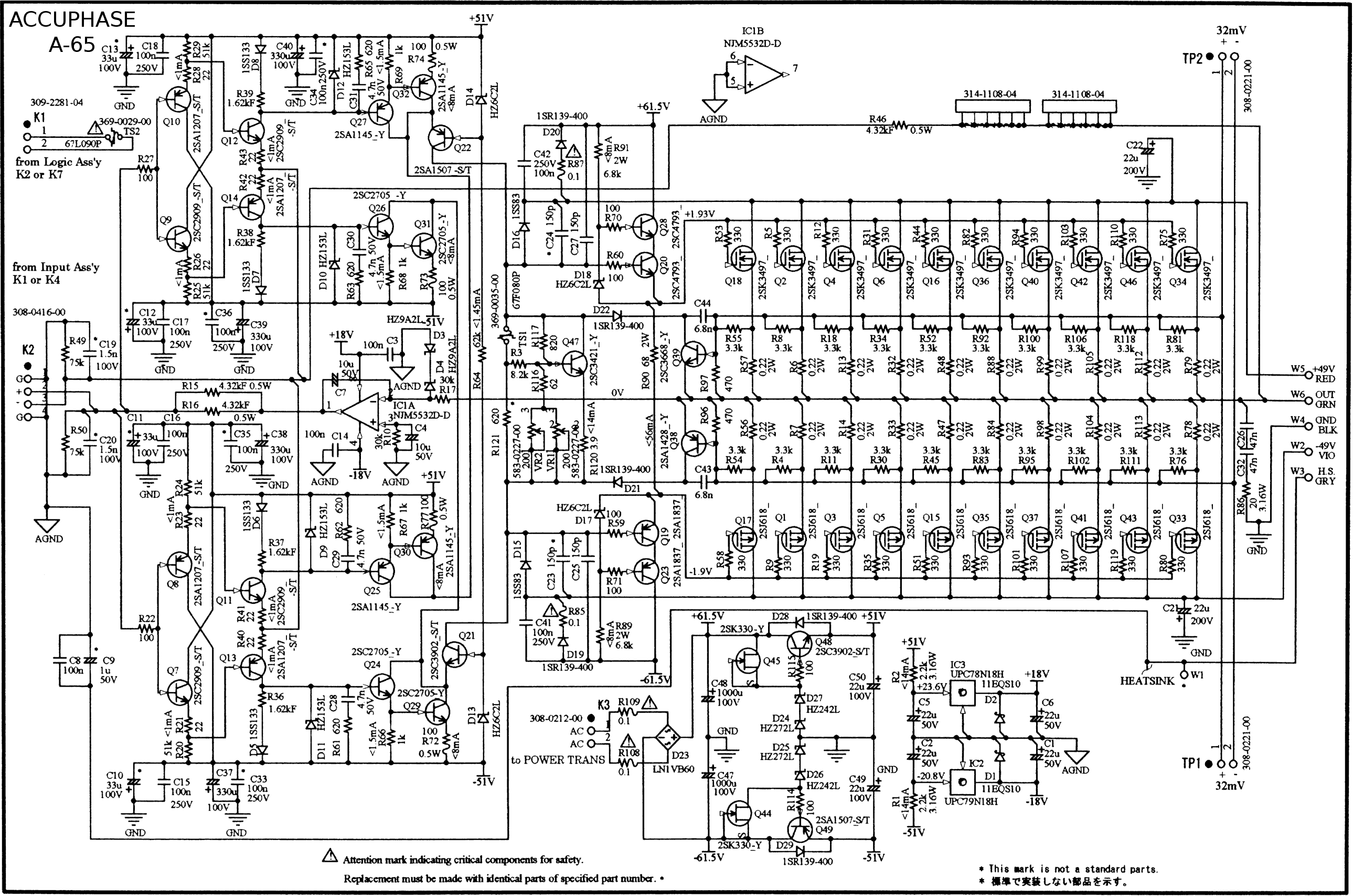

Lazy, I think we are saying the same.. One input rail to rail for the posetive input, and one for the negative, Then they are summed at the VAS. Ohh I see what you mean, both are driven by the same input, the other is then used as a reference.
Difficult to interpret the feedback ??.
Two front-ends with paralleled inputs and paralleled VAS outputs - this is something Accuphase used a lot.
In one (or maybe more) of their amps - I don't remember the exact model at the moment - they even used three front-ends in parallel. 2 channels = 6 front-end modules :eek: Worth trying to build some simple CFA front-end and see what effect paralleling of 2 or 3 of them gives in terms of noise and distortion, with practical measurements ;)

Interesting, that the front end running from+/-60V and the output stgae from+/-75V. It means lot of heat loss...
Sajti
I was thinking about lowering the voltage of my front end also. My rational is keeping the collector base voltage of the power transistor at least 10V to keep the CCB low.
What is the power output of this amp. Why keep the rail voltage so high? So many output transistor!!! Are they running at very high quiescent current to keep the amp running in Class A in lower volume?
The emitter resistor is 0.47ohm. So if they follow Oliver's condition RE=re', then each transistor is biased at 50mA. 11 power transistor implies quiescent current of 550mA.

It can be traced back to their mission: Accuphase was formed by a team of designers from Kenwood that wanted to make audio gear without unnecessary compromises and penny pinching. They used so many output devices in the P-7100, because that amplifier was designed to deliver a straight power curve into any impedance that it would encounter. The P-7100 was around 135W into 8 ohms and 1000W into 1 Ohms. It isn't needed, because all of the speakers that approached 1ohms are obsolete; none are made that way anymore. However, it is without compromise and if the owner wanted to run multiple speakers from one channel, he or she could.
