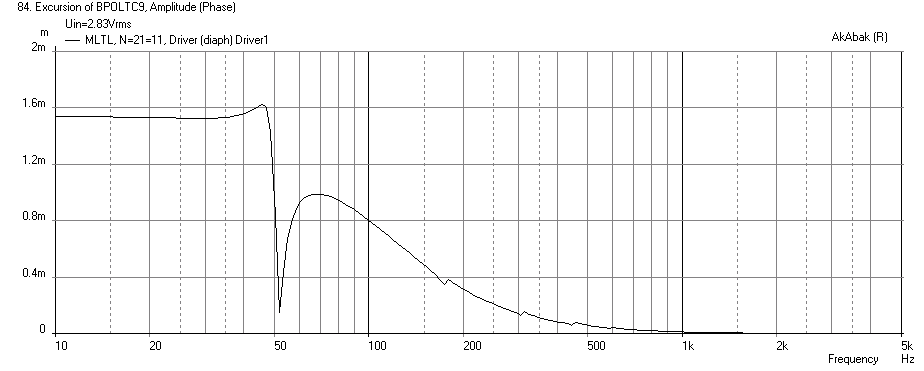

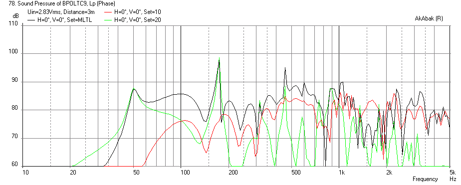

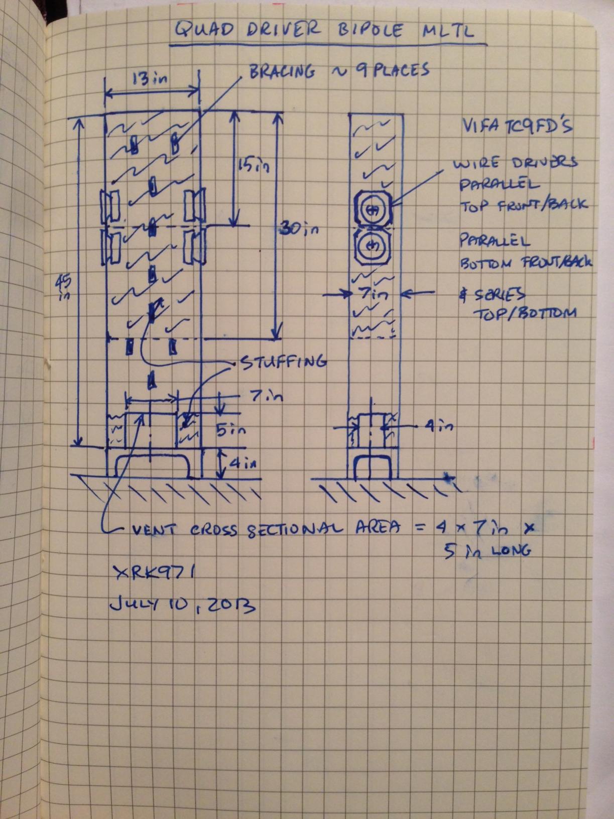

AMLTL Design for Quad Bipole with TC9FD
I got a request to design a quad driver bipole MLTL with the Vifa TC9FD. Using WinISD, I get a box volume of 67 liters and for a rectangular vent with dimensions of 4 in x 7 in, the length was 6 in (WinISD chose a 55 Hz tuning freq). So I assume a length of 45 inches and baffle width of 7 inches, this sets the depth at 13 inches. According to my AMLTL design rule: the drivers are assumed to be mounted at 1/3 distance from closed end (15 in) and use about 0.5 lb/cu ft of polyfill stuffing in upper 2/3rds of line. The vent is a rectangle that is down firing and the speaker sits on 5 in tall legs. Drivers are wired parallel (upper front & back parallel, lower front & back parallel) and in series upper and lower to get total 8 ohms.

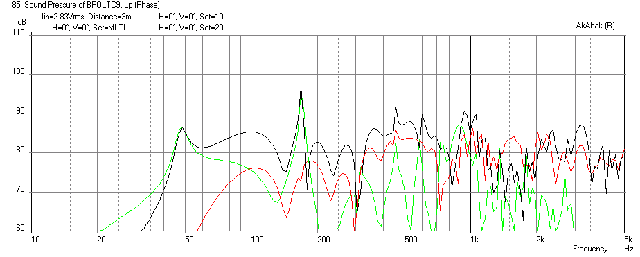

Below is the simulation in AkAbak with these dimensions. The simulation is with the speaker 60 in from a back wall, 1 watt input, measurement at 3 meters away. I then reduced the vent length to 5 inches to boost the bass output a bit and to bring the peak to about 50 Hz rather than sub 50 Hz. The fs is 120 Hz so you don't want to go too much lower than what WinISD predicts. The second plot is the simulation with the shortened 5 in vent and the third plot is the impedance, and fourth plot shows cone displacement (well controlled).
As you can see, if I had done nothing to the dimensions from WinISD, it still would work pretty well. Just ignore all the sharp peaks and dips - they will smooth out with stuffing which AkAbak cannot model.
So the final design is up to you whether you want the 6 in or 5 in long vent. The output of circa 85 dB at 3 meters away with 1 watt is not bad for $48 worth of drivers in a bipole configuration where you do not have any baffle step loss.

Hello Xrk,
I'd like to build this design but being a relative newcomer i am not familiar with MLTL... Reading from your description I can only minimally understand what you were saying regarding the box dimension .. For that I apologize.
Is it possible if you can draw a sketch of the dimensions?
Thank you

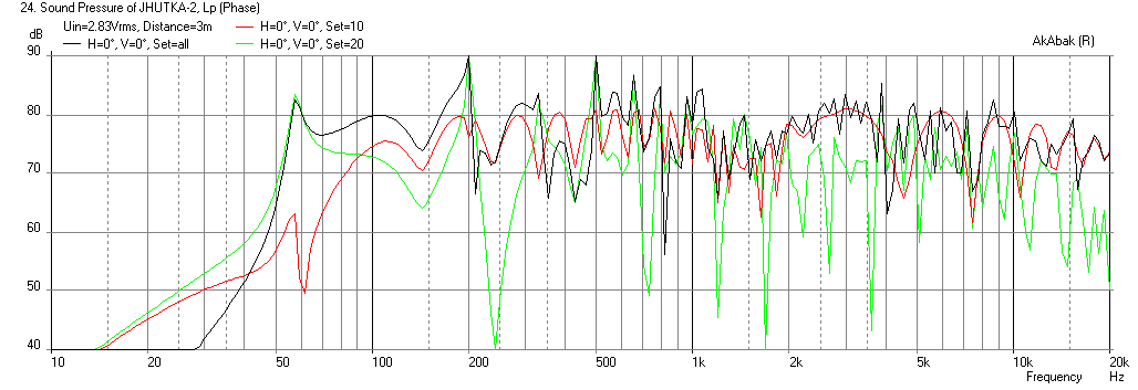

XRK,
I know you have tons of projects in the works. However, in my attempts to become self sufficient, I used the accidental technique for this MLTL.
Could you please check my numbers? (I may have been a little too generous in my rounding.)
Driver - Vifa TC9FD 18-08
Volume of the box - 1200 in^3, 5in X 6in X 40in
Vent - 1.5in X 5in X 8.25in
Folded design below.
Please say "No," if you don't have the time.

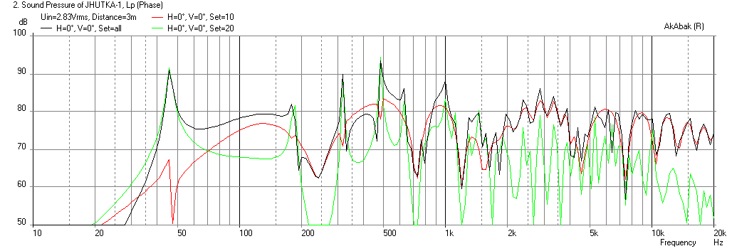

AMLTL for Vifa TC9FD & Optimization with AkAbak

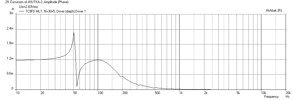

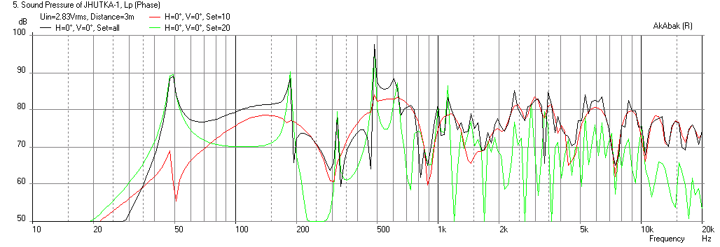

Jhutka,
The AMLTL you have could work, although the tuning is a bit too deep and the driver won't perform very well as the bass amplitude will really fall off. The default WinISD tuning freq is 55 Hz for the TC9FD. I would tune it higher as a bass reflex - circa 65 to 70 Hz and then let the MLTL action pull the tuning lower. The volume you have is also a bit too big (almost 21 liters) and causes a large bass peak overshoot followed by a sag in SPL. The default volume is 16 liters for the TC9FD.
So if I were to do this as a AMLTL, I would use the default volume of 16 liters, tune to 70 Hz, and the vent would be 5 in wide x 1.5 in tall x 4.8 in long. The length of the TL is set at 42.25 to allow room for the vent shelf, will dictate that the depth of the channel be about 4.6 in for a 5 in wide channel.
However, one can try to make the cabinet a little more compact by reducing the volume even further and it will still work. For a 3.5 in deep channel, the volume will be about 12 liters. For a 5 in x 1.5 in vent, the length will be 7.16 in long for 70 Hz tuning.

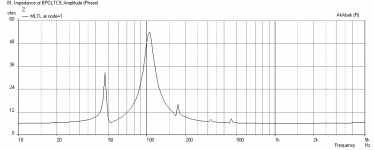

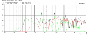

Since I now have the ability to model this in AkAbak, we can see the effect of the volume and vent as follows. The first plot is the freq response for the AMLTL that you designed (6 in deep channel with 8.25 in long vent). The tuning is really to far down around 46 Hz. The Vifa should not be pushed this low as its fs is 120 Hz. You can see the effect of a volume that is larger than optimum in the exaggerated bass peak.
Next plot is using the default 16 liter volume (4.6 in deep) and 70 Hz tuning in WinISD (7.16 in long vent). Note that the actual tuning frequency as a MLTL is now sub 50 Hz - a -20 Hz freq extension. However, there is still an exaggerated bass peak and a sag after the peak.
So we can reduce the volume to 12 liters (3.5 in deep) and reduce the vent length to 4.5 in long in order to boost the bass amplitude but give up some extension to the mid 50 Hz range, and also try to reduce the bass overshoot peak. Third plot shows the freq response for this semi optimized configuration. The cabinet will now be smaller at only 11.25 in deep (assuming 0.75 in thick stock). Note that the bass amplitude is now high enough that you don't need a BSC.
All of the sims assume that the back wall is 60 in away to remove the wall bass enhancement effect and the measurement is at 3 m away - a typical listening position as no one listens at 1 m away.

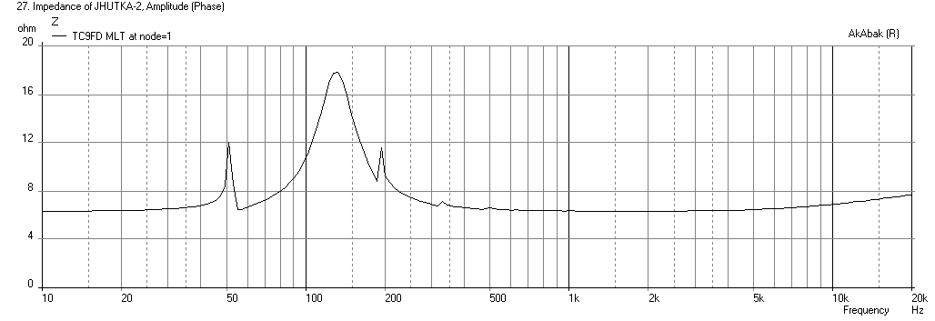

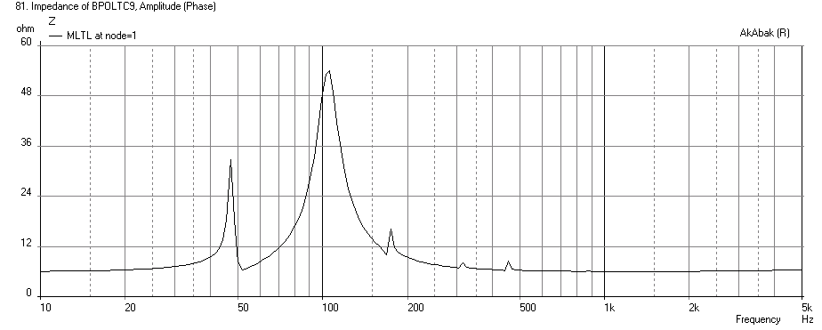

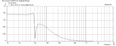

The next plot is the impedance for the 3.5 in deep case, and the last plot shows cone displacement for the 3.5 in deep case.
I hope this helps answer your question. I would go with the 3.5 in deep version with the 4.5 in long vent. You will get a fuller sounding bass and not require BSC.

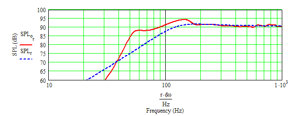

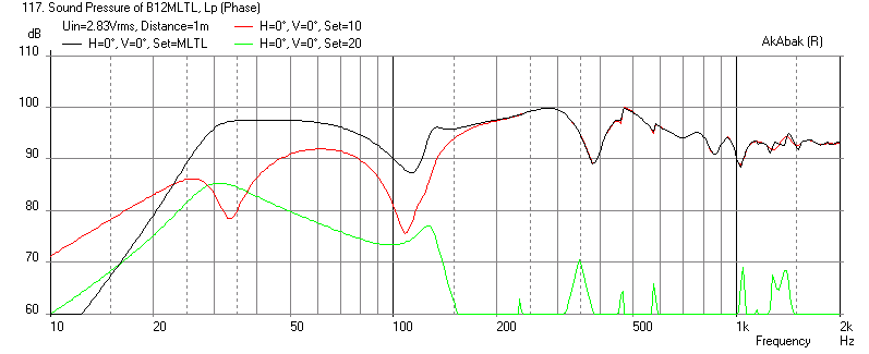

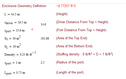

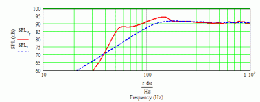

Big 12 in coaxial driver AMLTL
Is this a reasonable frequency response for a 12 in driver? I used AMLTL method to size the vents. This design is for an off-spec Eminence Beta 12CX with a higher Qts 0f 0.63 - which makes the cabinet huge. The design ended up as a 22.5 in wide x 22.5 in deep x 56.5 in tall tower. Using 3/4 in ply should make this a 2x2 ft x 5 ft tall tower - almost a refrigerator size .
The driver is at 14 in from the top and the qnty 4, 4 in dia x 4.0 in long vents are located at 8 in from the bottom and one on each wall.
