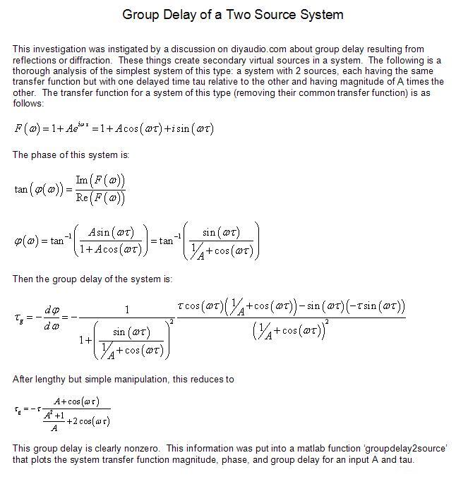

I have done an analysis of the simplest case- two sources, one delayed and attenuated. This system has nonzero and nonconstant group delay. Since I can't attach a word document, I've attached a picture of the word document that I have the details in. I will post some graphs shortly.

Also, if anyone wants the matlab function that I'm using, go ahead and email me at rybaudio@hotmail.com and I'll send it to you.
In case you can't read what is going on, the plots are as follows.
Upper left:
system transfer function magnitude in dB vs frequency
vertical scale: linear, -30 dB to 10 dB
horizontal scale: log, 20 Hz to 20 kHz
Upper right:
system phase angle in degrees vs frequency
vertical scale: linear, -90 to 90 degrees
Lower left:
system group delay in ms vs. frequency
vertical scale: linear, -2 to 2 ms
