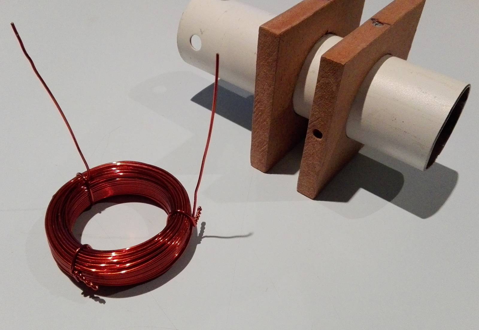

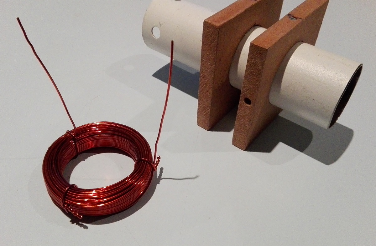

The high frequencies started to irritate my ears. After a lot of discussion with XRK971 (in another thread) about baffle step correction, I wound two 0.9mH air core inductors. Below is a picture showing the jig I made from 50mm OD steel pipe and some MFD. I used 123 turns 1.15 dia (17 gauge) magnet wire to wind the choke.
1 Ohm 5W resistors seem to have just the right amount of high frequency suppression, but I'm still experimenting.
The addition of baffle steps turned the very enjoyable (but a bit too bright and bass-lacking) 0.53X K's into mature and sweet sounding speakers with plenty bass. So, if anyone considers going the same dual FaitalPro driver route with their Karsonators, be aware that you might need BSC's.

I am aware of the home-made inductor you made, and I believe you ended up with an air-core inductor with a 50mm interior diameter, and something like 123 turns. How wide was the coil (distance between the end-boards on the pipe)? I tried back-calculating info on the link you provided, and had real trouble getting 0.9mH. Can you clarify? I also believe you ended up with a 1 ohm resistor in parallel with the coil. Is that correct? More interested in starting from a known point, so I'd rather match your configuration than start with an experiment. Once I have a baseline, I can try to mess with it, if I my ears are different than yours.

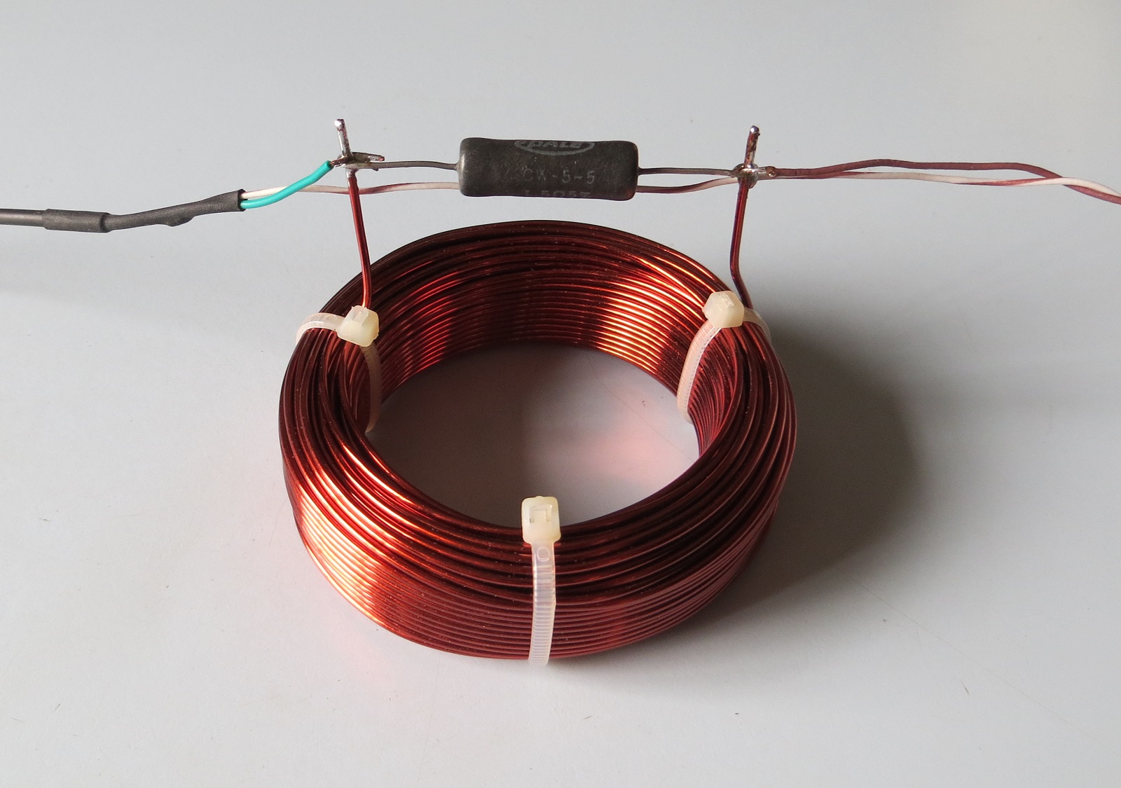

The coil is 20mm high (wide). I used to use a 1.5 Ohm resistor, but am now listening with 2.2 Ohm. It dampens the highs a little more.
But as X said, adjust (the resistor) to taste. I'd start with 2.2 Ohm and try a few other values, between 1 and 4.7 Ohm to hear the difference.
Inductors

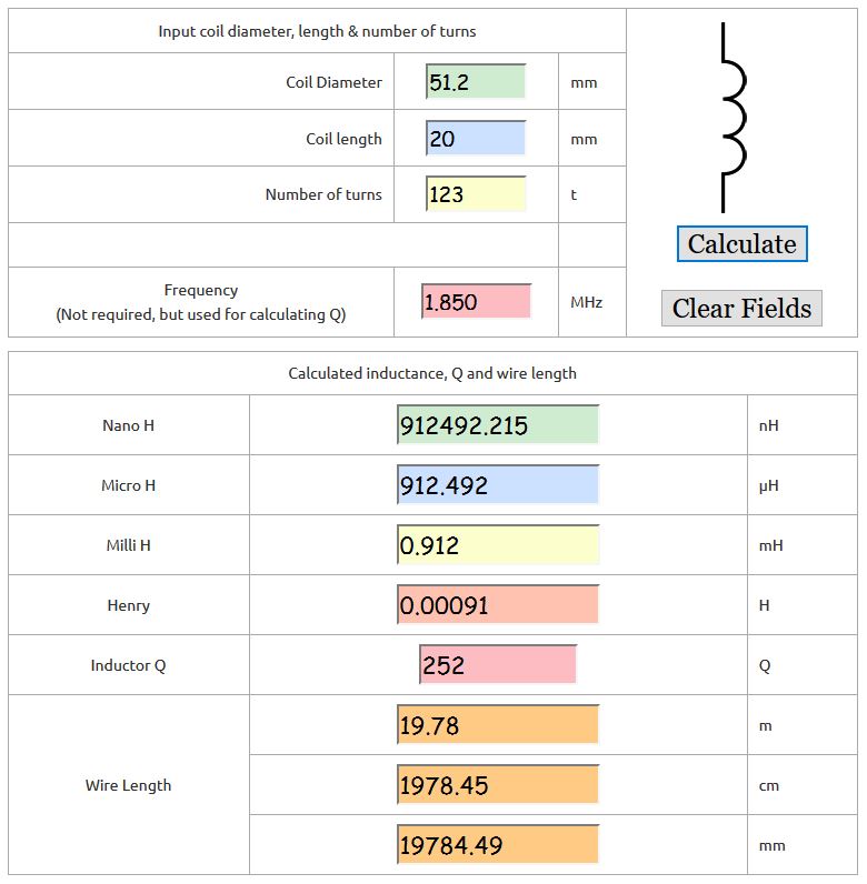

I have used the M0UKD Air Cored Inductor Calculator to design my 0.9mH inductors. The values used were:
Coil diameter: 51.2mm (center to center of wire)
Coil length: 20mm
Number of turns: 123
(I kept the default 1.850 frequency)
The result is a 0.9mH choke. I've used 1.2mm wire for very low resistance (0.29 Ohm).
The coil length should have been18.8mm to the center of the wire, but even with that correct, the inductance doesn't vary much (0.94mH). 120 Turns would make it 0.895mH.
Play around with the calculator and see what you get.

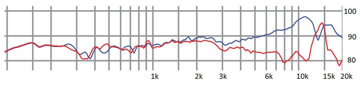

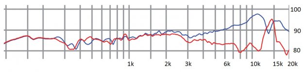

I've been looking at the frequency response of the 3FE25-16, and noticed that there's a bump at 2kHz, and that there is a rise starting at 3k, passing thru about +6dB at 6k and on to about 10-12dB at 12k before falling off. I presume these are the 'honk' and 'ear fatigue' peaks mentioned in discussions about the baffle step circuit.

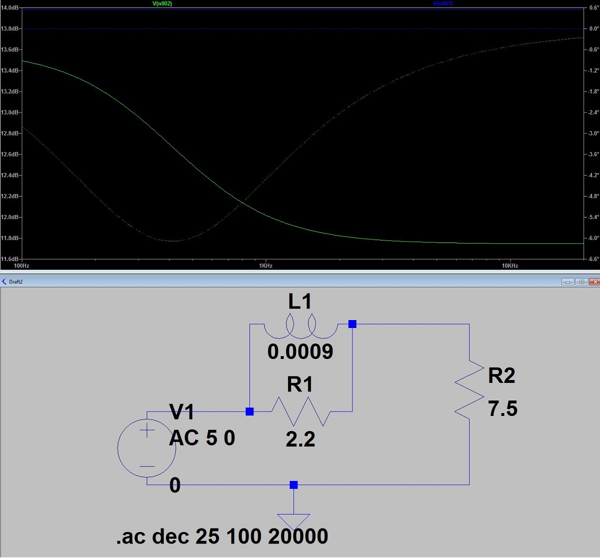

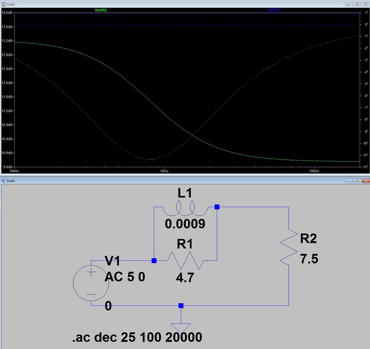

However, looking at what Skylar88 is using (0.9mH & 2R2) and putting it in a simulation with 7.5 ohms as the load, about the average between 3k & 12k (based on the graph provided by the manufacturer), I got about a 2dB cut way earlier than expected and being about 1dB down at about 450-500Hz. Using a similar inductor and the 4R7 recommended by xrk971, I got about 4dB of hi freq cut, with the curve passing thru the -2dB point at about 700Hz.
This is not what I expected to see, based on what was discussed. In theory, if I read it correctly, I was expecting the filter not to start cutting until about 1k (which, based on what the speaker graph, seems to be a bit early). I played with the circuit to try to get the silly thing to do what I think it should do (start cutting around 1K, show some decrease by 3k, -6dB at 6k and -12dB at 12k) and ended up with a 0.3mH (at 0.3 ohm) and a 47 ohm resistor. I got about -2dB at 3k, -7.5dB at 6k and -10dB at 12k. However, it was still dropping like a rock, so by 20k, it was down over 14db and still falling.
I obviously don't understand something. I thought the baffle step was there to help level the speaker response. Am I getting a little carried away?
PS -Skylar88 - I tried building the same inductor you did, and came up with (using a $12 kit inductor-meter) 0.903mH and about 0.7 ohms for 17ga wire (a little thinner than yours). The online calculator came out better than expected. I used 2" outer diameter (50.8mm) plumbing adapter, cut to 20mm long and plates bolted on each end as a form.

Good to know, Ken. Thanks for confirming that the calculator can be trusted. Btw, I have been listening to my dual driver K's, without and with BSC. There is quite a reduction in SPL with the BSC. If my ears could handle the natural high frequency boost (of the dual drivers), I would much rather go without the BSC, in combination with the fleawatt ACA and B1 buffer.

If you make the Alpha 20, you get the Aksa Lender Preamp as the front end to the amp and 20w which should be more than enough for the Karlsonator. I never used a BSC on my Karlsonators - I always felt they were pretty well balanced and not too bright. But then never had a dual 16ohm one.
KKing, the BSC May prove to be different if you model the speaker with appropriate elements equivalent to real driver (RLC equivalent of TS parameters).
I can run a simulation in Akabak with and without BSC and let’s see how it looks.
