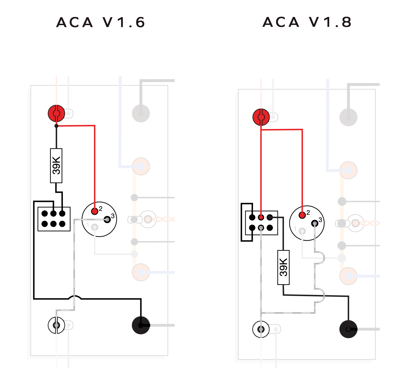

V1.8 builders - please note below the slight but important wiring changes between V1.6 and V1.8 and use the V1.8 wiring diagram.

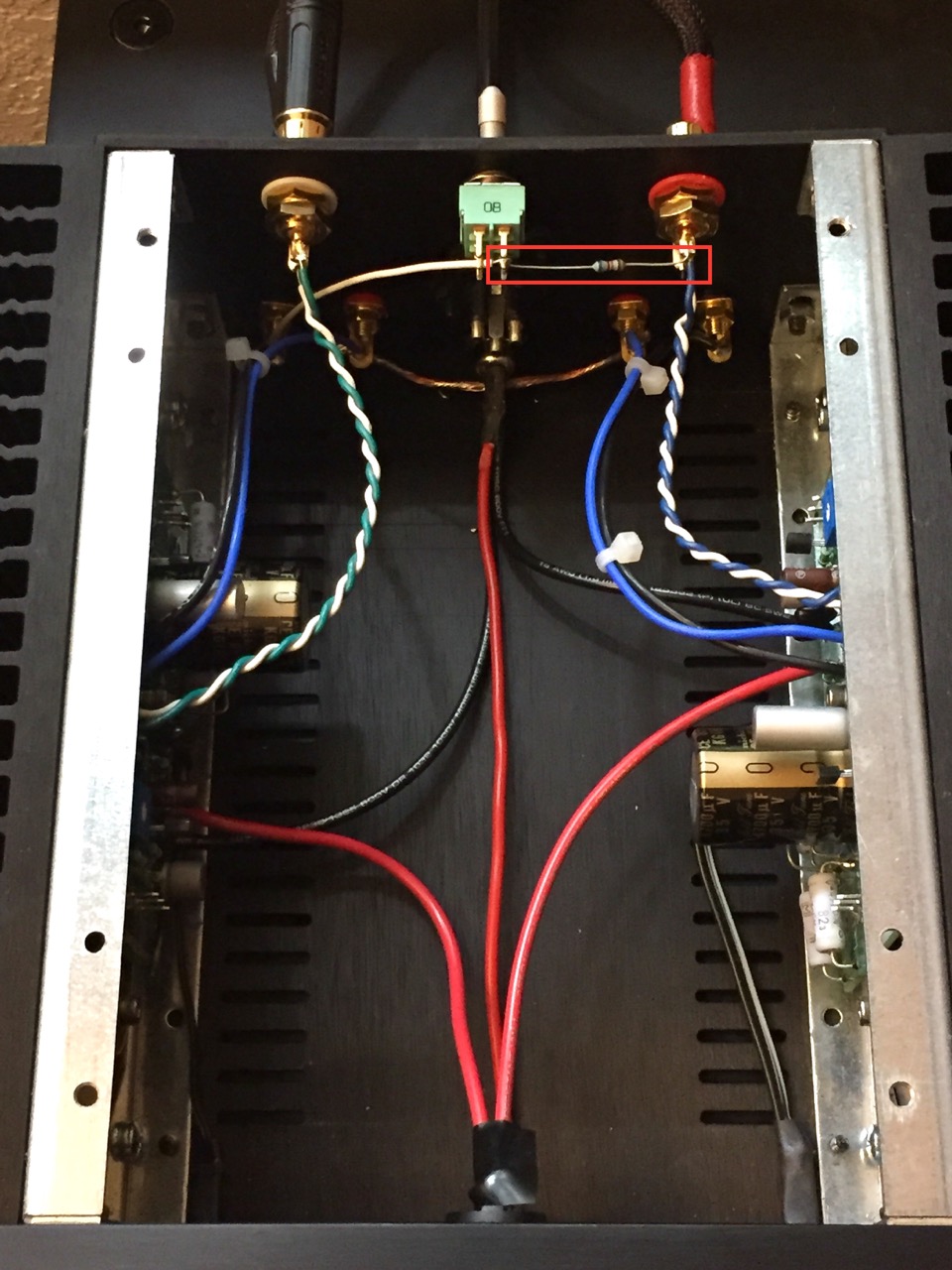

Since there seems to be some question about the method of bridging the two halves of this amplifier, hopefully a picture can help.
The "bridging" resistor is indicated by the red rectangle. It is connected from the left channel's negative (-) output to the right channel's input through a switch. The method is explained in the excellent pictorial build guide by 6L6. I had a couple locking toggle switches from my local electronic surplus store, and decided to use them here.
Note that the right input is left unconnected externally when running the amps in bridged mode. The negative speaker connection goes to the left (-) output and the positive speaker connection goes to the right (-) output.
