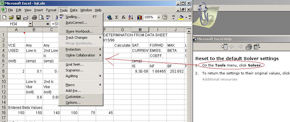

I used the "bjt.xls" application <http://www.analogservices.com/excel.htm> to fit Spice data for the AC128. The data in the manual ('69 Tungsram Transistor Handbook) I have for that transistor is a bit sparse, only Cbc at a given voltage and Ft was given for dynamic values. Still, the common emitter amplifier with that model looks a lot more "credible".
Peter
Peter
I used the "bjt.xls" application <http://www.analogservices.com/excel.htm> to fit Spice data for the AC128. The data in the manual I have for that transistor ('69 Tungsram Transistor Handbook) is a bit sparse, only Cbc at a given voltage and Ft was given for dynamic values. Still, the common emitter amplifier with that model looks a lot more "credible".

PH104 said:Glen --
It's one of those irritating MS add-in things. Go to Tools, then Add-Ins. You might need to have the install disc handy, can't remember.
Anything good cooking?
Phil
Ahh!
Thanks! I was almost ready to head butt the computer out the window.
No curried baked beans on the stove at the moment.
Glen

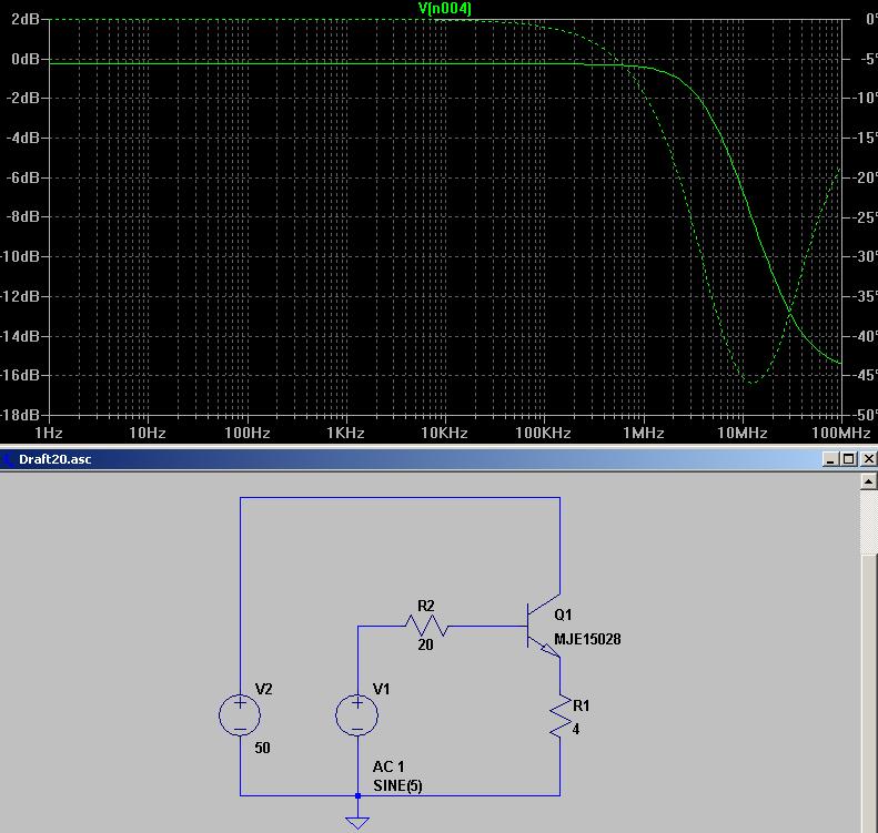

Here is my first attempt at making a SPICE model.
It is a MJE15028.
Using this model I'm no getting realistic emitter follower bandwidth results in LTspice (the ON Semi models just return garbage).
I'd appreciate it if any of the SPICE experts out there could give it a look over.

I have not looked at the model, but in your test circuit the transistor is not properly biased!
I would rather use a common emitter circuit, with a bypassed emitter resistor, biased for a collector current of your interest, in that case the upper frequency is defined by the transistor capacitances!

The AC source has a DC value of 5V, so the transistor is biased at ~1A.
BTW, there was a typo in my previous post - I meant to say that I was getting realistic results.
