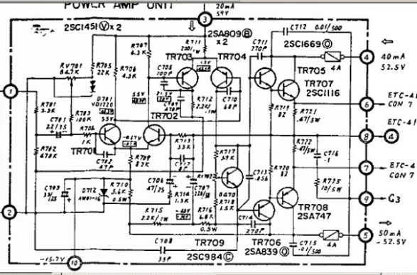

Hello
Here is the schematic of the amp section of the PMA-700V, there is no jfet.
Bye
Gaetan

Hello
There is no pages number in my service manual file, it's cut on the right, but I finally found the fet input section, your right, sorry my mistake.

This is the power stage and IC based biaising circuit , the input part is on the left , you can see the full power amp section on page 17 of this PDF.;)
You are pretty much off base here.
The Biasing is not done by the IC's, it uses a normal VBE multiplier (TR501/502). The power stage is unity gain.
The Op-Amp's appear to form some kind of crazy error correction for high frequencies only (IC7 and IC 8 respectively) plus feedback loop for AC only (IC5) that encloses the power stage. It seems unable to work correctly at high levels if there is a significant difference between the channels as well, as the available voltage swing will be way exceeded, due to using a dual op-amp with bootstrapped supplies shared between channels.
I am not sure I would hold this circuit up as paragon of good design next to (say) a Hitatchi lateral Mosfet Amp or the improved versions. I am equally unsure all this shebang is really better than just putting the output stage into the line stage feedback loop (good reasons for that), or letting it run open loop with some slightly less convoluted error correction (good reasons for that).
The power stage is preceded by a very high gain and output voltage line-stage with a tone control in the feedback loop. The line-stage has the kind of circuit you described (triple differential - good for tons of NFB and many zeros after the THD decimal point, less so possible for transient response and TIM/PIM and others like them), however it is a fully stand alone discrete Op-Amp including emitter follower output stage and not really part of the power amp.
Ciao T
Is not the "crazy error correction" also biasing ? It is just active at Xover and at device turnoff. Error correction = bias correction. This is the same idea as nikko's 4 transistor/germanium diode setup , JVC's "super A" . Thread is here ..
http://www.diyaudio.com/forums/solid-state/162559-new-class-super-non-switching-need-revival.html.
Tanaka (sansui) , calls this " a new biasing circuit for class B operation" :eek:
OS
Normally Bias is considered to be a "static" thing. The error correction changes the AC behaviour. I guess the terminology is open to debate, as a traditionalist I stick to "Bias = DC" and "Error Correction = AC".
The Denon Implementation seems overly complex and in some areas ill considered. If all we want is to prevent turn-off of the halve of the output stage that is not delivering power to the load, there are much simpler, easier and at least as effective methodes.
If we genuinely want to correct the actual linearity of the output stage it does not work well and needs the addition of a feedback loop as actually shown.
Sure, there used to be another one of these "squaring the circle" approaches every other week in the 70's and 80's. They generally worked about as good as any of them.
