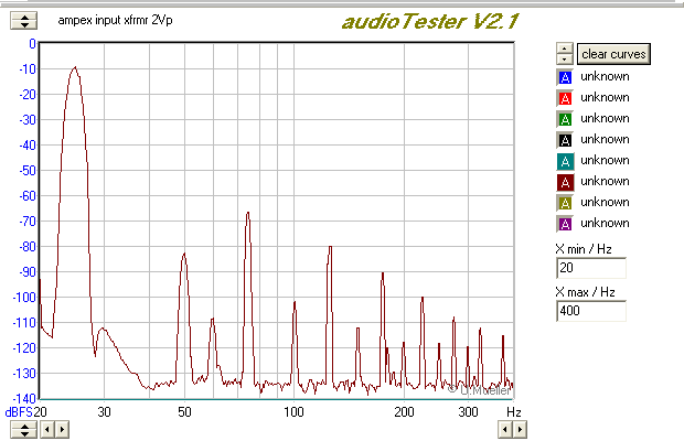

Btw. Here is the distortion of the M-Audio Audiophle 2496 at 24 bits:

Do you mean this? http://www.clarisonus.com/Research Reports/RR001-SoundCardEval/RR001-PCsoundCards.html
I would take it with some salt. Anyway the 500 Hz artefacts he found with the Audiophile 2496 I cannot second. Have a look at the attachment some posts earlier. Ok it was taken at -10 dB. Also the hum he noticed is greatly influenced by noise coming from mains cables entering into the external signal cables. With proper layout this is not an issue (at least not at my side).
