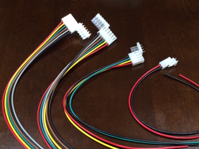

I got a tip on the pigtail connectors for this supply. Very nice convenience and professional looking results. Do yourself a favor and get these.
http://www.diyaudio.com/forums/class-d/275915-200w-irs2092-amp-20-a-34.html#post4604297

Anyone know the name of the connectors? Would like to buy them ln ebay, but cant find them.
Edit: found these after posting
2 54mm Pitch 6 Pin Female Jack Socket PC Connector Wire Cable Single Head 300mm | eBay
Is this the one?
That one won't work as the pin spacing is 0.156inch. (3.96mm spacing).
Here is the right one - I ordered it and it arrived very quickly. They probably take PayPal and can ship to you.
6-PIN CONNECTOR W/HEADER, 0.156" | All Electronics Corp.

I finally connected my amp with these new connectors. They sure work well and make everything so easy. You can remove the wire and prong and reinsert at the proper locations for color coding. I am using with an IRS2092 and also have the 150ohm resistors on the secondary voltages to load it. Works really well - connected to a 400w 10in a
Sub as a test load and it handled itself well. What I found is that the amp actually makes a small sound when deep bass notes hit. Must be piezoelectric effect from caps or electrotrictive force on transformer.
