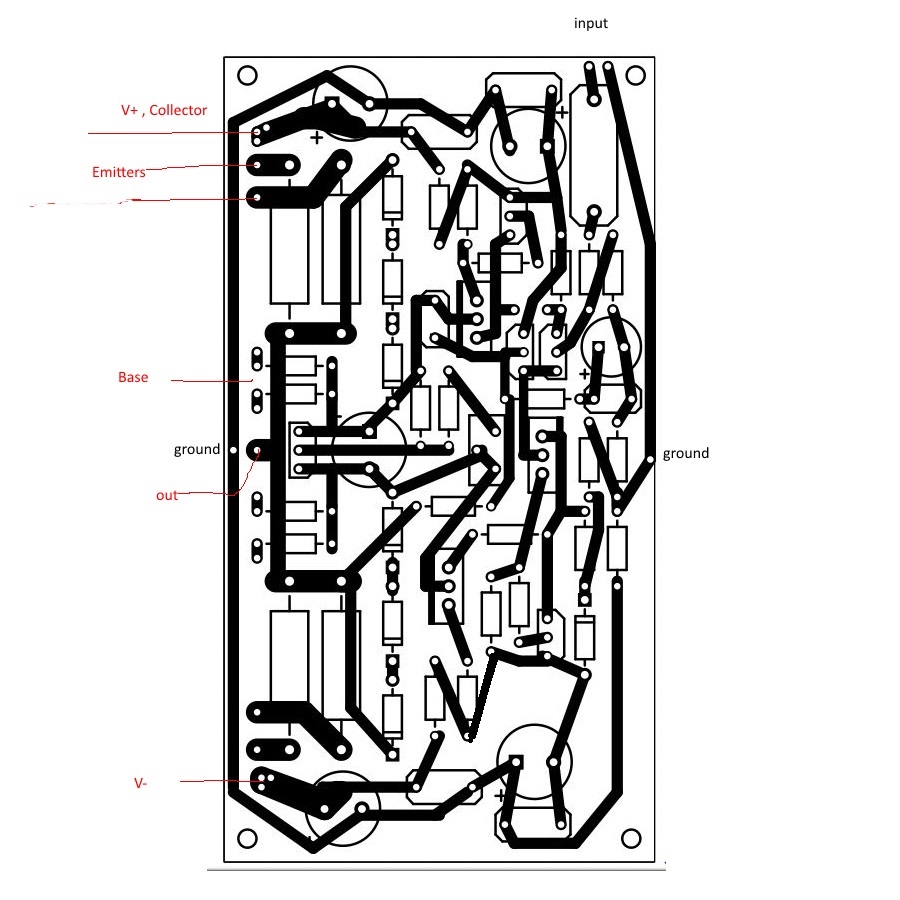

I am preparing the first option for to3 - taking into account the dimensions of enclosure and transistor mounting places.
This still have to be checked - but that is the idea, and there is room for improvement (Unfortunately Iam not pro in pcb design)
base stoppers may be better to solder directly on base pins .
Trust me darlingtons will not like hardwired cables from a board to a heatsink one way or another this style of constructing originates from the 70's Twist cables between B-C-E and expect a very explosive result ( at some point the current that flows to C and E will modulate B cable with catastrophic results )

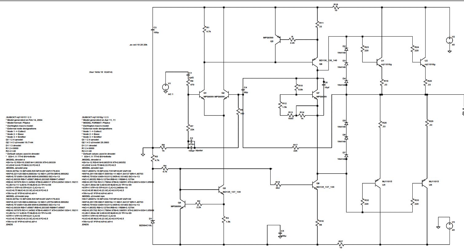

I'm probably spending more time looking at this design than I really need to , as I have amps coming out of my ears (mostly my misbegotten designs), and don't necessarily need yet one more.
I am somewhat intrigued, though, as I haven't designed an all-bipolar power amp since ~1986. This design could be updated for parts that are readily available at the usual suspects (one-stop shopping from Mouser). I had in mind the KSA1220 and KSC2690 for the VAS stages and Vbe multiplier. They are in isolated TO-126 packages, making it really easy to couple the Vbe multiplier to the main heat sink. One could go buck wild and use these parts everywhere in the front stages, especially if you get the high-beta range of the part. An alternative for the input stage might be the KSA992 and KSC1845. All these parts are readily available, and dirt cheap.
Let the TIPs stay in the output stage.
Looking at the input stage, there's a fair amount of current in the tail, and I suspect that adding some degeneration in the emitters of the input pair would be helpful. Food for thought...

Corrected PCB :
I plan to use bipolar capacitor for feedback cap + bypass cap. Gain reduced to 26 db approx. and 0.47R for emitter resistors. Input cap will be 2,2 uf. I will use the signal ground and power ground separating resistor to prevent hum. So far I have had good experience with to-3 and short wires to pcb.

There was never a question or a consideration about the input stage I have actually never been looking at it ...Imagine only yesterday i noticed that there is no RF filtering
All considerations is about the multi vibrator output stage running free and nothing else :confused:
