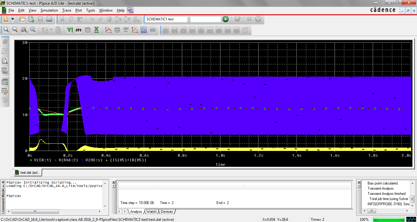

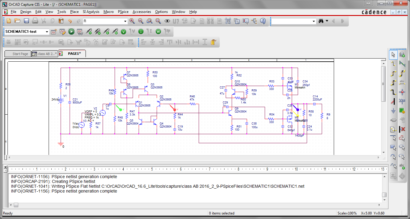

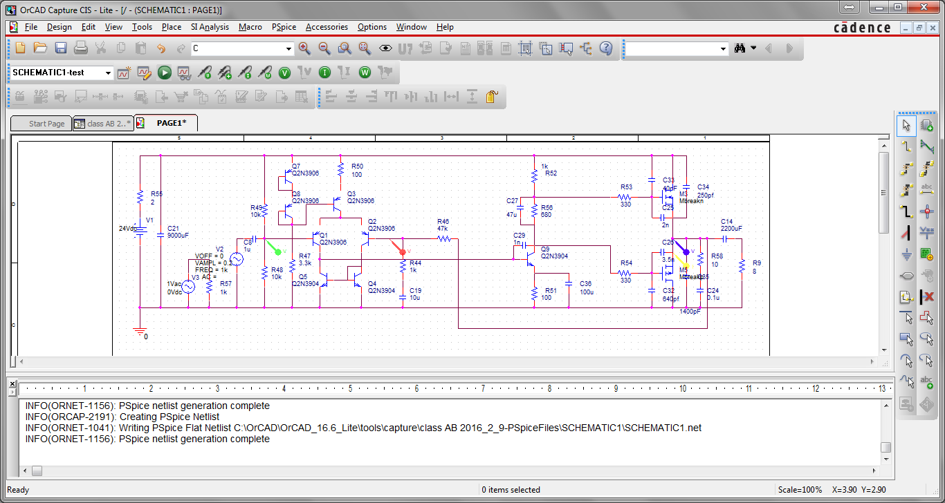

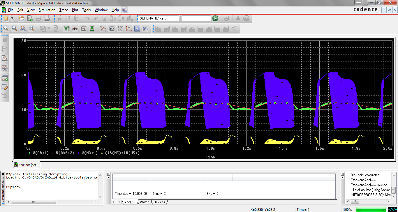

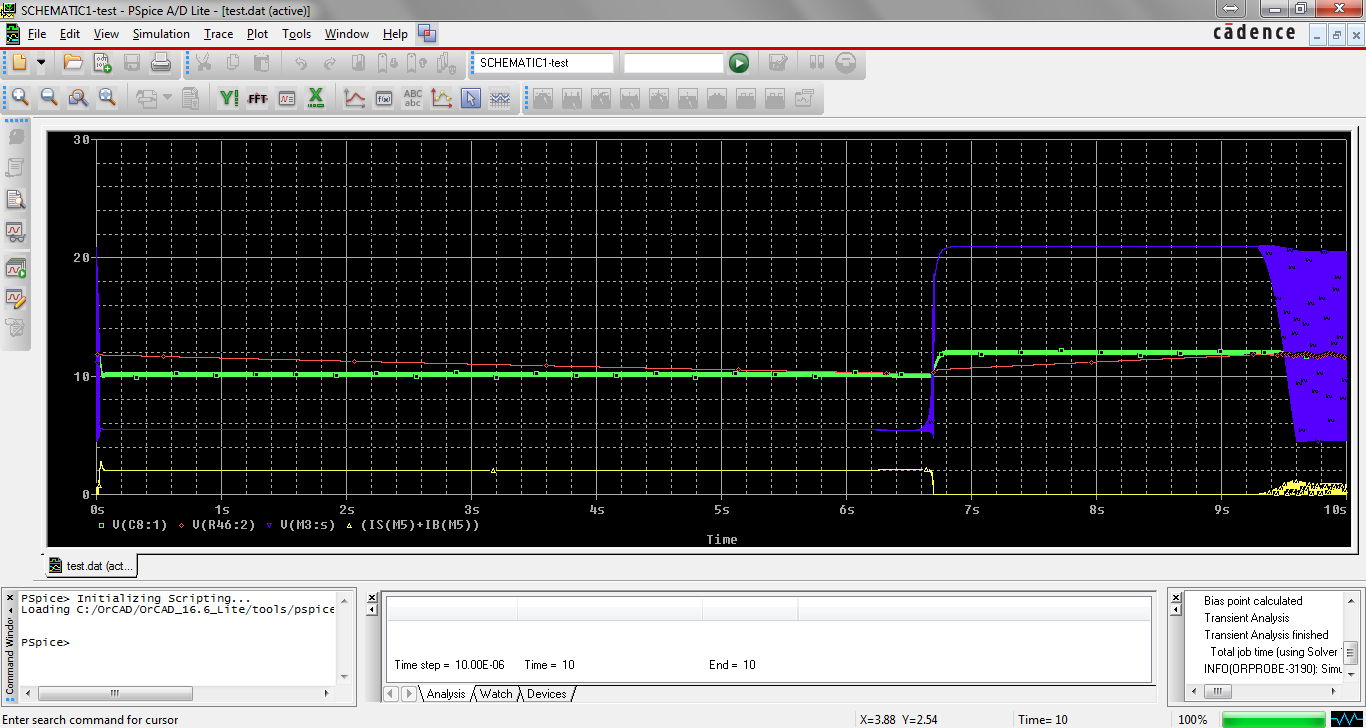

All,
Attached is my current schematic. Also, I have attached plots of the "motorboating" that I was able to replicate in my simulation when I added a 2 Ohm resistor in series with my power rail (for C21=470uF, C21=10uF, and C21=10uF and C19=9000uF, respectively). To stop this, I have changed C21 to 9000uF and C19 to 10uF and also made the same changes to the physical hardware. R56 is the trimmer I am using to set the bias current. If I understand correctly, replacing R56 with a transistor and using a trimmer to bias it should be sufficient to provide thermal compensation? (see schematic w/ proposed change)

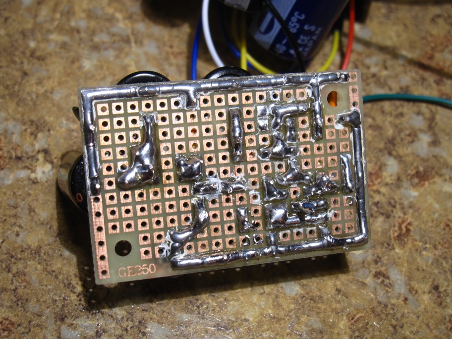

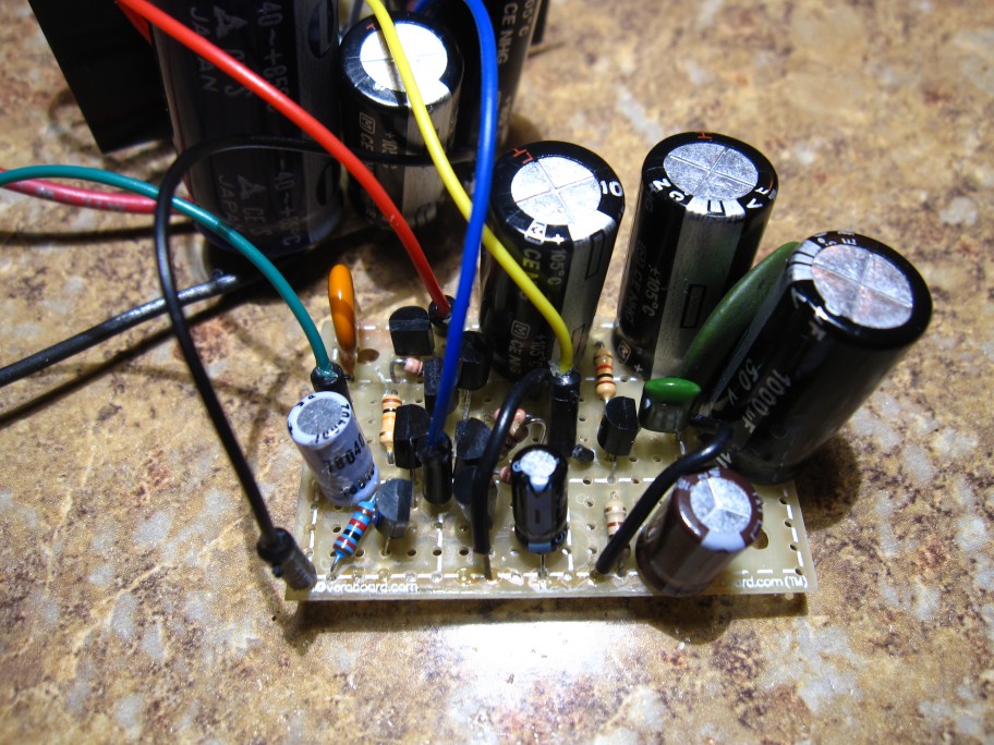

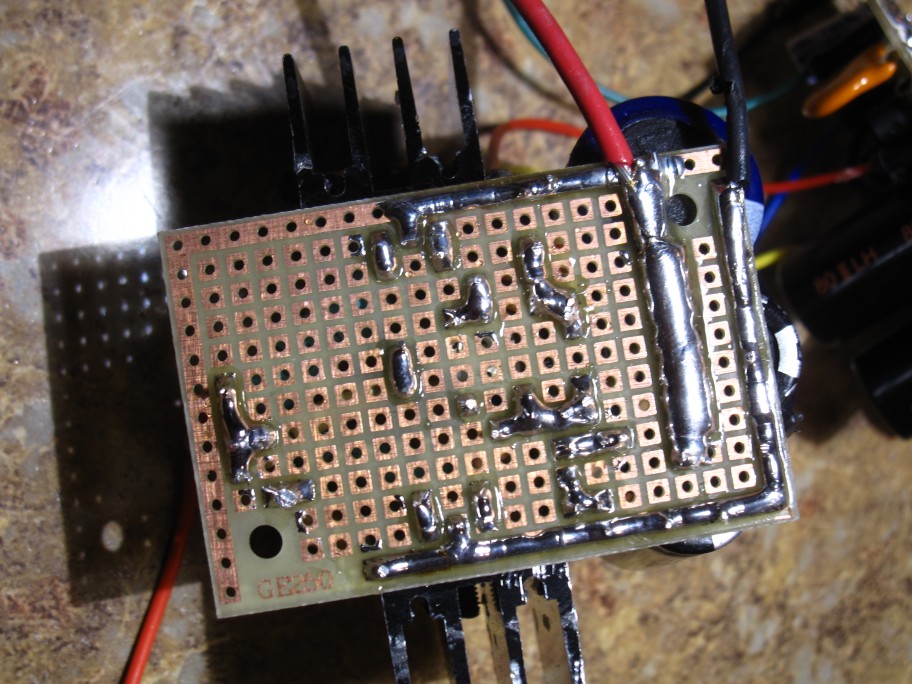

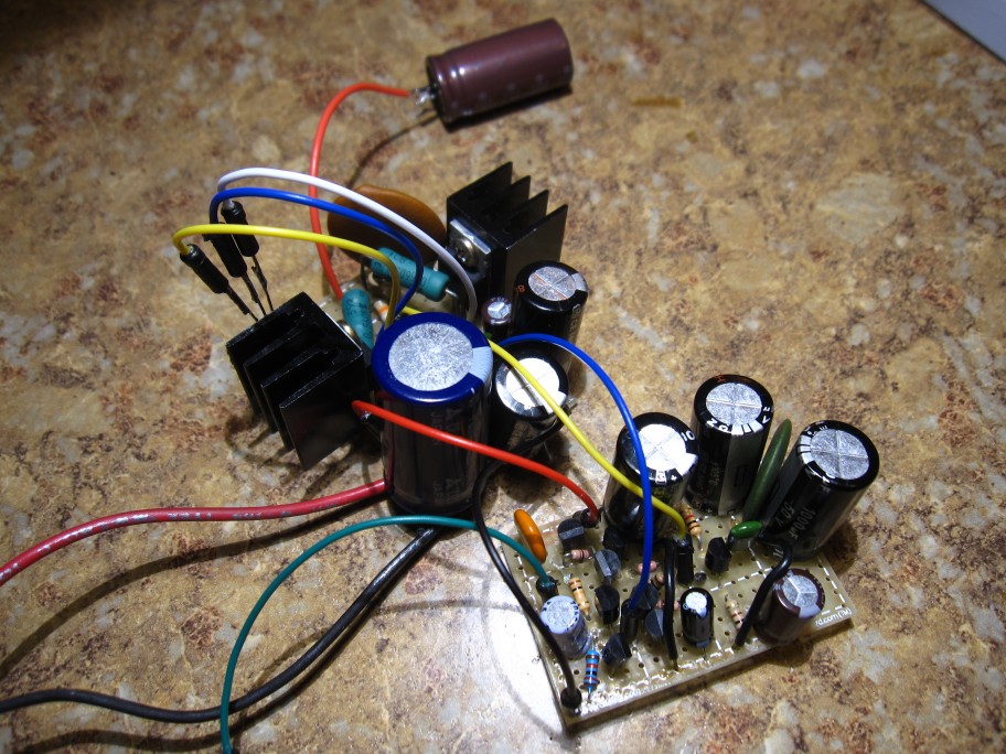

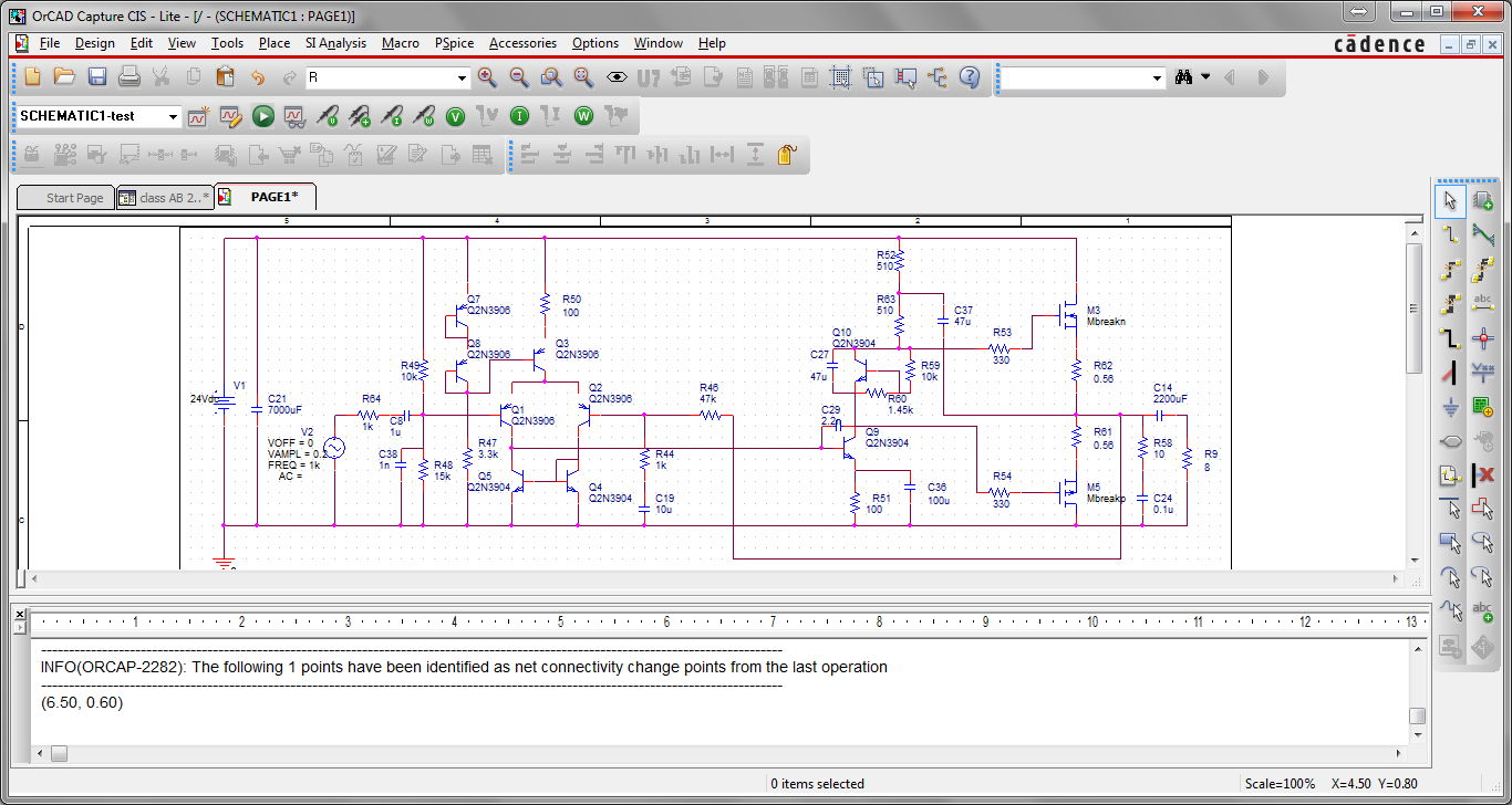

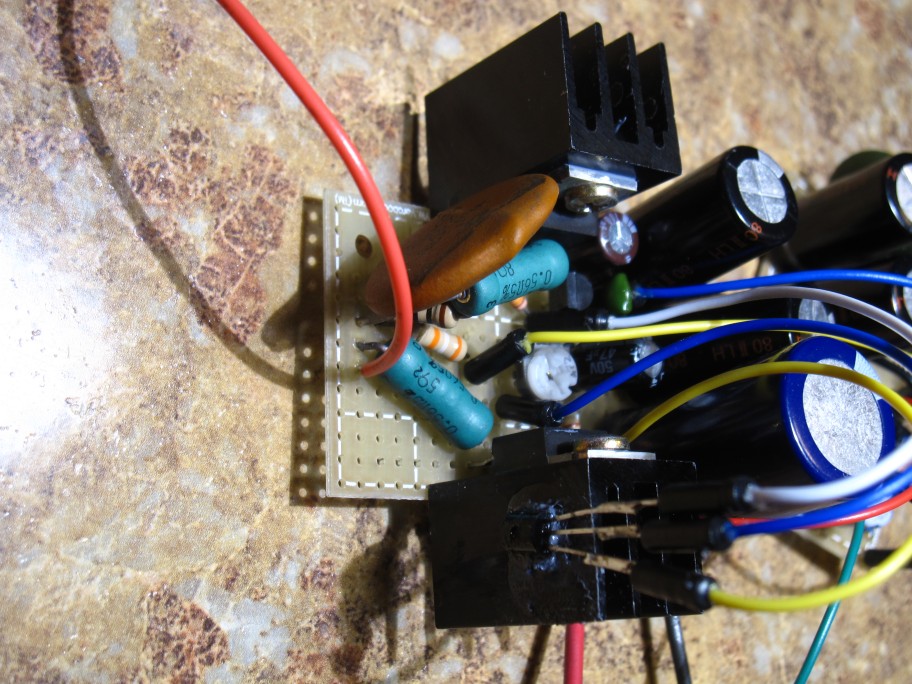

All,
I made what I think may be the final round of modifications to the circuit (maybe?). I tested everything and soldered it to a new circuit board. My changes include adding a "spreader" biasing transistor (Q10) as per everyone's suggestions, adding two 0.56 Ohm source resistors, changing C29 to 2.2nF (there seemed to be some residual high frequency noise, hopefully that change won't be an issue), and changing R48 to 12k to better center the bias point.
In addition, to avoid any power supply resistance issues moving forward, I soldered on some slightly beefier power supply cables. In order to mount the biasing transistor on the heatsink, I stuck it to the side of the heatsink of the IRF540N with a bit of heatsink grease and some super glue. A bit crude, perhaps, but the bias current seems to be considerably more stable now.
Unless folks have any additional suggestions for this design, I may call it here on this project. Honestly, I'm pretty surprised that I was able to debug this design so quickly and effectively, and a big thanks to everyone for their guidance on this. In particular, I think that gaining a better understanding of gain and phase characteristics will give me a better handle on designing and debugging heavily feedback-controlled designs like this, which are still fairly new territory for me. My eventual plans are to start moving towards higher power in my designs, as well as some possible experimentation with class D designs...

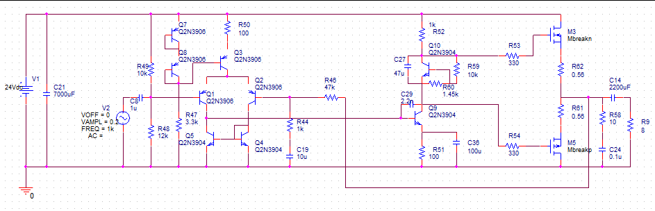

All,
I have made the final few tweaks as per everyone's recommendations (see updated schematic). I have split R52 into two 510 Ohm resistors and added the bootstrapped VAS load, I have also added in a 1nF capacitor at the input (see C38) and a 1K resistor in series with the input capacitor (see R64).
Mooly, just out of curiosity, what is the exact function of the 1k input resistor R64? I have tried it both ways side by side as a test, and I can't seem to tell any difference with or without it. is it just there as a safety measure against high frequency noise or to mitigate reactive input loading from C38 perhaps? I would like to better understand what this is for in terms of my future designs.

R64 and C38 form an input low pass filter (1-st order), preventing unwanted HF signals from entering and being amplified by the amp.
The cut-uff frequency is calculated as F = 1 / (2 * Pi * R * C), giving 159KHz in your case, which is fine.
Making it too low will limit the rise/fall time (rounded corners on the square wave response), making it too high will just let the HF passing through the amp. In the modern high-speed amps some 300KHz is a good compromise.
Its as vzaichenko says, its a simple first order R/C filter to protect the amp from any unwanted hf from entering. Its fairly standard practice to have something like this on an amplifier input.
It could also alter (help or otherwise) a design of marginal stability due to layout and grounding compromises.
