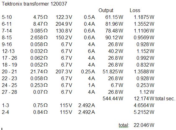

I was thinking of using a Tektronix power transformer for this. Anybody got specs on the 120-141 or 120-037? I can find voltage specs, but I want to make sure I get something with enough current capability.

Here's my read of the Tek 120-037: 22W of copper loss plus a few watts of core loss would really be pushing it, unless there's forced air. But you wouldn't load ALL the windings and loss drops as square of the current. This would be loafing with a stereo KT88 amp.

That's pretty easily workable into a half decent power supply. Also, I really do need at least a 6K primary on the OPT, preferably a 7.5k, or even higher. Believe me, if I could use a dynaclone I would.
