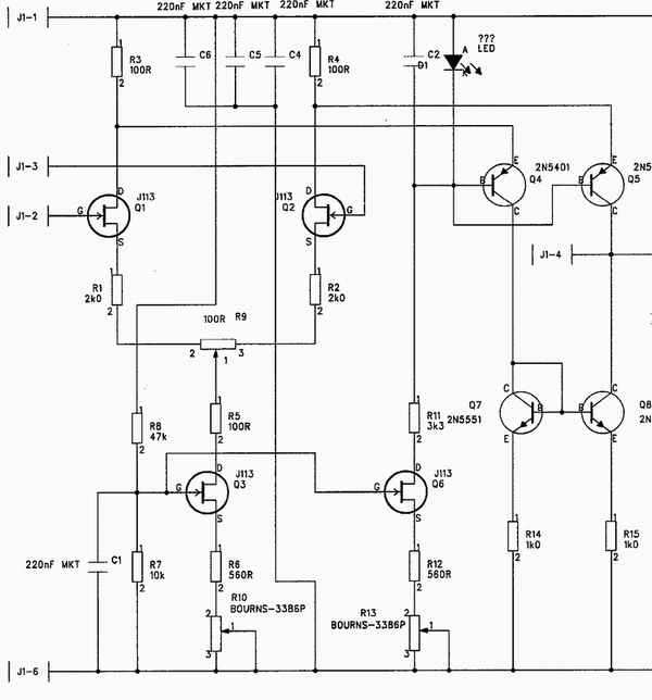

This opamp design is made by Sonnya. J1-4 is the output to the current stage. I see it as very clever opamp design. I made comment to this (in other thread) as a "SINGLE STAGE OPAMP", as I see it only have gain from differential. The folded cascode and current mirror dont have gain.
But Elso Kwak said "I think most of the gain comes from the current mirror loading the folded cascode....." What makes him see the cct that way?

"But Elso Kwak said "I think most of the gain comes from the current mirror loading the folded cascode....." What makes him see the cct that way?"
If the output of the current mirror is loaded with high impedance,
then it will deliver voltage gain, even if it is set for unity current
gain.

If the output of the current mirror is loaded with high impedance, then it will deliver voltage gain, even if it is set for unity current gain.
Is it high or low impedance? How to determine input impedance of current stage?
So, current mirror can make voltage gain, even if the current gain is 1.
If the output is between collectors (like the sch of Sonnya), I think even if the current swing is as low as 0.01mA, it should be able to have full voltage swing between rails, the problem is how much mA is enough for driving the next stage (like my question above)
So my view of Sonnya's opamps is wrong. It is true that it has no current gain, but it does make voltage gain. How to calculate voltage gain in this folded cascode design?

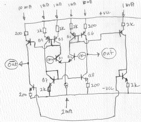

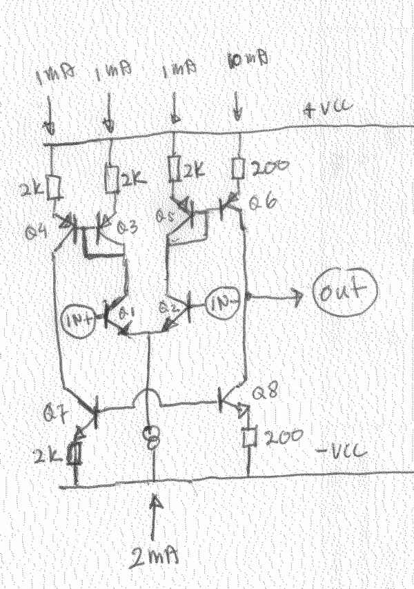

From Sonnya's design and your tutorial about low gain and folded cascode, I came up with this design. I wanted to use single differential, but I also likes pushpull VAS. In this design I could use folded cascode, but I choose current mirrors. The differential is working at low bias, 2mA, but from your opinion, the output stage must have more current. So in the final current mirror, I try to get different Re, 2K and 200ohm, so the final stage is bias at 10mA.
What is the good and bad thing about this design? Will the modified final current mirror gives full swing of 10mA (will it able to drive another current stage?)
Since there is somekind of current gain in the current mirror, will this still classified as low gain design (compared to ordinary 3 stage design)?

Mr. Pass,
Me thinks he has the workings of a pretty good balanced bridged design if he used the output of the Q3,4 and 7 side. Possible conversion to an X maybe. Then again I might be wrong............;)
Jam
P.S. I think that Q7 and 8 need to be biased though.
Hi, all,
I made this design with perspective of current flowing, followed by voltage trace.
The current flows 2mA from CCS to differential, that is 1mA each to Q3 and Q5 (imagine reverse current flowing up from CCS to Q3 and Q5). Since Q3+Q4 and Q5+Q6 is current mirrors, there will be also 1mA flowing down from Q4 to Q7.
The base junction of Q3+Q4, Q7+Q8 and Q5+Q6 will be about (2kx1mA+0.6V=2.6V) relative to rail. Since the base of Q6 and Q8 is about 2.6V to rails, then the current flowing down from Q6 to Q8 is (2.6V-0.6V)/200ohm=10mA. (current mirrors is modified to current magnifier in Q5+Q6 and Q7+Q8)
Mr.Pass is right, if we wanted this cct tobe single action VAS, that is no need for Q3,Q4,Q7,Q8. Just replace the Q8 with CCS and it will work.
But since I wanted a push-pull VAS, then I use Q3,Q4,Q7,Q8 to perform "Pull" action by Q8, if Q6 is "Push" action. So the VAS will be push-pull, not single action by Q6+loaded by CCS (in the place of Q8).
Jam, you are right. This can easily modified to X configuration. Just use the principle of current mirrors, and we can get perfect balanced output by adding a transistor each besides Q4 and Q6, and make another set of Q7+Q8. It will be complete push-pull balanced VAS from single differential.
Q7 and Q8 are automaticly biased by forced current, that is 1mA for Q7 flowing down from Q4 and 10mA for Q8 by voltage+Vbe-drop from Q7
