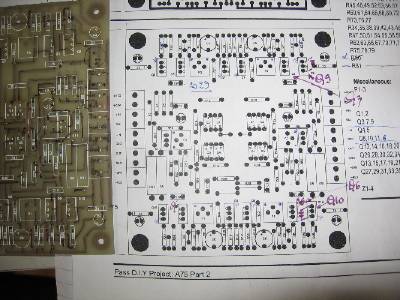

No problem. My first build was the zen V7 (induction loaded output) It has three 1KVA transformers in it. It must weigh damn near 90 pounds. I thought THAT was tricky. I'll finish the A 75 if it kills me but I hope it's worth the effort.

Morning everyone. The original problem I started the string with is definitely fixed. THANK YOU ALL. The power supply has less ripple than I can measure with the MM, fan runs nice and quiet and the LED works and is not too bright. I put a ferrite band around the transformer which also seems to suppress any stray magnetic flux. Front end goes in tonight. I'm trying to decide if I need bother with heat sinks on the front end 220's. The board is right in front of the fan which is moving a decent amount of air past it. I'm guessing it should keep them pretty cool although there's no such thing as too much heat sinking.

Even with the fan, I think I'd use sinks on Q9/10
