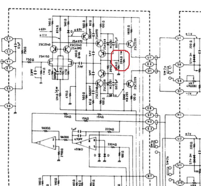

I thought the amp powered up but with a DC offset and thus the speaker relay (DC offset protection) cutting in? Is that not correct :)
Lets start again from the beginning. The first check is always to confirm the main DC rails are present. That means checking the minus and plus 55 volts (it looks like on the diagram) that supply the front end stages and also that the supplies to the output stage are correct.
I can mark those points on the diagram.
Engineer mode ;) The 39k's are high wattage parts stood off the PCB because they get very hot. If one is cool then it points to a problem in that area, either the resistor itself or the components it feeds. Its a quick check that needs no test equipment apart from a finger.
I would need the amp in front of me to advise on how to access it all but I would imagine it all comes apart fairly easily.
Administrator
Joined 2007
Look at this resistor. One end goes to the positive supply at the top, the other end goes via a transistor base/emitter junction and low value resistor to the negative supply at the bottom.
So without knowing the component id on the board we can still check the supplies by seeing what the voltages are on those resistors. At least one of the pair per channel should have something like +55 and -55 volts (very approximately) as measured from chassis to each leg.

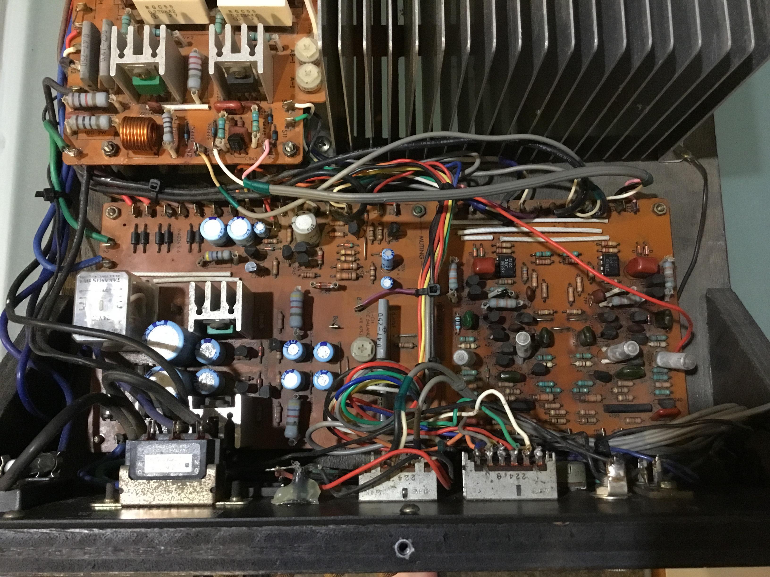

(Sorry...) FORGOT TO ATTACH THESE PHOTOS...
Relating to questions around removing the board or not?
(It's an old wooden chassis, so not like modern, modular amps...)

Hard to say. The boards look like they would come free up to a point (undo the nuts visible). Does that rear panel come loose? That could be a way to get more access.
The boards have that look of running hot about them (discoloured PCB) and that suggests there will be poor soldered joints around hot running components. Typically the joint cracks over time.
Ideally you should gather as much information as possible by careful voltage checks before doing anything though.

Measuring resistance in circuit often gives misleading results because of interaction with other components that appear in parallel with the part you are trying to measure. Even reversing the meter leads can give two totally different results because the polarity of the meters test voltage bias the semiconductors in different ways depending on polarity.
We always measure across the component for resistance, not from chassis to the part and never with any power supplied to the circuit. Residual voltage in any capacitors, even if only a few tens of millivolts can also affect readings.
As I mentioned before, the exceptions are reading low value resistors where often you can get a fairly reliable result in circuit.
If the protection circuit kicks in then the amp is powering up (my definition of powering up). Not powering up means totally dead ;)
Checking power supplies is the first thing to do in any fault finding exercise. We have to know if the supplies to the amplifier are correct before we can go on to determine if the voltage measurements we take within the amplifier circuitry are valid.

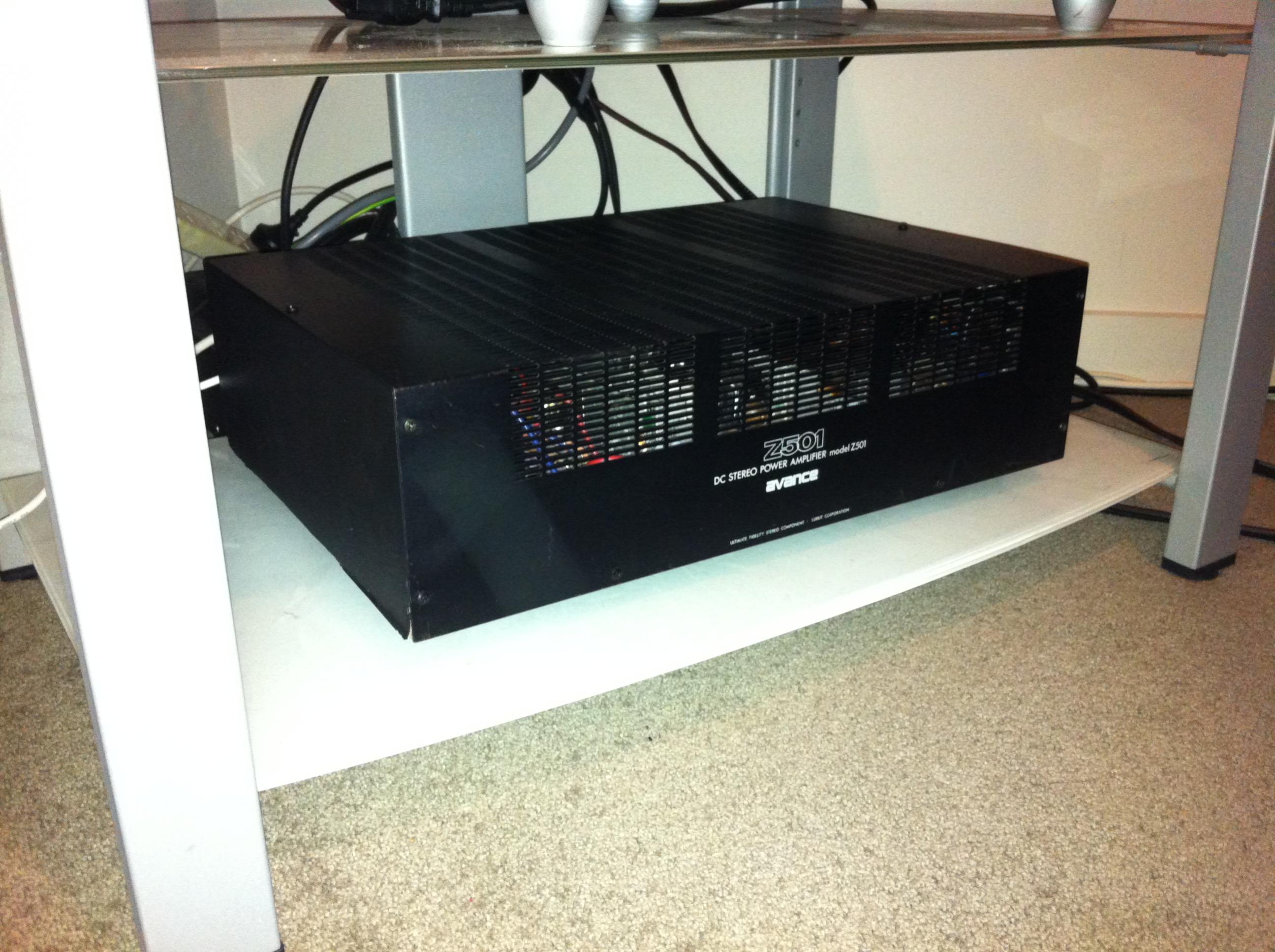

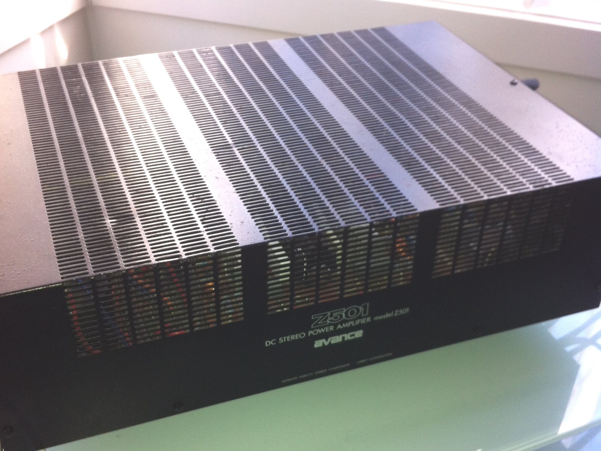

Age of Amp: Circa 1981!!!
PITBUL
Sorry I missed your question below.
This amp is from around 1981. It looks like it has never been re-capped, but none of the caps look damaged or cooked...
MOOLY
Maybe you are right about the hot running, but this amp has never run very hot for me.
I believe the discoloured boards are not from (over)hot running, but from the fact that this amp sat in someone's (dry) garage for decades - and the open-vent style cover (see pic) allowed years of grunge to accumulate on the circuit boards.
I've been busy cleaning it off.
Stinks a bit, particularly when it is powered up!
(Before this problem emerged...)

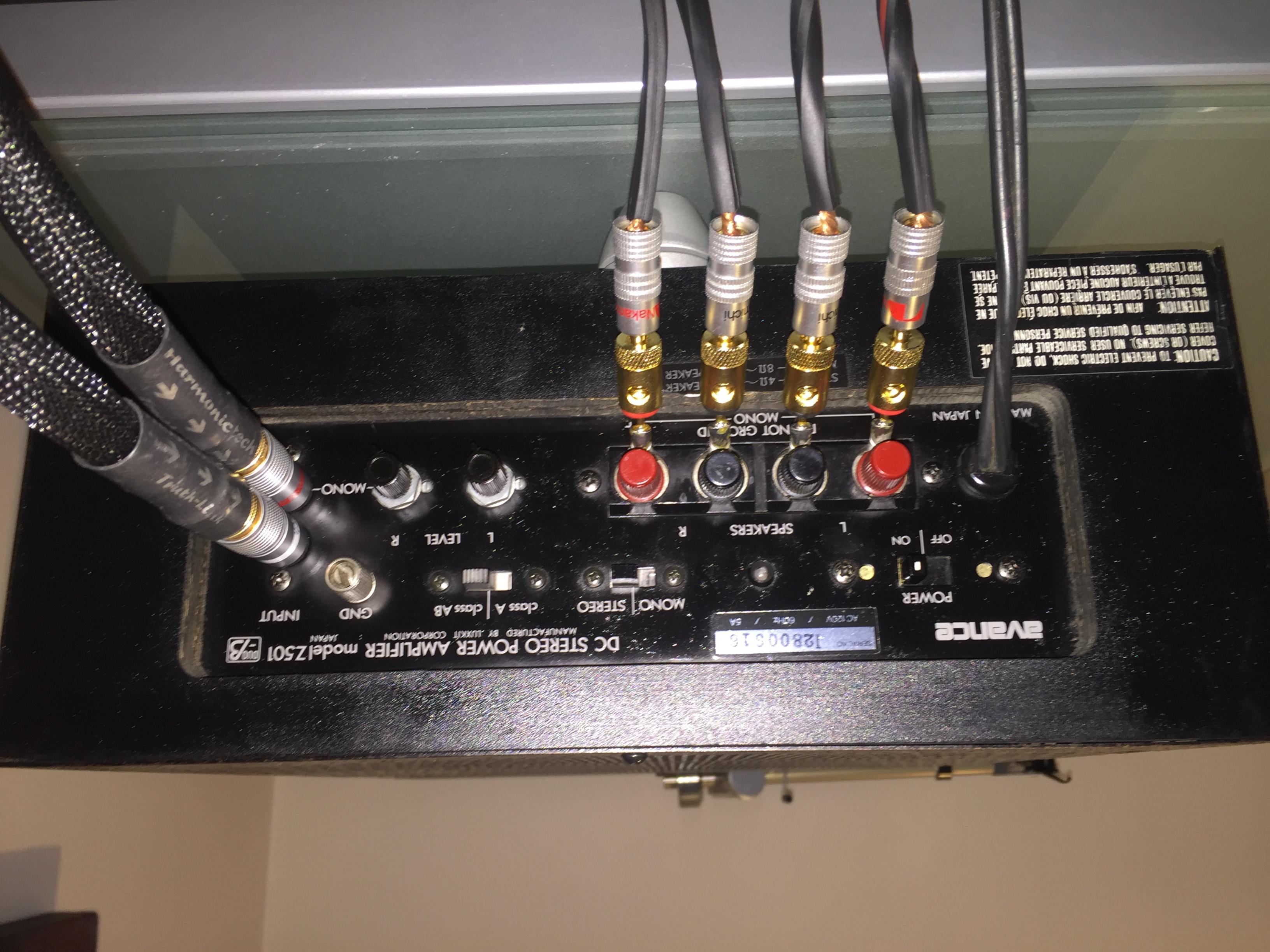

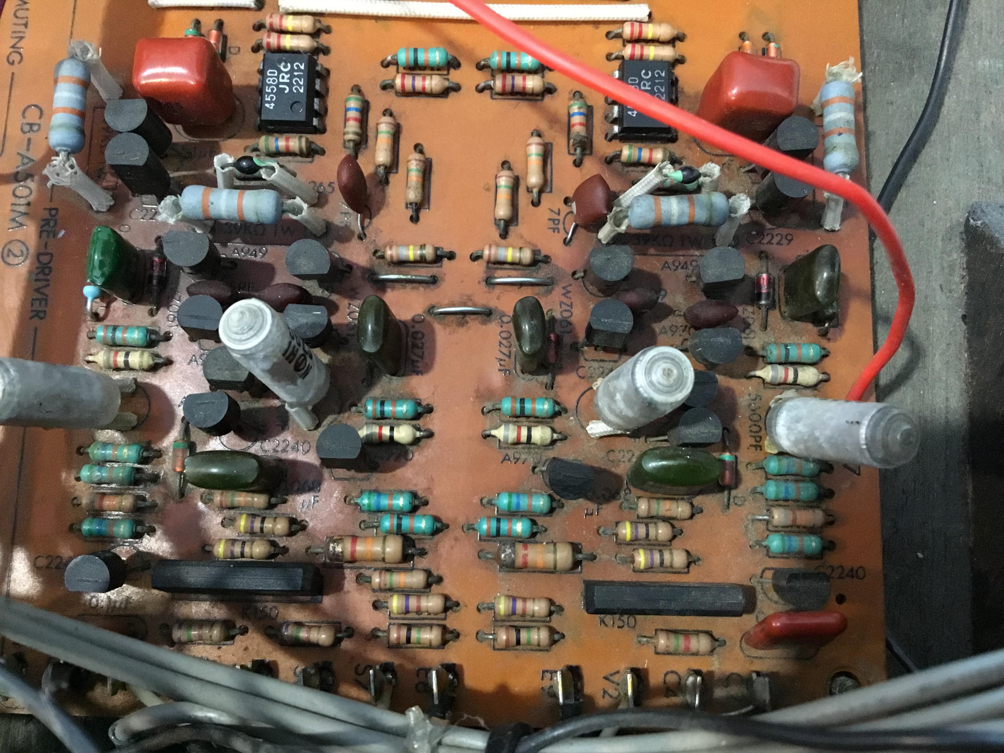

CONDUCTIVE CIRCUIT BOARD GRUNGE???
MOOLY
I have attached another photo, because I don't think the boards are quite as grimey as they appear in your last pic.
As you say, there's nothing like having the amp in your hands, before your very eyes!
I have tried what you have suggested. No reading. So, the grime has not got so bad that it is creating shorts.
I suspected this would be the case as I have had this amp successfully running previously - for months and months - in its current state.
Nevertheless, there is no way I would leave the boards uncleaned, if I was to take them out and tackle the caps and resistors project mentioned to PITBUL below.
I've read some pretty good threads on circuit board cleaning. I'm a believer!

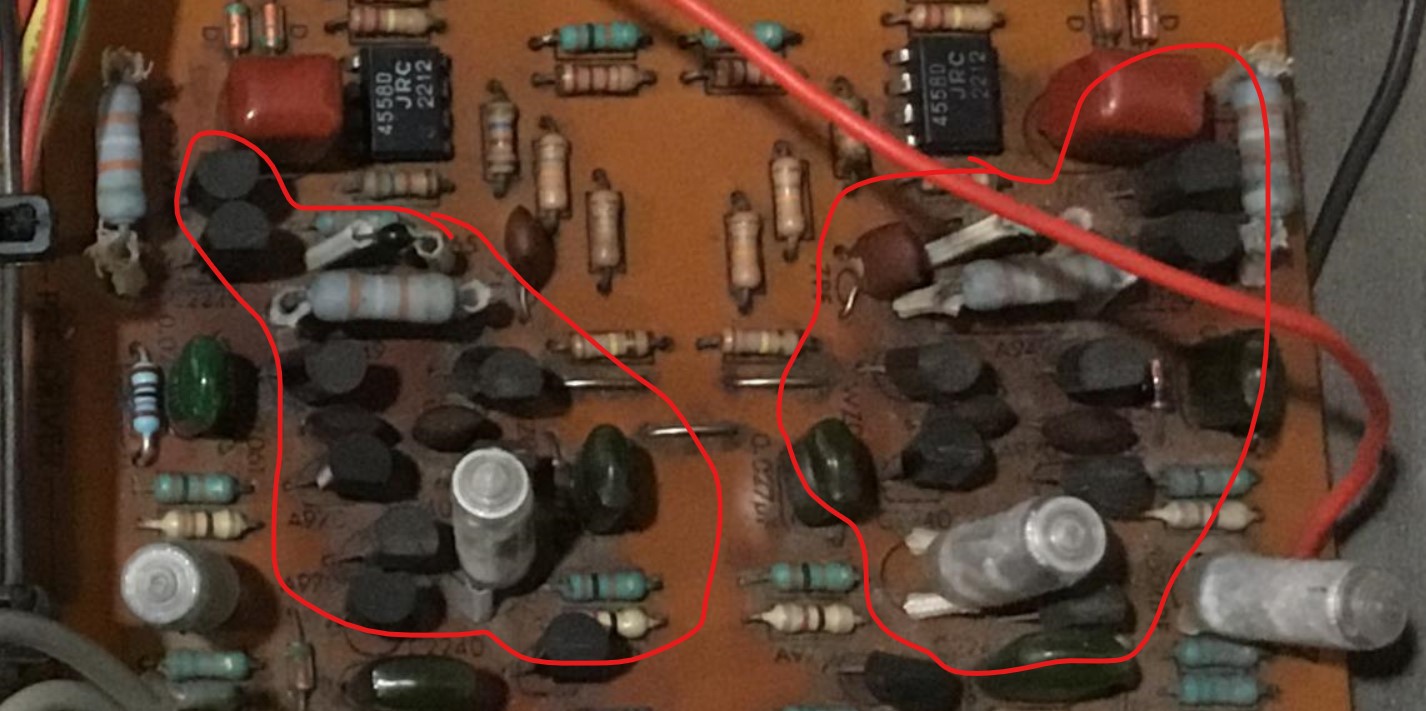

REPLACE 4558D OPAMP FIRST!
First I suggested to replace 4558, I suspected that it is damaged because of bad filtration caused by old capacitors.
Other types of caps should be ok.
PITBUL
These items appear to be about 50-cents each, so does it make sense to replace both 4558D OPAMPS that appear on the same board?
Secondly, if I replaced the 4558D OPAMP in the (problematic) RIGHT CHANNEL only, wouldn't the suspect old capacitors damage the new OPAMP again?
In summary, whilst I would like to be able to replace one part and figure out who the culprit was, I don't think it will be efficient to replace just one part at a time. At least that's my thinking.
(I welcome your expertise here...)
If I shall do repairing I'll replace only 4558 in bad channel, check if it is working, after that I'll buy capacitor from reputable source and manufacturer and replace those on the power supply section/control board. I'll leave big capacitors for amp section.
In the future if there are some dissapoitment in the sound, or measured values on the supply amp rails, I'll change the big caps. That's my philosophy, so adopt yours in this case.

The 4558 opamp… I would be very surprised if there were an issue there :) but a simple check would just be to deliberately short pin 7 to ground. The opamp is short circuit proof and doing this would effectively remove the opamps correction voltage from the equation. The main amp should then function normally but without the active DC offset correction. In other words there would be a normal (less than 100mv say) DC offset.

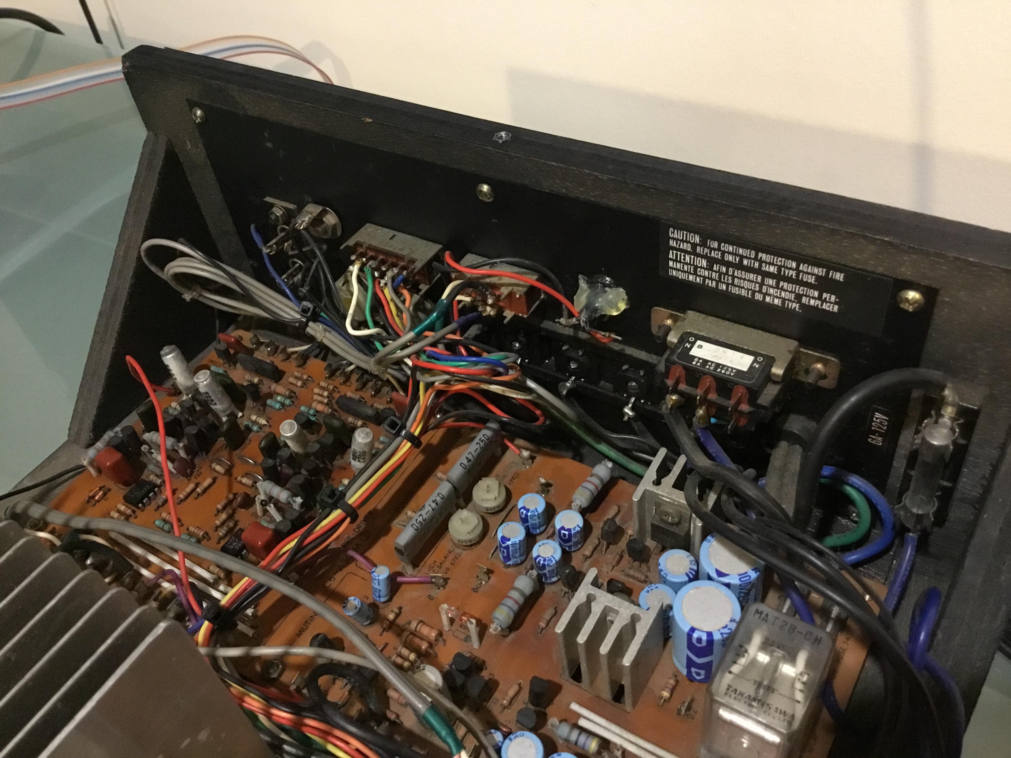

Okay, got it!
Thanks PITBUL. Understood.
I guess for me, the extent and plan for this repair project is determined by the difficulty in accessing the underside of the Power Supply board.
Because I'm a newby - and because this is not a modern amp in a modular enclosure - this access appears to be quite difficult. (By my newby estimation...)
Probably what I will do, is try gaining working access to the underside of the Power Supply board first, thus assessing the level of difficulty. If it's out in 10-minutes, then I will follow your plan. Easy.
If gaining good working access to the underside of the Power Supply board is a drawn-out affair - whereby half the amp needs to be dismantled - I will probably have a go at more than just the potentially faulty RIGHT CHANNEL 4558D OPAMP.
Another two considerations - here at the bottom of the world - is that shipping anything is very costly; and it takes 3-weeks to a month for any small overseas package to arrive. So it makes sense to combine multiple parts orders from one supplier. Both of these factors certainly favour a bigger project.
I agree that I would limit work to the Power Supply board first and test thereafter. The Amplification Board is in a separate area and appears to be a lot easier to get out, if additional Capacitor or Resistor changes are needed after testing.
