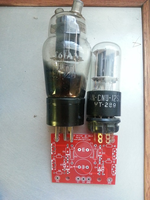

I got a bunch of VT61A HF triodes a while back - very old WWII surplus. These are a cute-as Mickey Mouse tube used as finals in the radio sets in Spitfire aircraft. Who could resist? Closest data I could get was RK34 which is electrically identical, different base.
So the plan is for a 'sl7 LTP buffered by Pete's clever little circuit and swinging the required 100v p-p into the VT61A driving it as close to AB2 as I can get without sounding horrific.
OPTs are probably going to be Edcor 15w open frame jobs with power coming from Edcor as well. Optional OPTs are some nice vintage NOS 8k:8 units built to go into high end local EL84 pp designs.

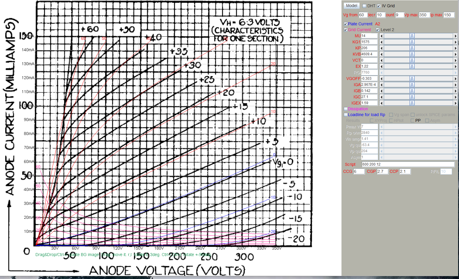

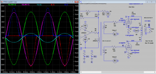

Here LTSpice model for VT61A I painted, not terribly accurate, but doable, grid current included.

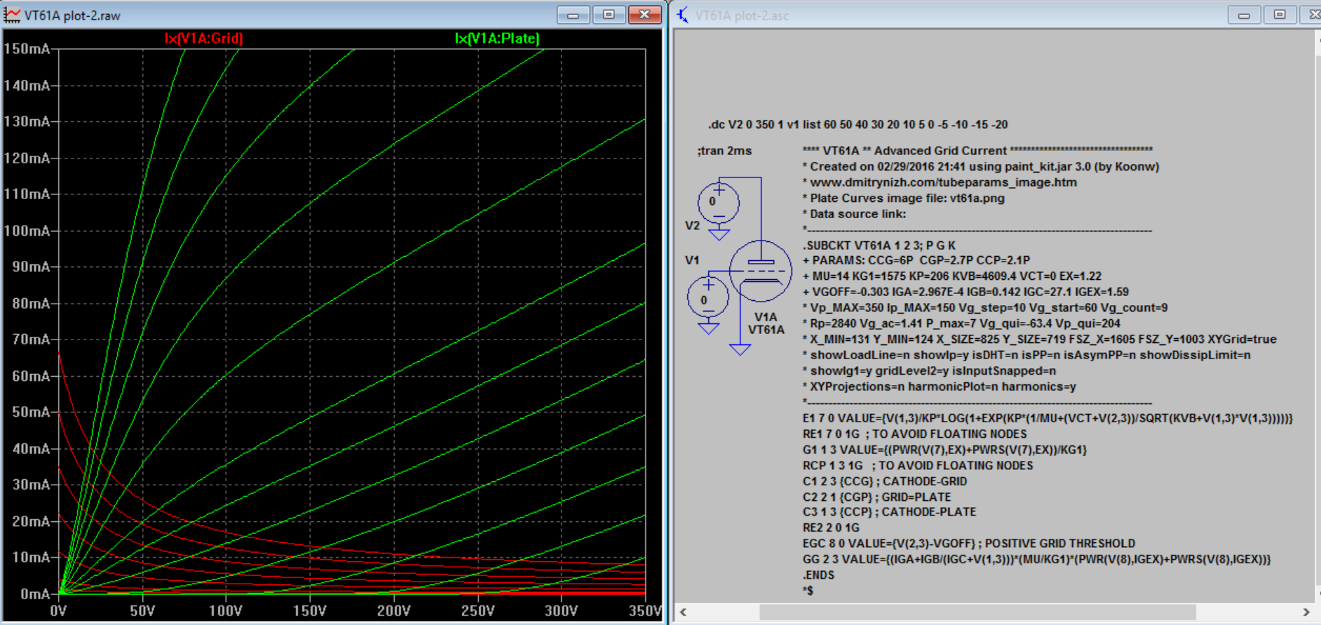

Because grid current is not on the same plot, I have to readjust it here is more accurate model.

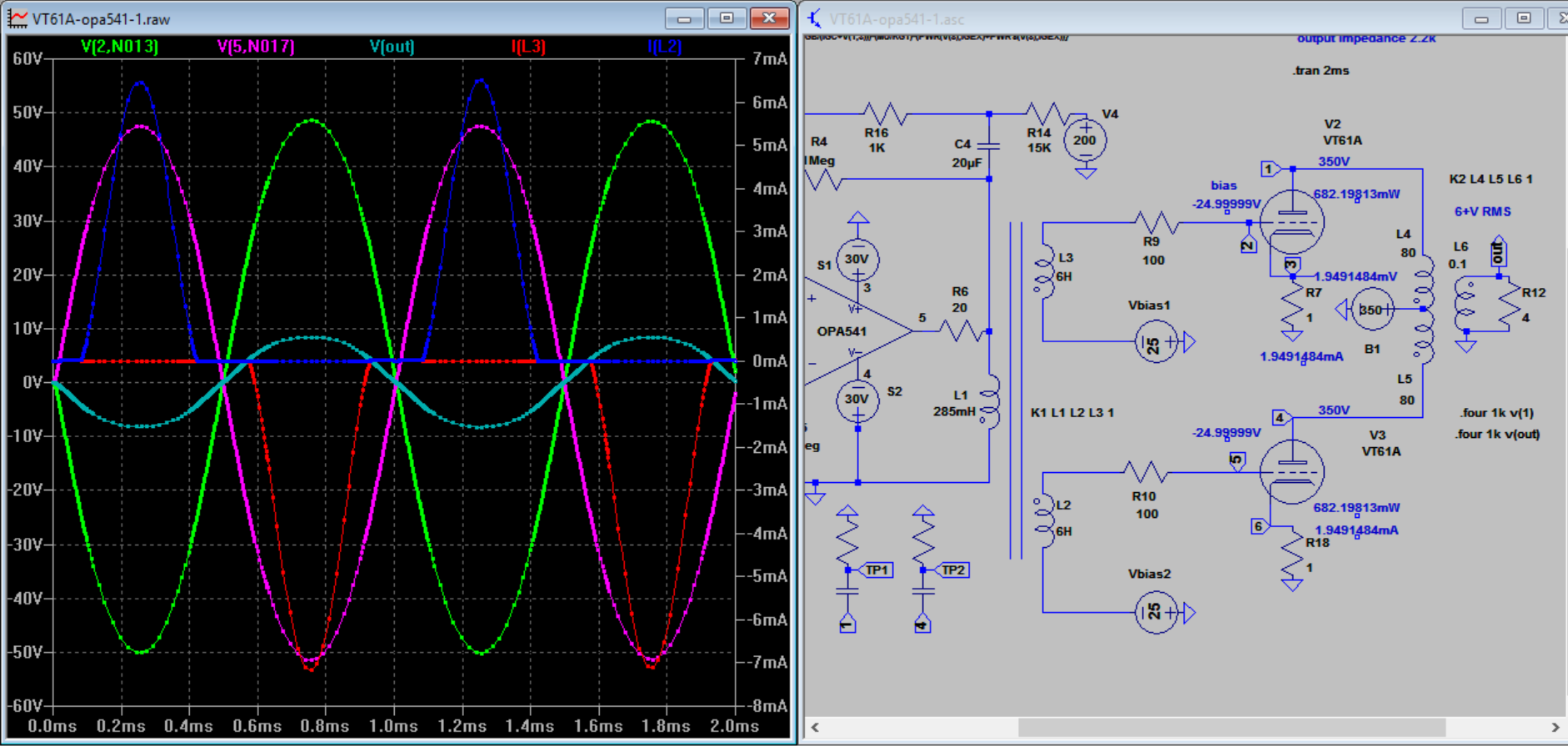

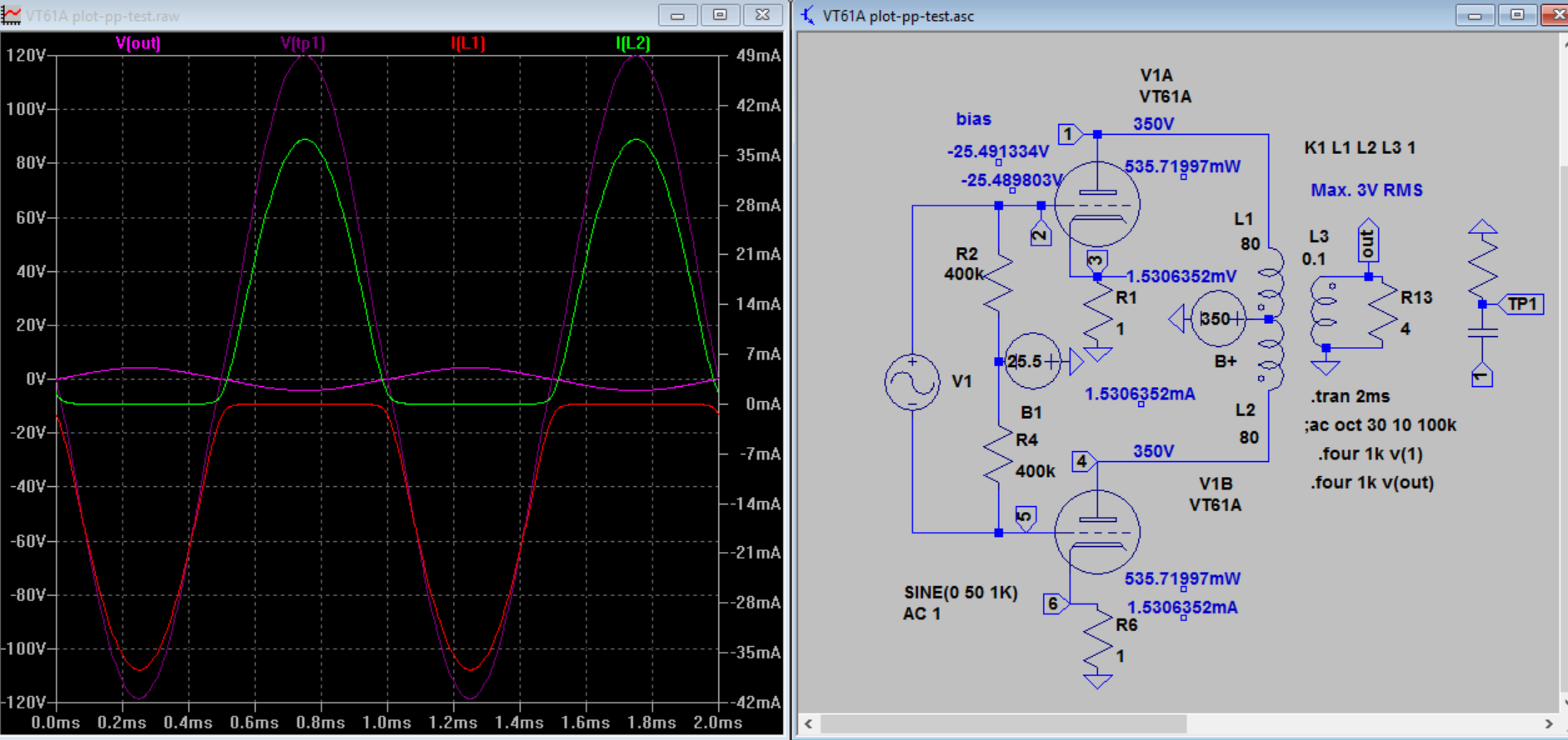

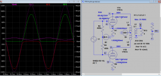

I haven't yet sim a driver that drive the grid positive. It appears the input impedance is around 3K above zero, if input drive is 25V, this is over 8mA grid current. At -25V bias, with 25V input, there is no crossover distortion seen at the output only just over 2W rms.

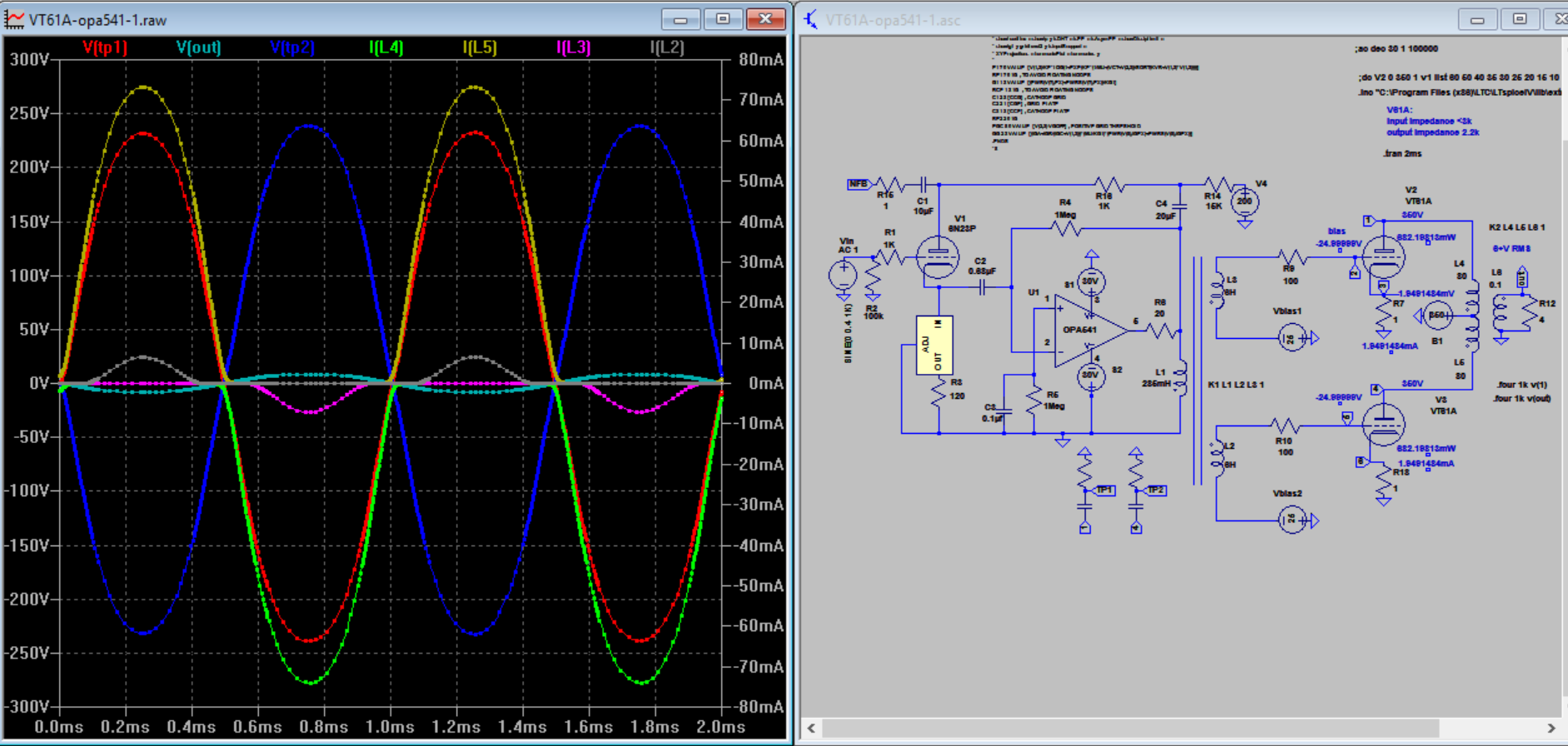

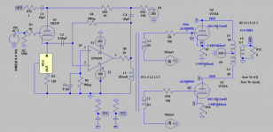

Oh yes, I remember now I sim OpAmp before, it's IT driven A2, so I just plug in and the output has increased to almost 10W (from previous 2W). The driver on left is a version of SuperTriode now standalone, then again can be tied to plate of output if we build 2 independent drivers. How to direct couple the driver without an IT?

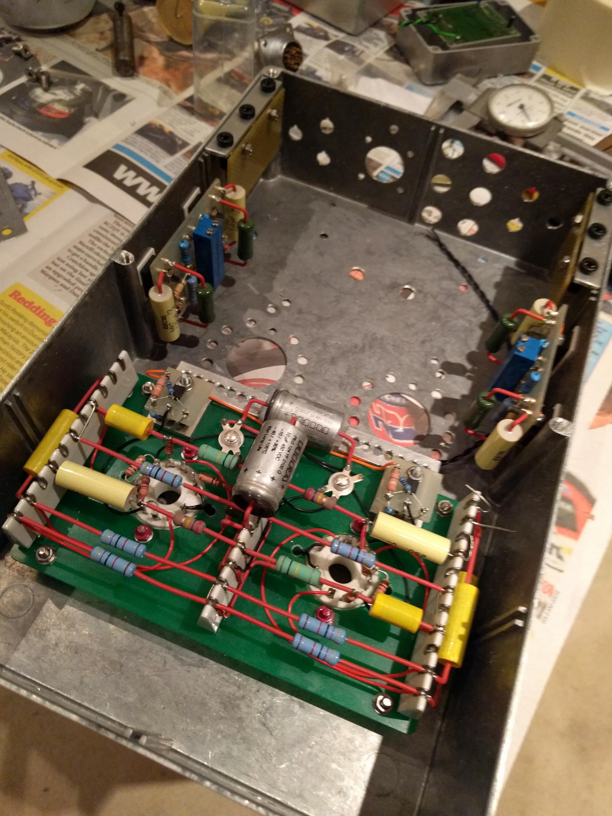

Funnily enough I am building just such an amp at the moment. I have used Petes compactron triple triode design and also his fet follower design both slightly modified to meet my needs. The outputs are a 2C34 on a different base. I wont say its name as it is rather rare but it seems identical to 2C34. on the breadboard I used some 8K Toei transformers and it sounded great with no crossover distortion at all.
Cheers
Matt

Just to be clear, the buffer boards I've got coming from Pete are CCS loaded MOSFETS (as exeric notes), not op-amps as I linked at the top of this page.
