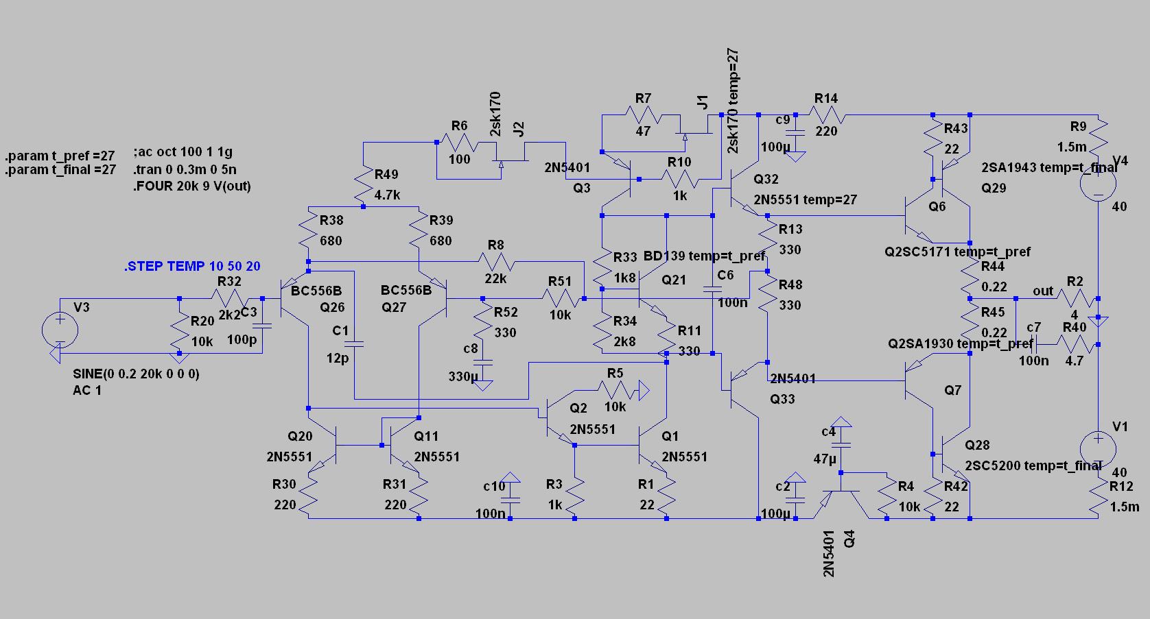

Here is my bjt models+transient ltspice sim .
Dadod ,my model of temperature compensation bjt was corupted .Is fixed now .
Jay ,I will post a version of no current mirror for you .I am also adept to simplier things .By removing the current mirror and the ef before vas we can put a miller cap of a half from what is now ,6pf .
What I don't like in that version is the dc offsets with the temperature though the olg at 20khz is almost the same with one with current mirror so we can achieve almost the same thd at 20khz .

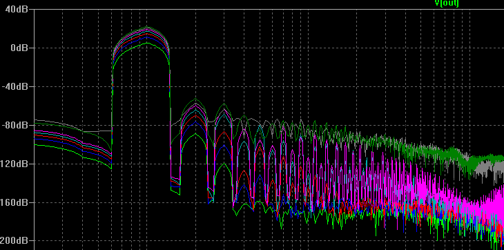

Hi Catalin, thanks.
I would say that the FFT of your first circuit is equal with P3A, except that your circuit running much higher bias current, and one special characteristics of the P3A is the beautiful distortion profile.
I haven't check the AC analysis of your circuit, but P3A is wonderful there.
The second circuit is interestingly good, especially very good for low SPL listening. The THD for high SPL is very bad tho.
I think I will use both P3A and your circuit to benchmark my SSA-CFP.

ADD: Or may be you're asking the joy_sin.asc, the one with current mirror.
Why do you say that the thd is very bad for high spl ?
Sorry, I used to see amp behavior from the very first seconds the signal is applied. It is probably not valid to say so, but whatever, I like to see a homogenous FFT for input signal from 0.1 to 0.7 at short stop time:
Yes Jay ,Thank you .The resistive load version is modded from the current mirror for your interest .I will continue for the moment with the current mirror version but if you are interested we can improve also the resistive one decreasing the emittor ltp if you are a "searcher for best thd" .But doing this the miller cap must be increased which I don't prefer .
As I said my interest is for the first 1-10watts ,enough in a 20-30 mp room .
More than this can't be detected related to thd . Also I prefer exactly the sound of the one with current mirror and small current feedback .
I see that the R21 resistor which is setting the current of the ltp is 560 ohms by my hurry .It should be 220ohms to have almost 3 mA in Ltp

Q16+R23 is creating a current source for the collector load of Q16 .So the current in load will be the same always and independent by the load value .So even if we increase the load the ef will do the same job .
One of reasons is that in transient mode the maximum current in Q16 and also Q6 (if we don't have R22) will be more than the maximum acceptable of the transistors beacuse the current is not limited in Q16.
In this case the ef will be distroyed .
But if we introduce R22 we introduce a current limit through Q16 of about = (V-) / R22 ~4mA .So the current limit is about 4mA but the current through ef will be decided by the 1kohm resistor from emitter of Q16 .Threfore the current is ~0.8mA .Now from the loadR22 point of view we have a constant current source (0.8mA) + current limitter (4mA) .
The key here is to calculate the resistor to have a voltage drop less than (rail voltage - ) - 3volts .Vce is varying from 30Volts only with maximum +/-0.3Volt so there are no issues .The constant current is helping a lot .
Now the second reason but for me is more important than the first one is that the AC transfer function is better with R greater .By doing this we move the dominant pole to a higher frequency which means that we can decrease the miller cap .This is one of the reasons why this amp is stable with 12pF and reach more than 100V/us SR .
Temperature and supply independent .
A major flaw to these topologies is the psrr .
Psrr was bad to the negative rail so I improved with capacitance multiplier circuit .
Another major flaw of the audio amps is that the idle current varies with current from the vas which varies with temperature.
Now from -10 to +60 degrees Celsius the vas current varies only with 10uA .

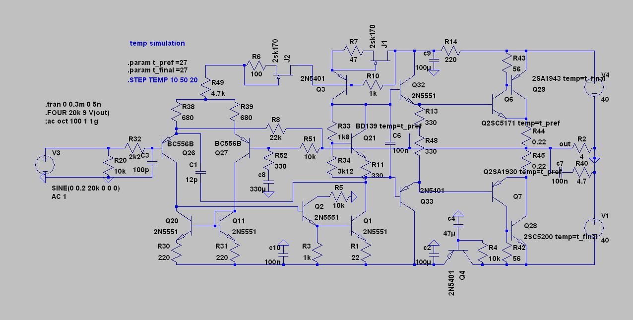

The thd figures are better than previous .At 20khz from 1Watt to 100W thd <0.003% by keeping the same SR >100V/us
Joy version 5
@Jay: Hello Jay ,can you do the same simulation for all the power levels like before ?
Idle current should be 20-22mA through 0.22 ohms resistors.
Also the library is attached .
Thank you !
We can take also the negative feedback from the common point of the 330 ohms resistors if we want this ,thd will increase in this way from 0.002 to 0.02 % but the output will be a pure buffer . I want to build a pcb layout with this version v5 .
By this I will have a lot of options like a cfb amp,vfb amp and a output stage which is not in the feedback loop .
Also I want to have 2 pcb's separated ,one for the voltage gain and the other for the current gain(output stage) .

Getting better thd figures with 22 ohms resistor in drivers 5171,1930 .
And also the imd figures are very low .
The current through drivers is now 20 mA and thd at 20khz with 9 harmonics at 1 to 3 watts is 0.0005 % .No tmc or other kind .
The joy here is that the final stage is biased only with 10mA -12mA .
And the version without negative feedback (nofb) over the final stage has only 0.01% thd at 20khz .

22r & 20mA gives an output Vbe of 440mV.
Is that correct? This seems far too low. I would expect 550mVbe to 600mVbe, giving a driver bias current range of approximately 25mA to 27mA
10mA to 12mA of output bias must be excluding the driver current.
The total current bias through the emitter resistor must be: driver bias + driver base current + output bias, i.e. approximately 35mA to 40mA.
Is that correct?
